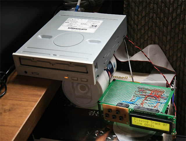

Finally I made it..
Many thanks to roly3055 and everyone..
Here is the photo of it... It uses used LG CD-ROM(52x)
(I bought it in flea market for $5!!!)
Right now, there is no chasis for it....
I plan to order a decent chassis for it.
Howeve, there is a small bug in the firmware..
Ocassionally, it doesn't go to next song after a song ends..
it goes back to first song.... Maybe some bug in firmware..
Unfortunately, I don't know assembly programming..
Please sombody help me out~!

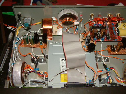

Here is my implementation. Acer CDrom in a case of an old Technics Cd player, directly coupled with a modified DAC-AH (passive out). PSUs with LM78xx regs, Nichicon caps, 4 transformers, 5 separate power supplies. MUR860 diodes, some heatsinks ...
CDRom is supported on 4 rubber mounts.
