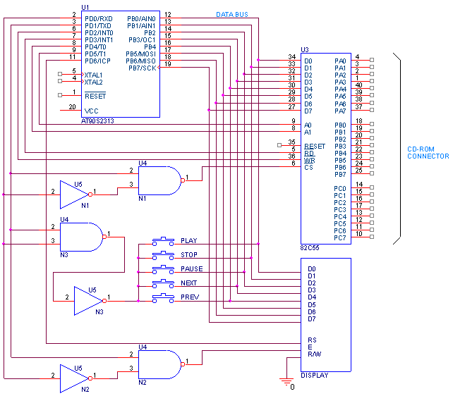

are we possibly missing the point?..... PC based cd players and so on........there are so many such projects... a microcontroller based cdrom is what i think the original issue of the discussion was.... ok... do the ìC guys out there think a atmel at90s2313 would be sufficient, just to spin the disc & basic functions? (2k flash memory)... the pins could suffice, using a 82c55 chip, as follows...
probably full of errors schematicc...:rolleyes: :rolleyes: :(

Konnichiwa,
The original discussion was to replace the discontinued Philips CD-Engines with generic CD-ROM Drives.
I for one do not give flying french coitus how it is done, but using the S/P-DIF output from the Drive will only work with serious external jitter rejection and the SYNCRONOUS Redbook CD-Replay error correction may be fair at best, with chances that the mechanism aimed at other purposes will actually cause a lot more errors in that mode than a even a cheap dedicated CD-Player.
One way that is "low tech" in the implementation is using in effect a PC, as this put's all the "High tech" design work (Mother Board, Interfaces etc.) in the hand of large global metanational concerncs with suitable resources.
The other optiuon is to do the job ourselves, devising auP/DSP platfrom that will asyncronously read the CD and re-read as many times as possible without violating the minimum data rate (even so - EAC usually runs at >> 1 Speed on my PC on the worst condition CD's) and buffer the data with a view of having it clocked out by an external clock.
