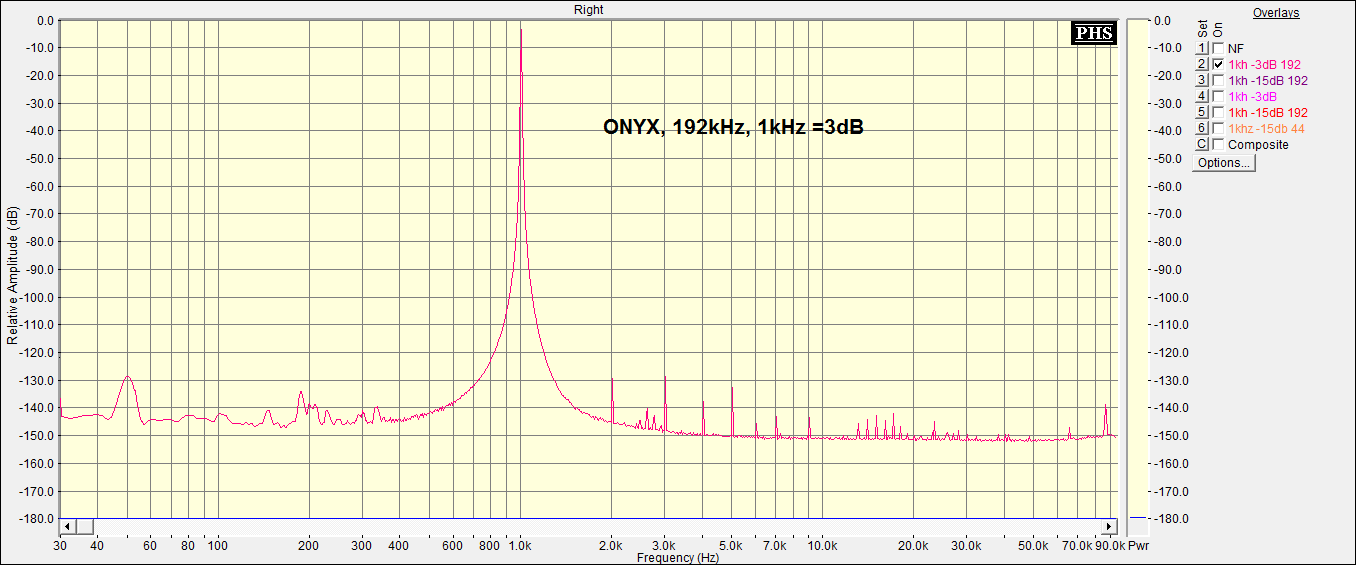

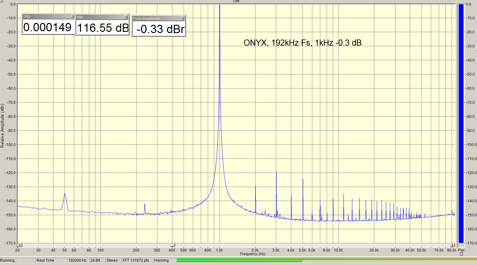

Mmmmm, you remember my measurements?

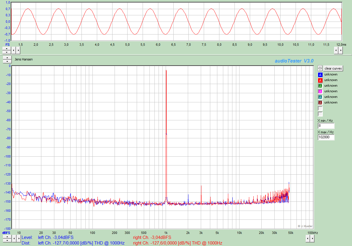

I just made a measurement, where I sent out -13.5dBFS to the DAC to get -3dBFS on the ADC. Measured with a sample rate of 96 kHz.
  • 1kHz distortion_96ksps_-13.5dBFS out from AK4490_input 3V range_512k FFT_average over 10_prototy.png

With a 1V balanced output from the generator (-20dBFS) looped back to the analyzer, I have measured a THD of just below -130dB average over the 18 units that have been built so far.
The worst measurement in this test was -127.8dB. The best one was -133.7dB.
This was measured at a sample rate of 48 kHz.
If only one input channel is used the distortion seems to drop by 1 or 2 dB.
