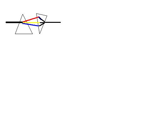

David,
Yes, you do need two prisms to work and they must be of different difraction characteristics that work in balance to compress the image without breaking the light into its component parts. The large prism is water and the smaller one oil.
Exactly!
You need to make two prisms with the peak-angles 24° for the oilprism and 30° for the waterprism. The peak-angle is the angle of the two paces of the prism.
And they then have to be mounted with specific angles relative to each other. This drawing describes what angles they are mounted relative to a vertical line. The oilprism should be mounted at an angle of 3,2° and the waterprism should be mounted at an angle of 31° relative to the vertical line.
In this illustration the projector is table-mounted on the left side of the prisms and the light goes from left to right. For a ceiling mounted projector it should be upside-down.
