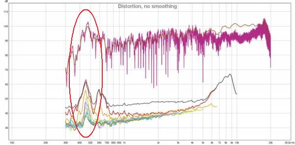

I have measured 4 amt´s. All measured in same conditions .1 meter distance, 2,9volt, on axis.

Hi båndsei
Very interesting, both to see the freq response but als the dist figures.
No 3 has by far teh best dist figures, and also very good low end.
But why is ther a clear resonance at around 450 Hz .... all are OB measurements ... right?
Also the distortin raise from 5 kHz in all measurements ... is theis due to some limitations in the measurement setup/sw?

I don't see a clear resonance.Witch model?
I see the raise in all my Measurements of AMT's.Have to try with cone or dome speakers.

Resonance at 450 ... could be something rattling .... but it also looks a bit like the low end response of a underdamped closed box behaviour (Qt less than 0.7) ..... but as they are naked .... then that is not the case ... so it must be the nature of low end dipole response, being the relations between the baffle size and the actual driver size .... guess that the magnetstructure is wider than for the others ..... does not matter much if you crossover a lot higher than 450 Hz ....
Electro-acoustic models model A3 .....
I concur with Balwin...if you roll off to your bass driver higher, the 450 gets buried. *G*
