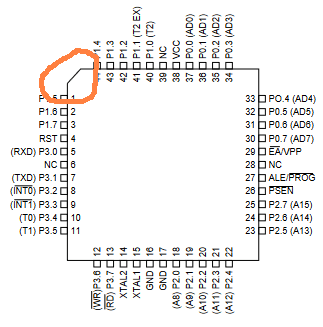

Checked-double checked-triple checked the microprocessor orientation? Not from the label, but the identifying mark on the package.

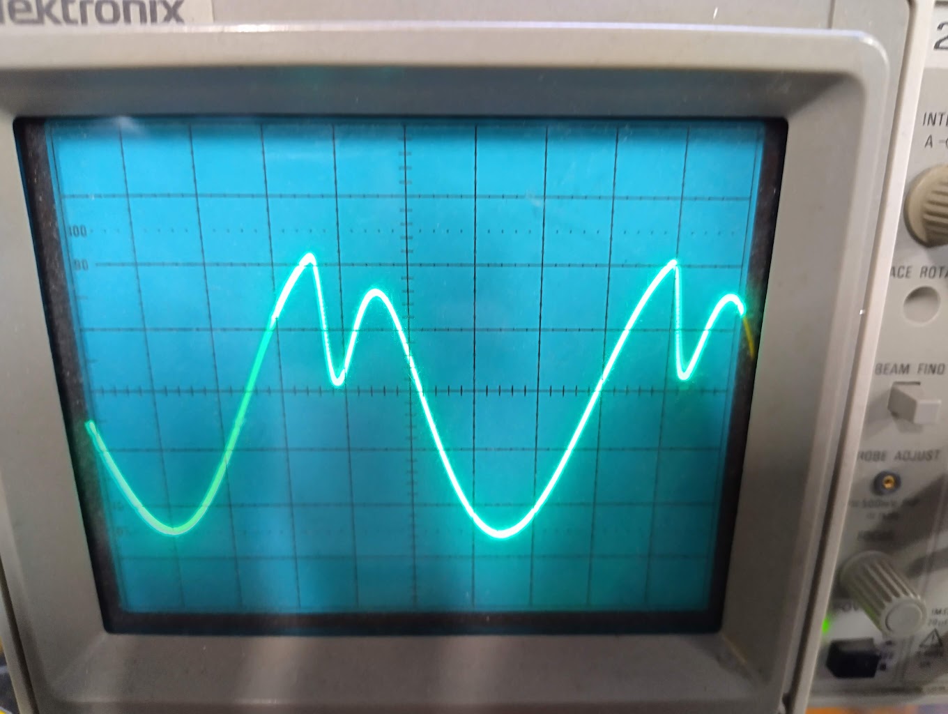

Looks like the output is clipping into an inductive load, can you reduce the amplitude a little and see what the effect is?
Are you using the MA3 amplifier? If so, are you using the BLDC motors recommended?
Its worth also checking the power rails.
The more info you can give us the more help we can provide.
Now I have done some investigation. All works fine if I just adjust ampitude one step from 128 to 127 and all way down to 64. No clipping. So when I put it on it start with the clipping shown above but sets as fast as it loads the current settings. An sec or two. I use a highvoltage probe with a minimum of 1Mohm load, so I think that is not a problem. I also measured direct at the SG4 board. I have now also tried to load it with ampifier and transformers to 110V and all that works just fine. So not a big issue but seams to do some clipping at full voltage 5v p-p and if i just adjust it to any other value exept 128 it works fine.

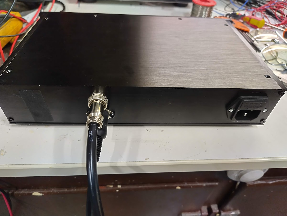

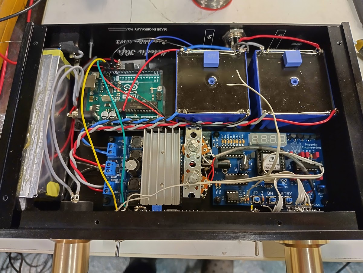

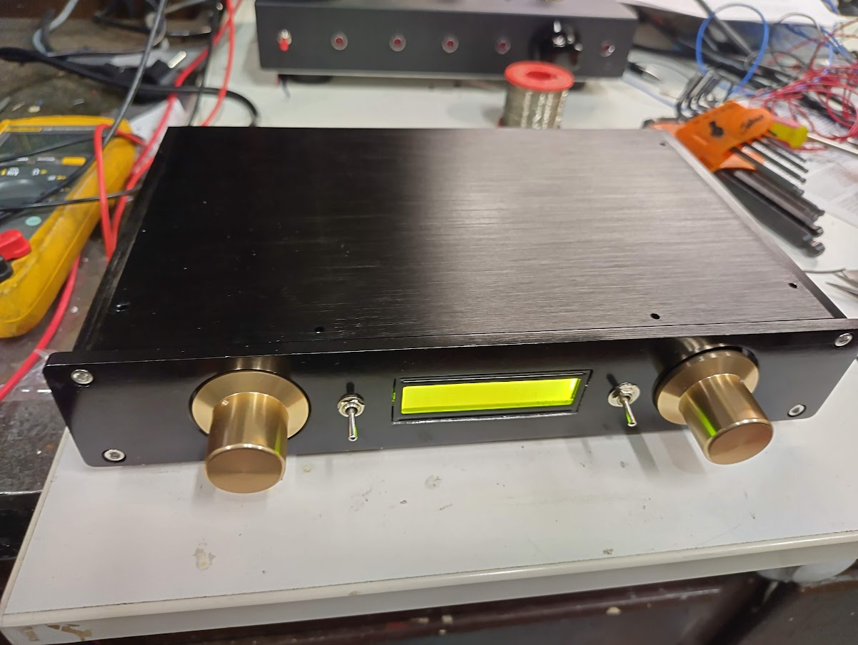

My object is taking chape... I have a homemade turntable with the 110V Premotec motor and wanted to have a nice arrangmenent for it. Its a SG4 and a tachometer built on Arduino. Both charing the same display.
