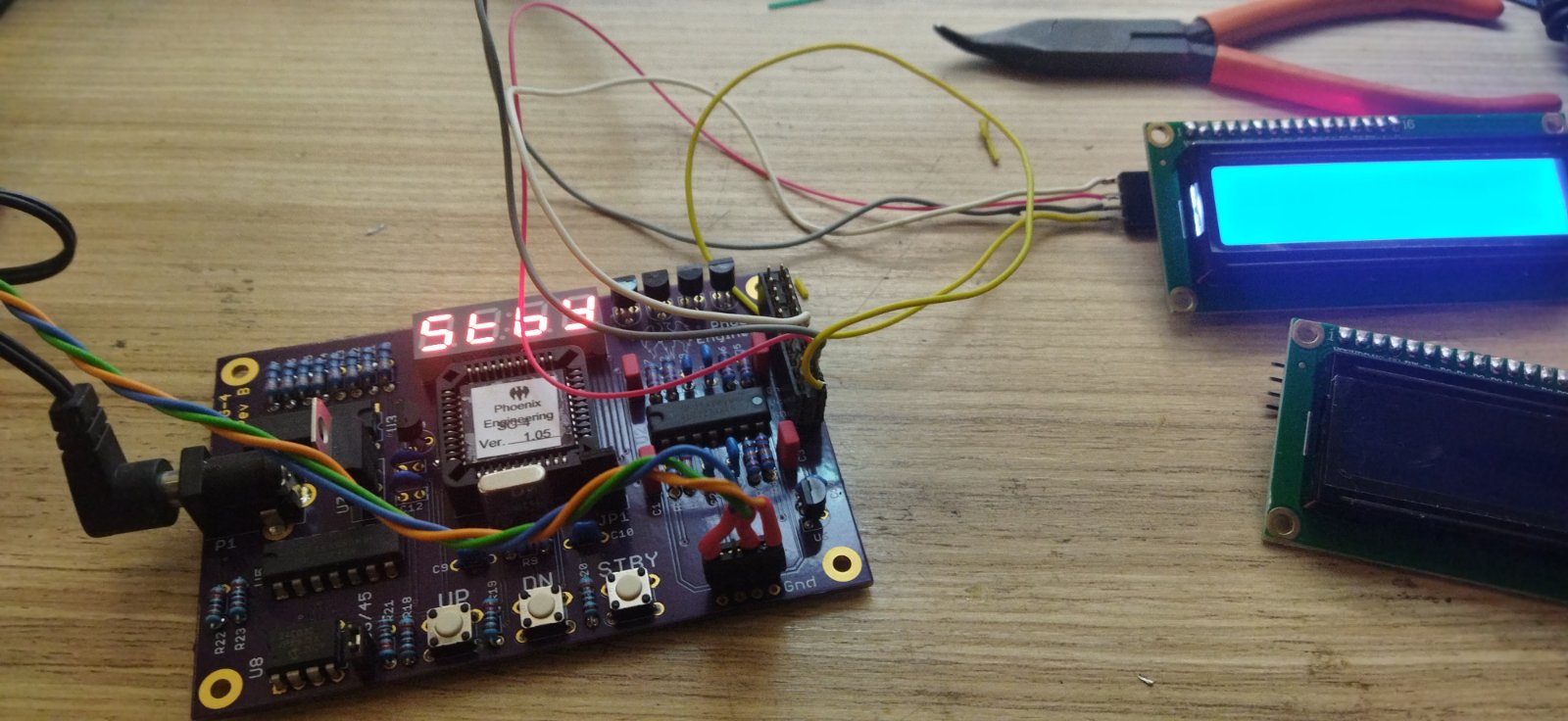

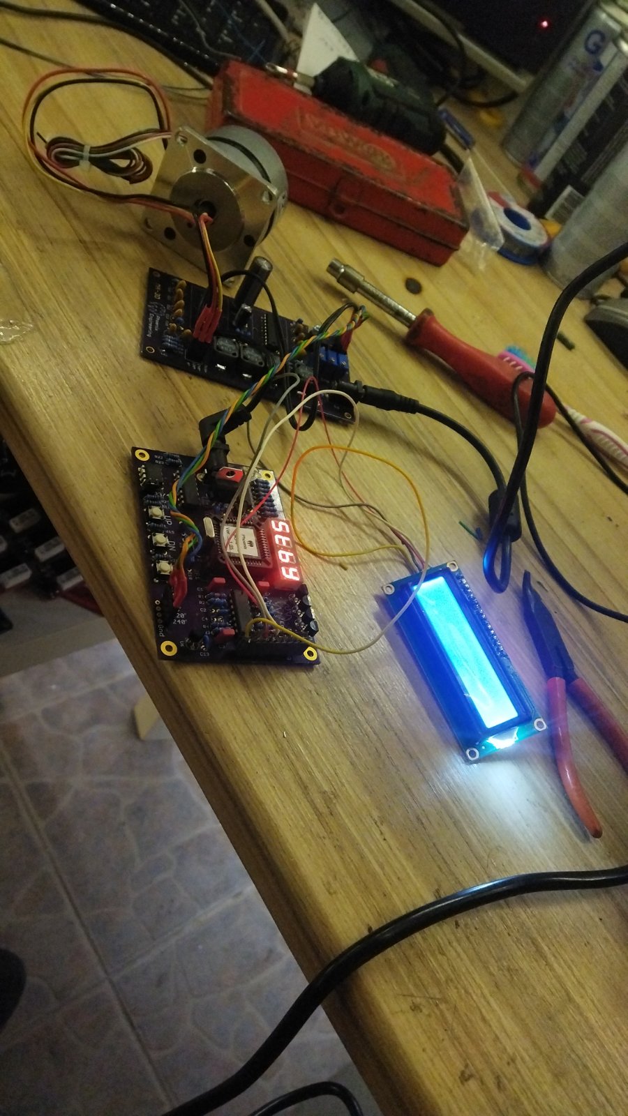

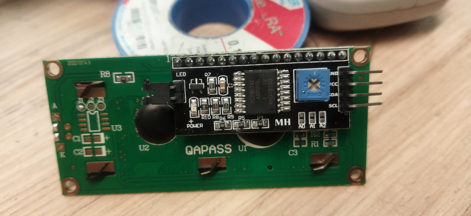

Good morning from GREECE
I have made 4 Phase Sinewave Generator
And the 3 phase class D motor drive amp
Everything works fine except the LCD interface I have the PCF-8574T version,
But I read that with the latest version 1.05 there is no problem
I have also tried the short circuit on tp1
But it doesn't display characters
What am I doing ? error

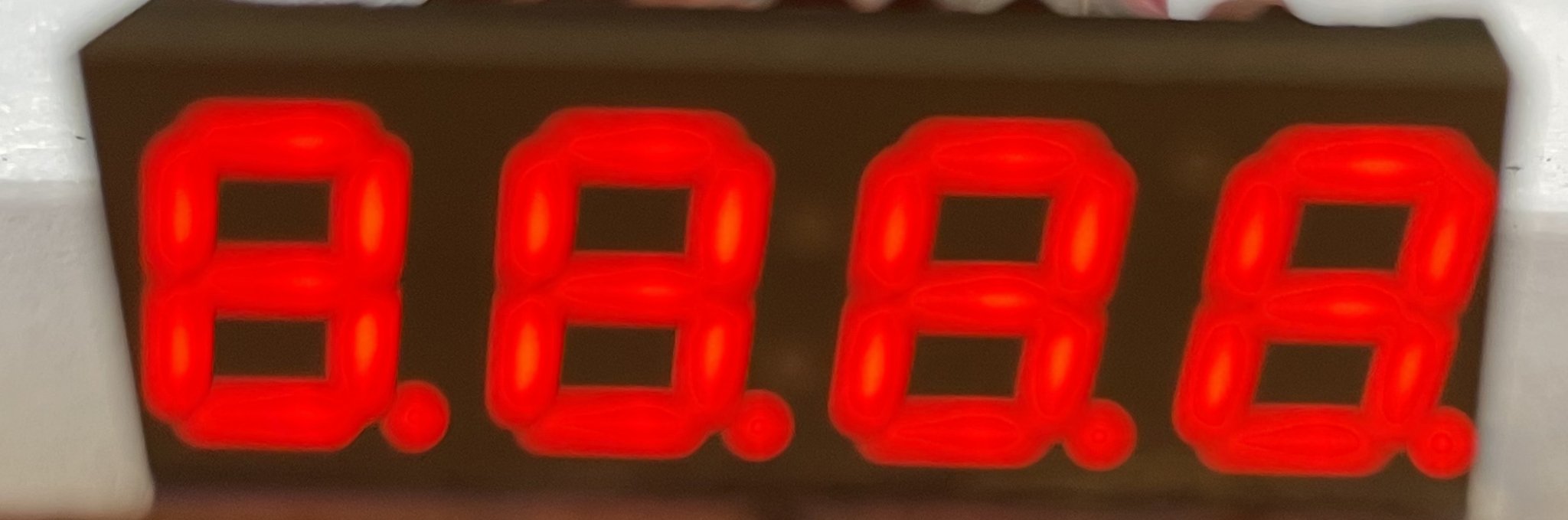

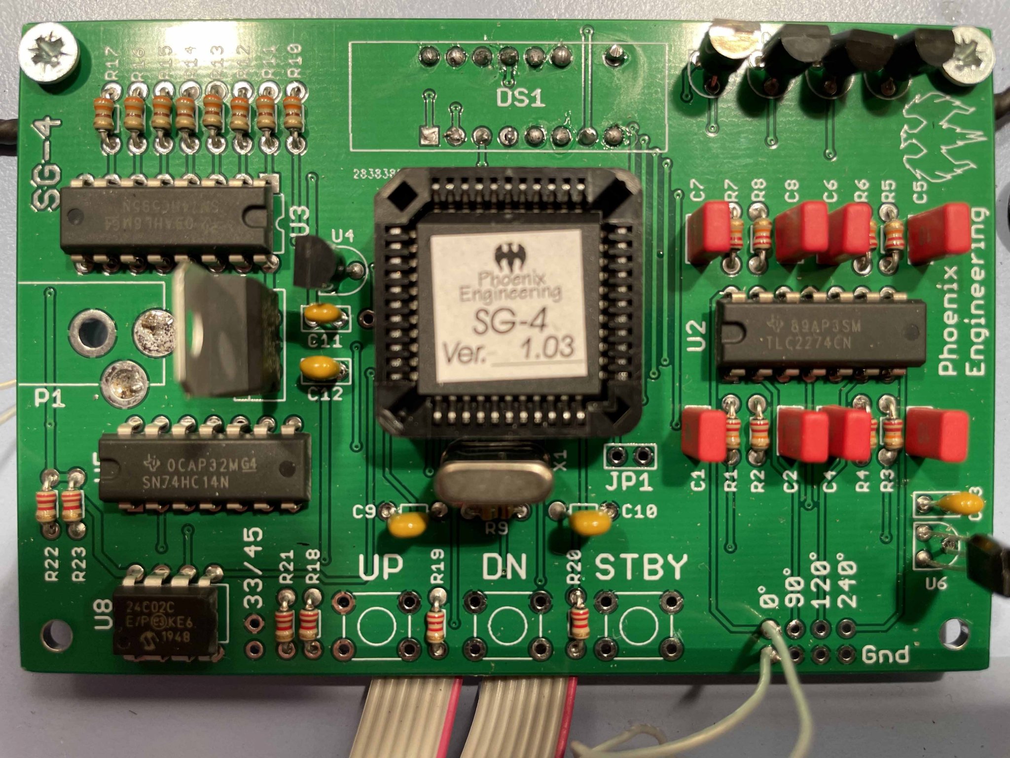

Hi all.
I have 2 pieces of 1.03 SG4 chips which I bought almost 2 years ago.
Now had time to put under assembly another SG4 controller.
My previous experience assembling SG4 was problems free and worked from the first time.
Now I have a problem.
Once I power up the board the lite-on display fully lights with all segments and nothing works. No reaction at all.
Measured everything I could as follows:
U2 - Pin4 - 8volts;
U3 - Pin14 - 5volts
- Pin18 - 5volts
U5 - Pin1 - 5volts
- Pin3 - 1,4volts
- Pin5 - 5volts
- Pin9 -5volts
-Pin11 - 1,4volts
- Pin13 - 1volt
- Pin14 - 5volts
U6 - 8volts
U8 - pin 5,6,8 - 5 volts
I am using DS1833 - 5. The revision of the board is not from the newest. Exchanged the DS1833 with two different ones - the same.
I have a pulsation from the reset on turning the PCB on....So the reset is working.
Another PCB prepared to the same result: all segments of the display are on and no operation possible.
Exchanged the chip with the second one- the same thing.
Exchanged the quartz as well.
What might be the problem?
Is it possible that both SG4 chips are dead? Probably bad batch or something?
Thank you in advance.
Another test performed:
2n7000 transistors exchanged to new ones - no change of the behavior.
Changed again DS1833-5 with another (3rd) one - the same.
The input to U4 is 5VDC and the output going to pin 10 of the uP is 4.75VDC for ~350mS at power up then drops to zero. So this means the DS1833 is working and is sending a reset signal to U1
I am a bit out of ideas what to try next.
And one final test before i lift my hands off this project for now. Back then Pyramid advised a user with a similar problem to remove the DS1833 and to substitute it temporarily with a 47nf or bigger (from Reset to 5v) cap to force the micro-controller to exit "programming" status. Did it. 47nf and then with bigger 100nf capacitor. Both tries gave no result and I am totally desperate now. What are the chances both of the chips to be faulty? They both came together.
I don't have an SG4 setup, but I'd guess to emulate the active-high power-on-reset, you'd want both a cap from VCC to the RESET input, and a bleed resistor from the RESET input to ground.
100nF/1MOhms would give a time constant of 0.1s which should be a good starting point.
