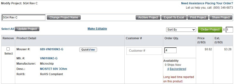

The version specified in the project listing on Mouser is out of stock and shows that it won't be in stock until Feb. 6 2024.
I'm certainly no expert, but are you saying that the -P003 variant (https://www.mouser.com/ProductDetail/Microchip-Technology/VN0106N3-G-P003?qs=Q7eD95YXrua%2Bjseq8E4gMA==) won't work?
Regards.
I'm not certain. That's why I'm asking.

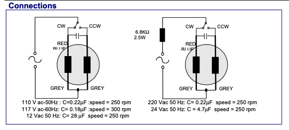

I have a old Rega Motor Premotec 9904series in a highly modified turntable. Its set for 220AC config with the 6,8Kohm series resistor for the 110V motor. When applying a sg4 controller I see no use of this and get rid of the series resistor (and cap for 90deg)to get it run directly at 110V. Is this correct? When applying step up transformer I can use a 110+110v primary to 12+12v secondary 30VA trannie together with suitable amplifier like this link
Do I need 2 transformers for this or is the double secondarys fine, How do I apply this? Any suggestion for transformer?

I'd recommend the amp in the following link or similar. I know it works and am not sure about the one you mentioned.
https://www.amazon.com/gp/product/B082QR5WVL/ref=ppx_yo_dt_b_asin_title_o02_s00?ie=UTF8&psc=1
You can eliminate the resistor and capacitor in your diagram. You'll need 2 110/12 v transformers - one for each phase. 0 degree phase goes to one channel and 90 degree goes to other channel on the amp. output from one amp channel goes to both secondaries of transformer (in parallel). Same for the other channel. Then connect secondaries in parallel to red and grey. Secondaries of other channel go in parallel to blue and grey. I'm doing this from memory, but I think the 0 phase goes to red wire.
I think 10VA is adequate for transformers but I'd use 25VA to be sure. These transformers don't need to be anything special.
