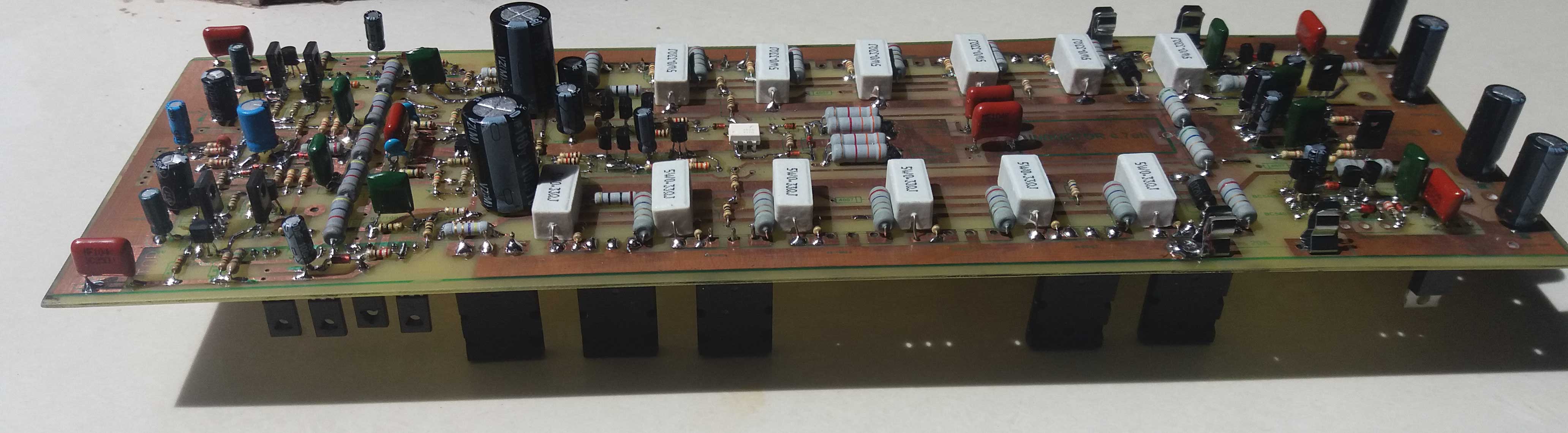

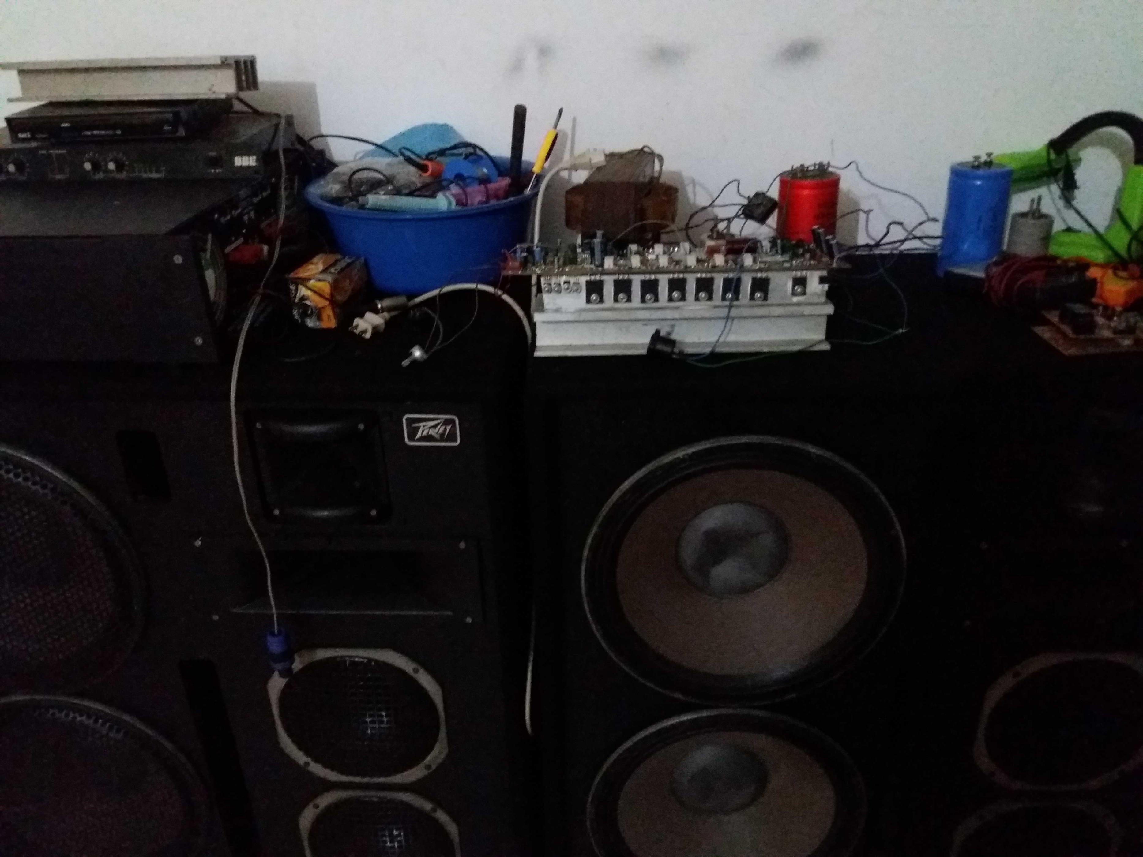

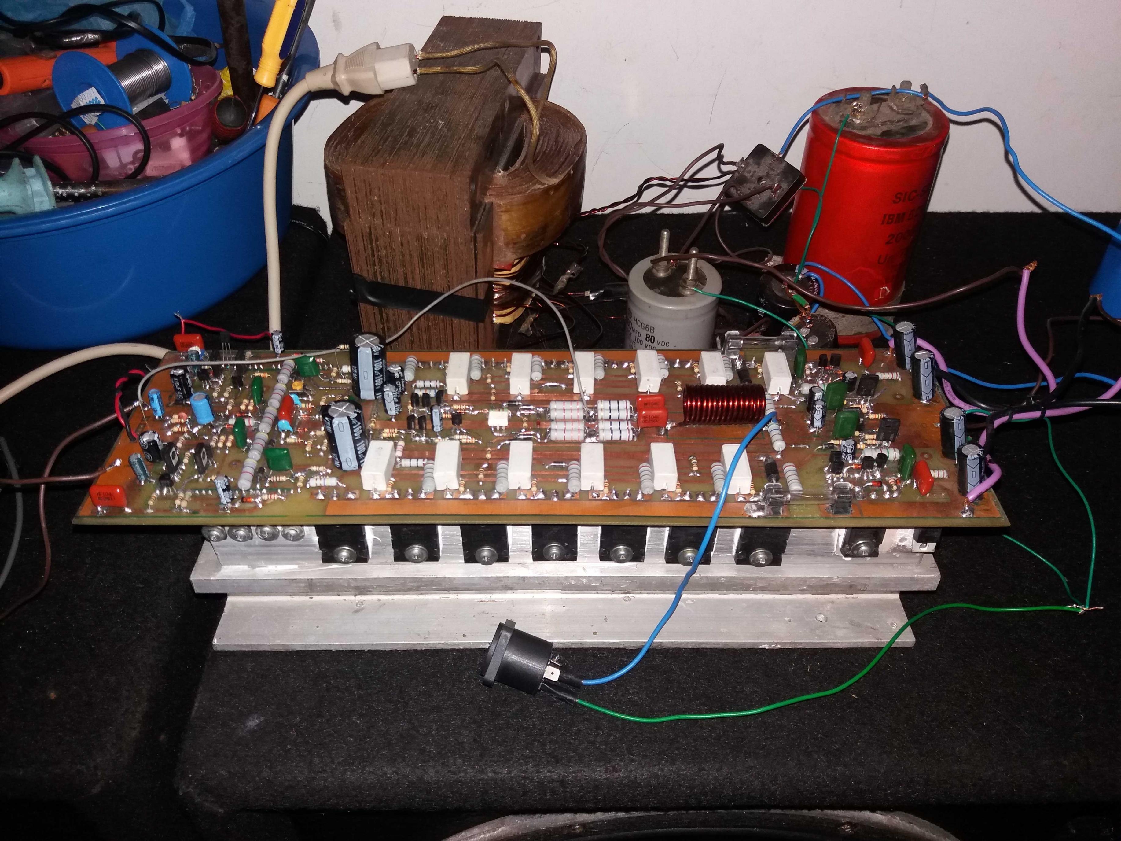

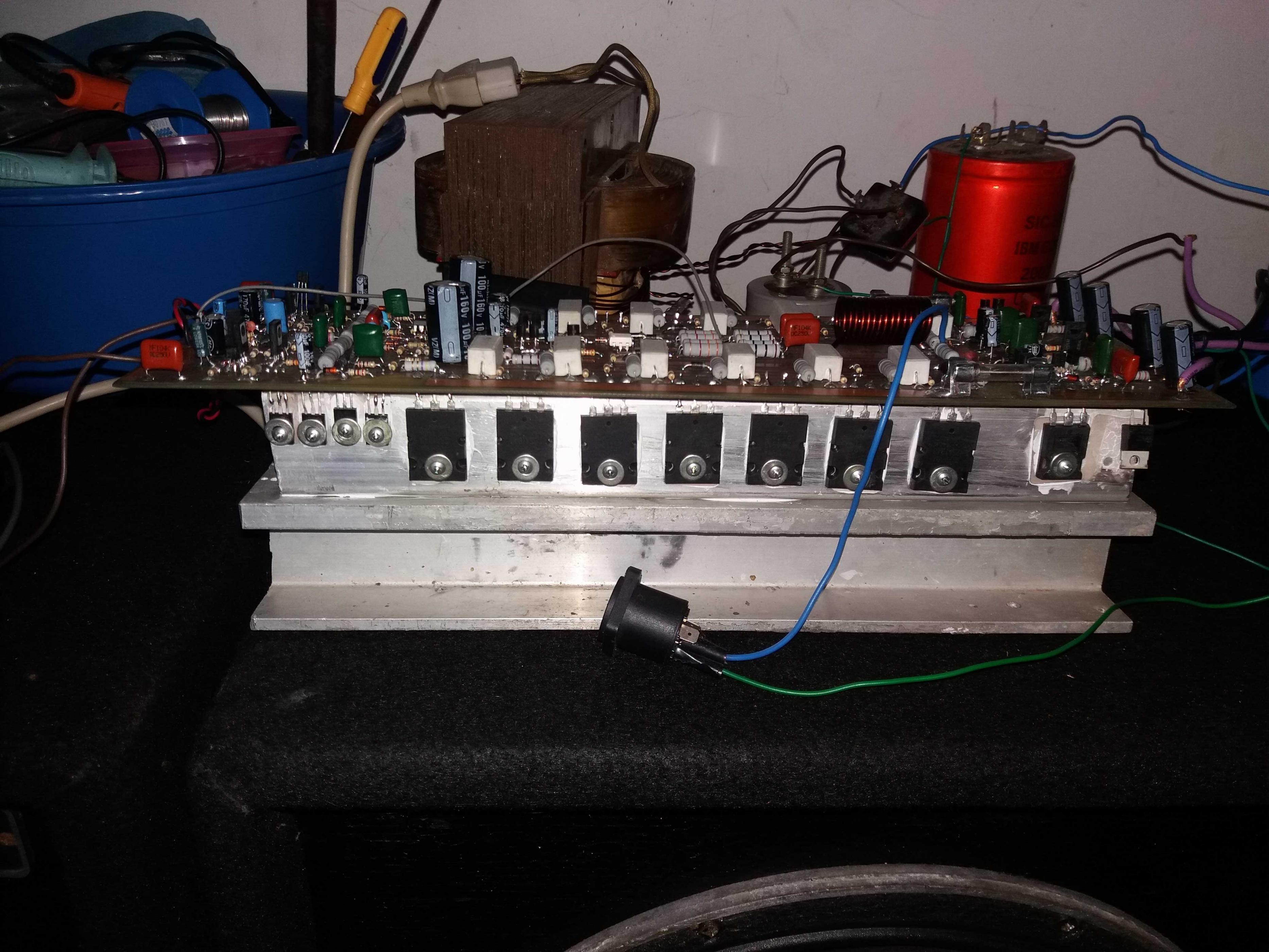

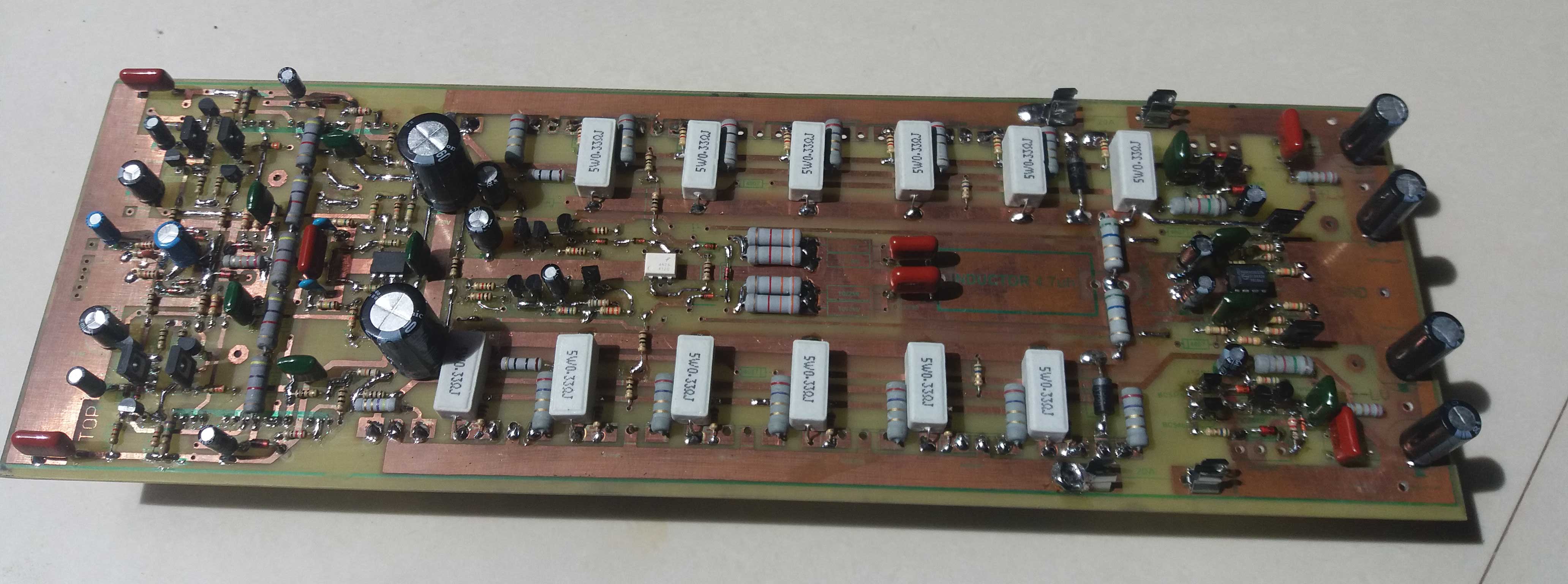

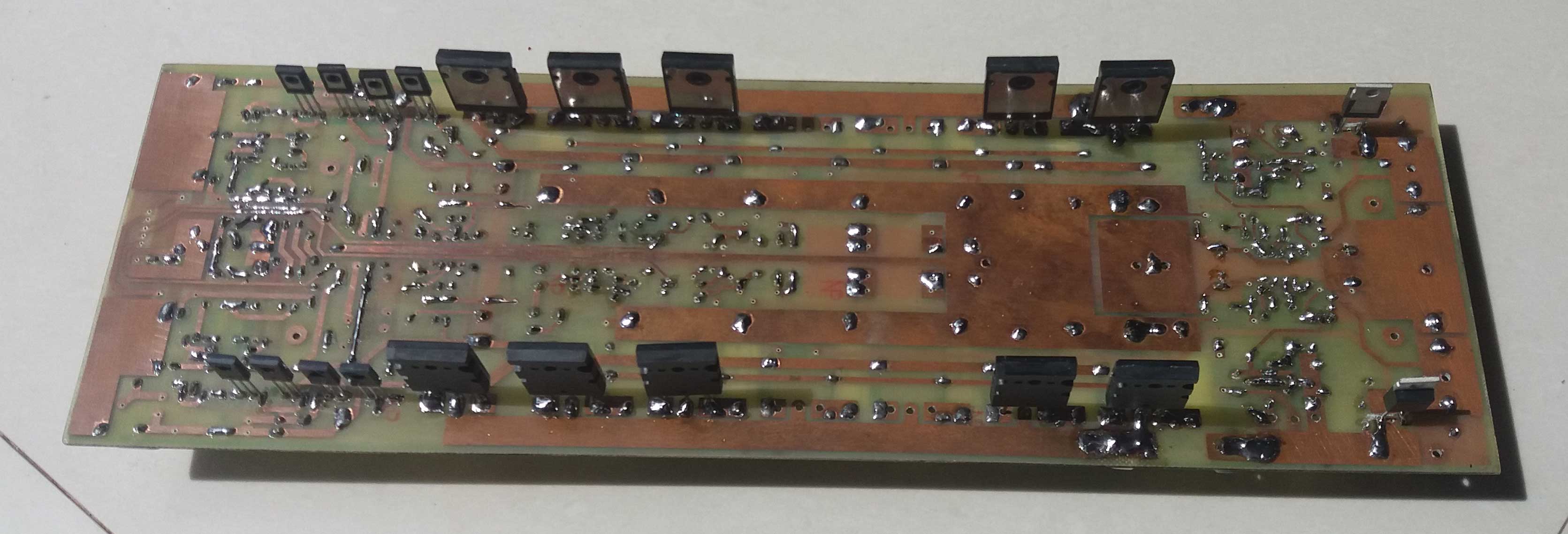

1.5 KW amp

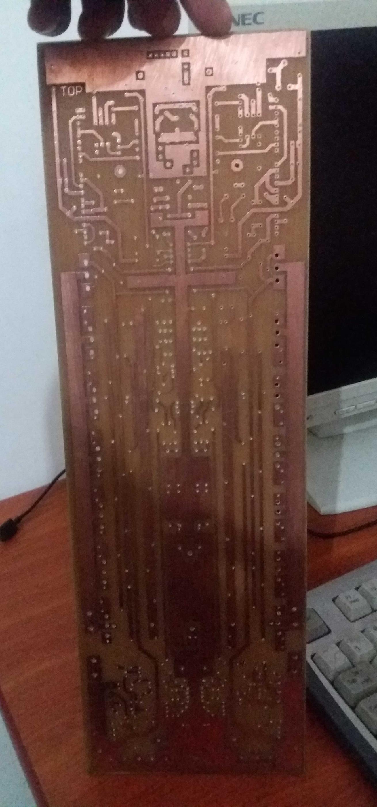

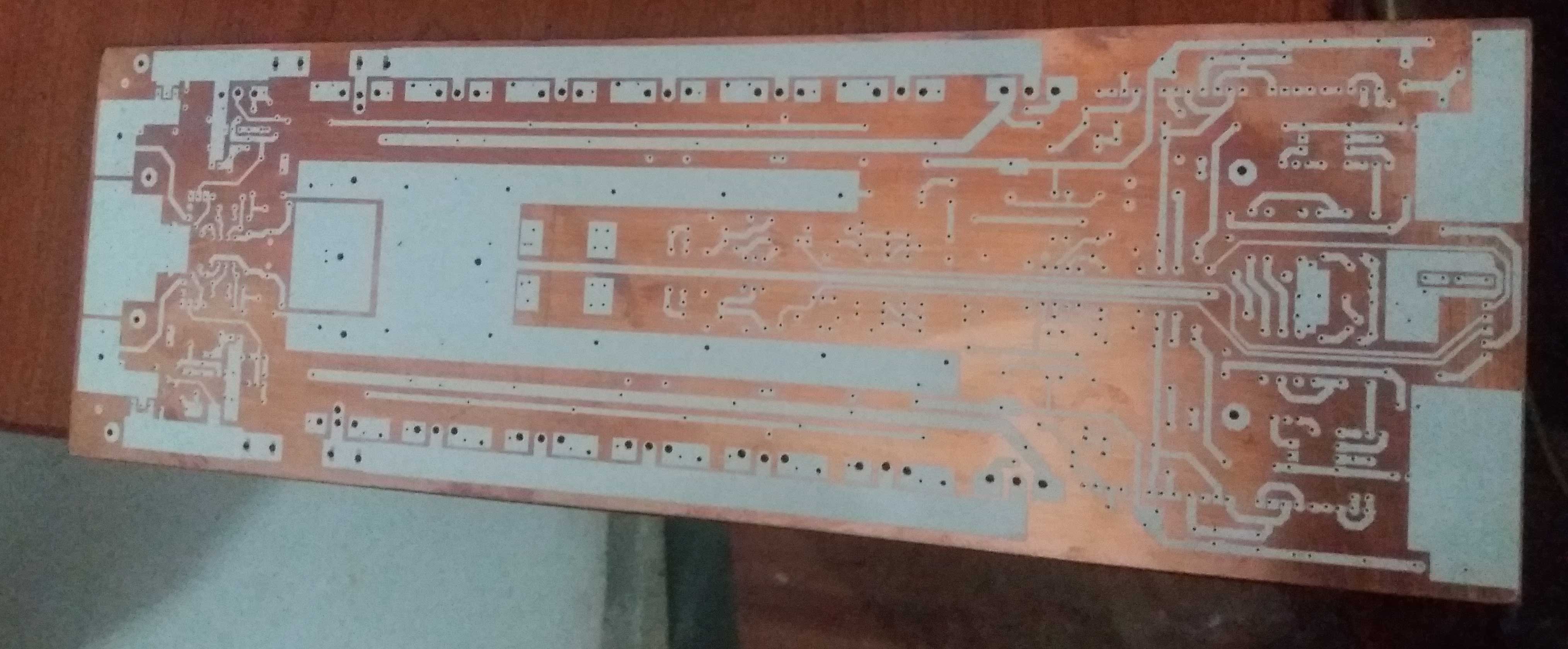

sir, i want to try this if u help me, but with single sided PCB.
So did anyone tried this yet?
I don't have single side PCB version for this.
change value step driver
nice amps... btw,... here already suplay with 56ac and 112ac,.. so any change step driver to use your amps?
warm regards...
You need 2500VA transformer with following winding specs: 85-50-15-0-15-50-85 14A secondary.
This amplifier is has all set of protection like DC Fault, Muting, Shrotcircuit etc.
warm regards...
hello all.
am planing to make this amp. i have a 82-41-0-41-82 with 15v and 19v toroid trafo weighing about 9.5 kg. i want to diy the amp from start to finish. i just need a few issues sorted out.
1 what is the bias voltage?
2 the schematic shows that 1uf4007 in not applicable buh the pcb layouts show it is applicable. may i know the one to follow.
3 can i use mbr20200ct diode in place of stps20sm100s?
4 what equivalent diode can i use in place of bas21 because in my country its not there.
5 of all the zener diodes on the schematic only 1n4744 is there in my country. i believe these are one watt editions. xan i use 500mw editions coz these are here?
sorry for many questions i just want to be sure when making that am fed with expert advice.
