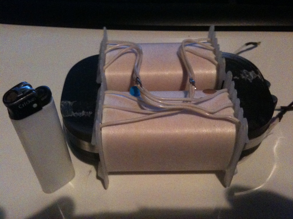

sorry to bring back a very old post, but since i got again the same problems with different panels but same amplifier,same High voltage cascade and same tranies. Also tested with a new transformer (T300), from audio 4 , a person that makes tranformers as upgrade. (same result so trannies should be ok)

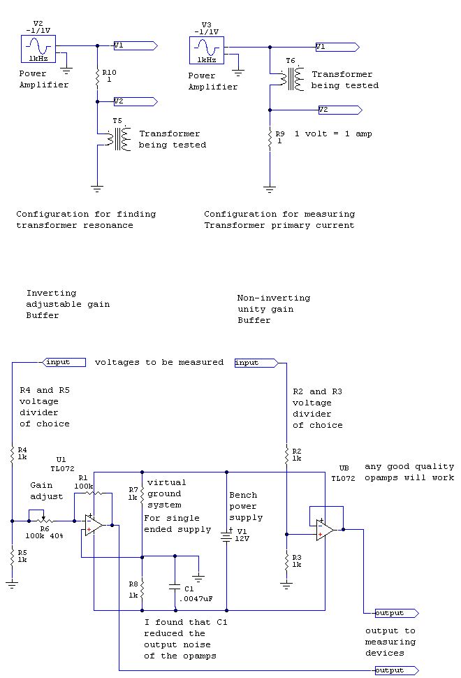

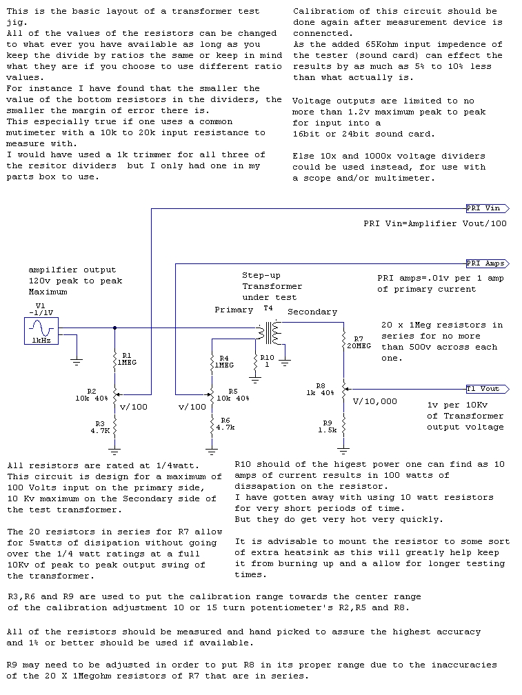

You might try returning to the test setup with the T300 transformer where you used headphones to listen to the low level signal upstream and downstream of the capacitor.
Setup description(post#20): http://www.diyaudio.com/forums/planars-exotics/226637-distortion-esl-low-level-2.html#post3310161
Your previous results were distortion after capacitor but not before(post#23):http://www.diyaudio.com/forums/planars-exotics/226637-distortion-esl-low-level-3.html#post3310695
But, I don't think you ever when the last step and removed the connections to the HV supply and panel.
Try the test with just an amplifier, capacitor, and transformer. Nothing at all connected to the secondary or secondary center tap.
Do you still get distorted sounds when listening with headphones to the low level signal after the capacitor?
If not, start adding things to the secondary until you find the culprit.
If distortion is still there...something odd is going on...more thought required.

ill try to anwser as many as i can
i used bias of 6Kv and used every step in betweet the cascade , but decreasing the bias has no effect on the distortion. also if i remove the bias lead to the panel (then its still charged) it still distort
the distortion is more audible then measureable with sweeps, because it only happens with low volume, to low for measurements. but enough for me sitting on a couch going nuts about this weird sound, as if its held back or stuck to one stator, wich it is not. so the audible distortion looks to be most pronounced in the mid/low's piano with all harmonics tend to sound the worse, especially the decay. in sweeps i wont notice a big difference.
Resistance shorts, or bad resistor. i used several panels with and without resistors. just plain PCB panel with PCB Pvc spacer menbrane pvc spacer PCB distorts. and its only a panel of 10x15cm with licron as coating. not allot of things can go wrong with such small panel i guess.
the others panels are from wire, thats runs up and down looped so only 3 connections are made 2 for the segmentation and one that goes to the tranformer.
Resistance to primary. yes tried it as well from 1 ohm to 2.2 up to 15 ohm no change.
about the bias, i have 2 biases from solosound rated at 5.7kv acording to specs (got no meter that can handle such voltage)
both are simple cascades without even 2 transformers one forwared one backwards. only 2 resistors one to the 0 on the tranie and one to the bias lead . its a small resitor so the current cant be that high. the rest are diodes and caps. both resitors are working fine. also my gues when i remove the bias lead. so the panels is holding its own charg should the distortion go away if it had anything to do with the bias ?
hope this anwsers some of the questions everyone might still have.

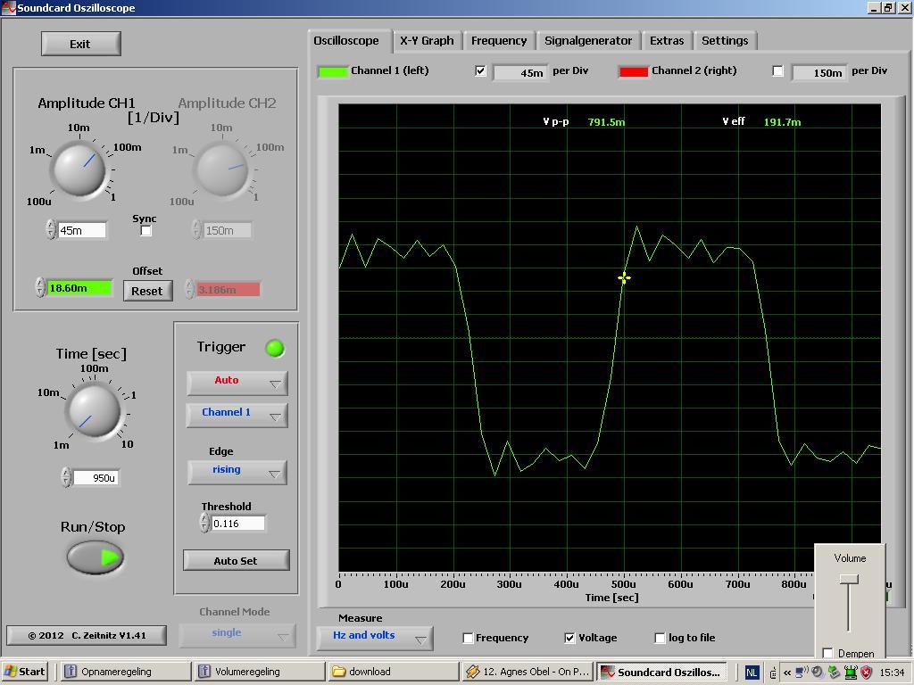

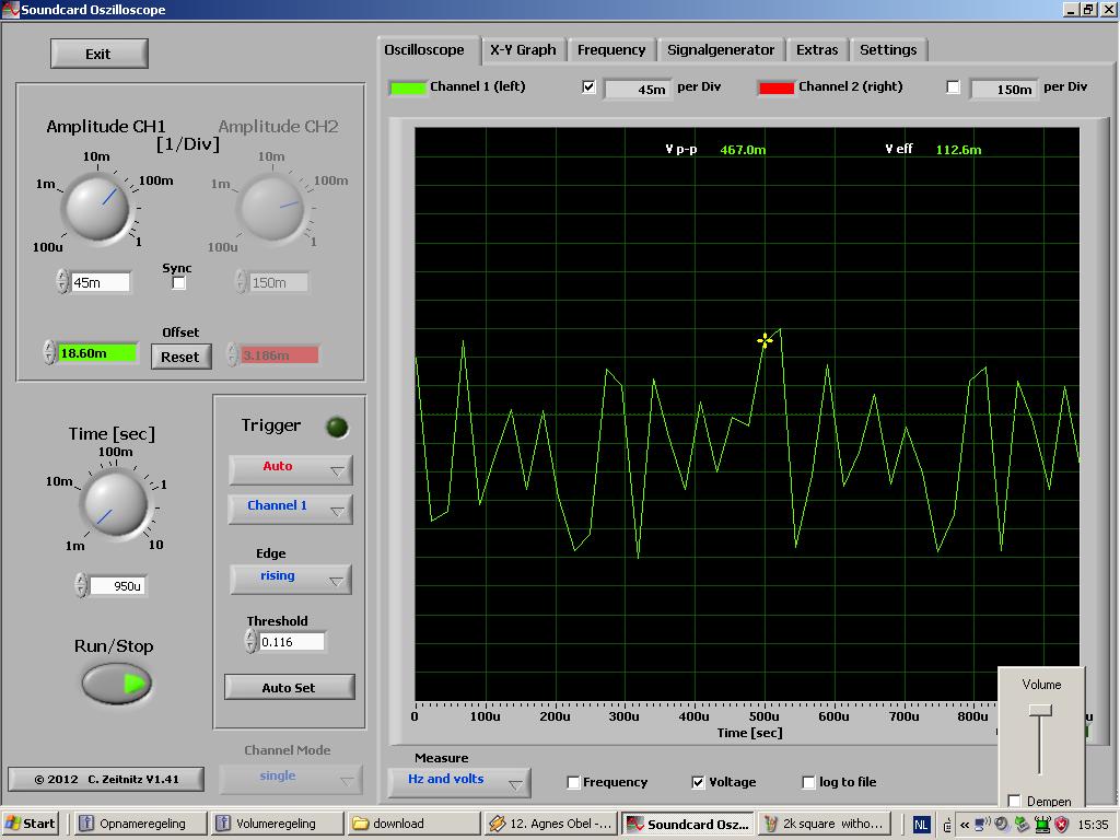

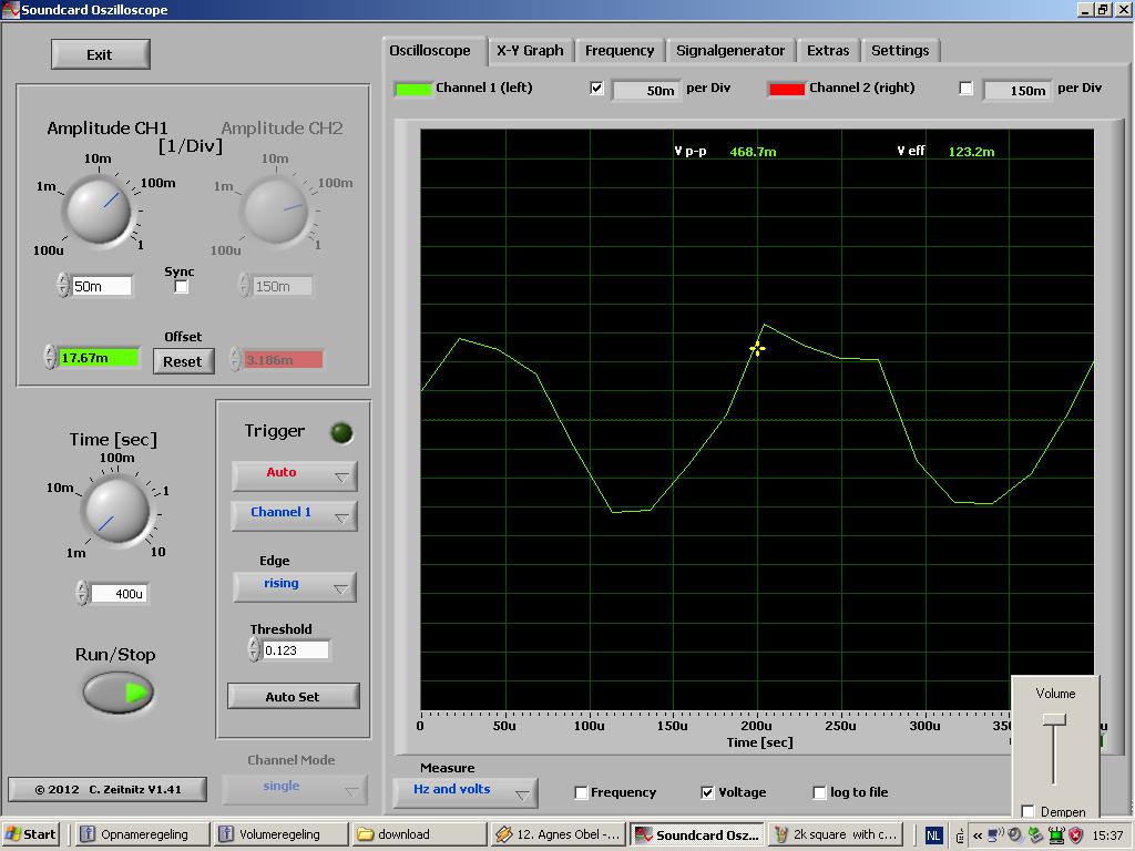

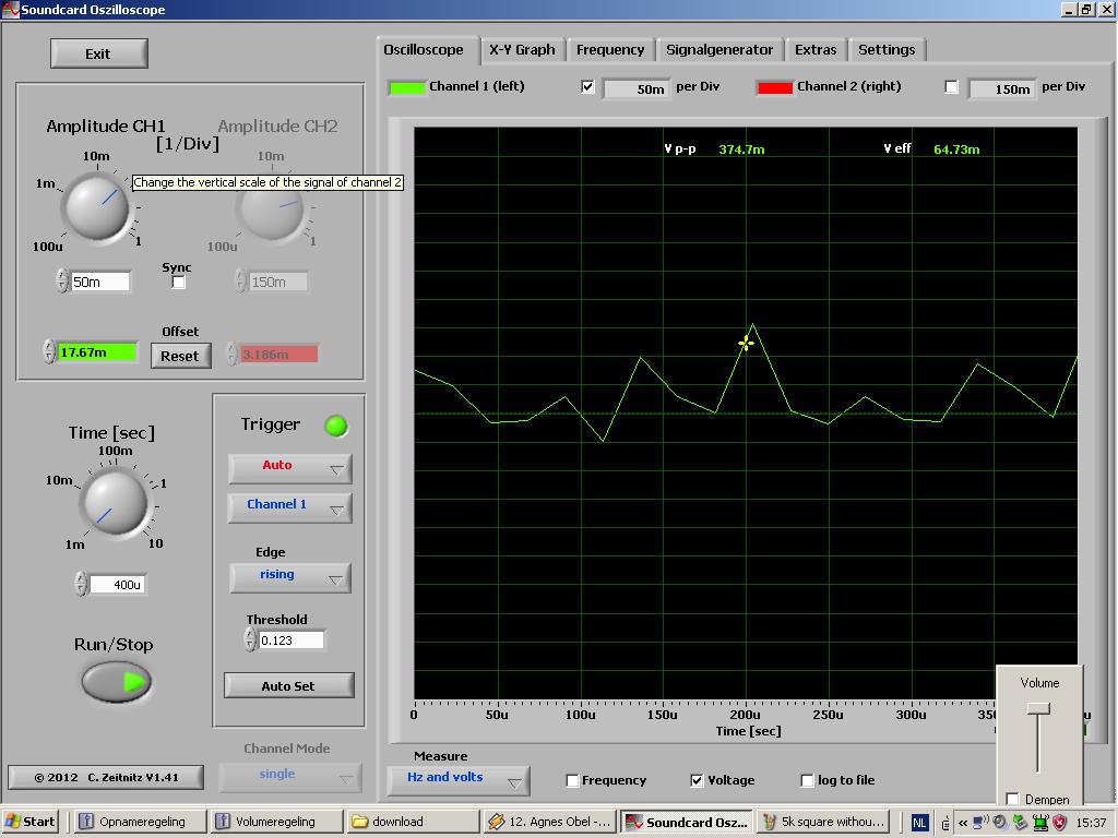

ok i tried.
results are: connected cap and transformer both the solosound and the T300 wich really should be a decent trannie C core verry long flat bobine.
well if i listen to V1 before the cap with my headphone its sound ok but with some noise could this be impedance mismatch ? or what, sounds like having a soft recording and then put volume half way. i must say the volume knob is just a little bit open because i want to spare my ears and my headphone. could the background his be the noise from the power amp ? after the volume knob ? well any how it sounds not distorted.
then when i ad the cap and the trannie, and listen to V2 after the cap it wil get distorted, if i then listen to V1 it has no distortion or is completly masked.
Then when i listen to V2 after the cap, remove the trannie its sounds not distorted or commpletly masked. i must add by removing the tranformer the impedance from the headphone is so high the crossover frequency drops a huge amount so could mask the distortion a bit in the harmonics.
as posted earlier in the thread you mentioned, is also an image of what happens, in the waveform. and it looks i still have this problem with not even having a pannel or the bias connected, just the trannie and a cap.
in the waveform it would looked like the it had a hard time geting positive so the peaks in the negative direction where stronger then the ones in the positive direction(or other way around same idea.)
because i used 2 transformers now i cant believe its the quality that sucks. i mean these are trannies from an comercial ESL that is pretty succesfull an is still around form the 70 until now. and the T300 i heard never complaints about. my basic electronic expertice as far as i have that does not reach far enough to understand whats hapening

this is the T300 trannie on the picture the lamination is like 0.2 0.3 verry thin anyways. the C core is around 25mm thick

Hi again same problem still, but got this scope program now, im no expert with scopes never used one but i tried making some measurements, if someone has pointers! pls let me know and i will try to perform it, im sick of this werird stuff :9 i want to finally use the stuff i made.
did some tests with this scope program, i measured the output of the tranformer. with 15uF cap and without. on 2Khz and 5khz to be sure to be out of the crossover region
1. 2k square wave without cap
2. 2k square with cap
3. 5K without cap
4. 5K with cap.
must say this is the high voltage side measured so i had to keep all output levels low tp not destroy my laptop line in :0 , biut still the diferende is noticable. also tried it with a mic Square waves and saw tooth dit not look anything like the input.. with pure sinewaves they looked PERFECTLY clean. could not fins anything weird. this kind of explains for me while Holmimpulse measuremenst never looked weird.
i also measures before the tranies, frogot to take picture.
i measured before cap with trannie and after the cap with tranie and also after the cap without tranie. only before cap or after cap without trannie connected resulted in Square waves that at least looked like the original
3. 5K without cap
4. 5K with cap.
You should make the interface I have described in order to to not risk blowing up the inputs of your soundcard.
Full info can be found here,
A TEST JIG FOR FINDING ESL STEP-UP TRANSFORMER PARAMETERS
I have used this for up to 5Kv and it is good for 10Kv safely.
It is very simple to build and is very accurate as long as you take the time to measure and calculate all of the resistors to insure complete accuracy.
I have included trimmer pots in the design for fine adjustments as well.
I use this with Visual Analyzer and other measuring programs as well.
In fact I just finished a new updated version with precision opamp's (LT1057) and I just spent all day and last night testing it out, that's how new it is.
Below is the schematic of the original version and the updated buffer section in the thread as I have shown examples of it in action measuring a transformer at full tilt of 4.5KV of output voltage.
I used the non-inverting opamp configuration in my version.
But I do show both configurations to choose from and have tested both for functionality.
I know this works as when I tested it I was going straight in to my brand new motherboard and didn't have to send it back, under warranty of course(He,he,he,he) ,and ,it is still working to this day.
jer
P.S. You can omit the opamps but it will induce inaccuracy's due to the sound cards input impedance so it is best to include them.

I was able to find all of the parameters of my transformer quickly using a new buffer that I had made.
It works much nicer than my signal generators output stage since it has the capability of up to 2 amp swings.
I found the exact saturation points for my cores easily at 25Hz with 10 turns of wire.
I was doing some impedance sweeps and I still find something peculiar and very non-linear using the software methods I have been using if the proper reference resistor is not used.
I am still investigating this, as they just didn't match up to the manual method even though they measure a perfect resistance very accurately.
Here is the link to the cool little buffer that I am using now rather than having my big power amp to drive the transformer that could risk an over voltage situation by accident,
http://www.diyaudio.com/forums/soft...re-capacitor-impedance-graph.html#post3848338
The document in the next post is great as well and I will have to write a program to see what the interaction of the value of the reference resistor is doing to the curve.
I found that I have to use a .47 ohm Ref. resistor using a program to plot the curve in order to get the same values I got by manually plotting the curve using a 4.2 ohm Ref. resistor.

here some measurements i made from the transformers from a AS (es 100, 200, 300 series). Measurements only from the two 1:75 transformers, so 1:150 and no mirrordrive transformer.
The last is my own homemade transformer (it's sold last week because i want to make something new)
