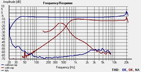

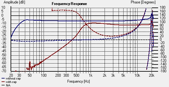

Ok i used a second amp to connect to V1 and V2 and listen with my DT48 headphone. and i can clearly hear the distortion on V2 V1 is clean
i know have connected the line out of the amp to my laptop mic in, without boost. and ran homlimpulse.
the frequency for the crossover is shifted due impedance of the line in i think.
Blue cruve is the control on V1. red is V2
first image is freq response, second freq response and phase, 3rd is freq response and THD
adding the resistor over cap, does not do anything execpt lower my corssover. distortion still there. i used 15 Ohm and later a 30 wich does not do much either :(
for the fun of it ill record a piece of piano on v1 and v2 :), the 100 sine maybe better a 500 ? sine caus the crossover shifted few hundred

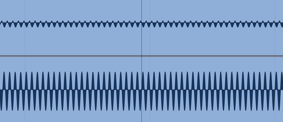

Here is a picture wat happens i think.
is a screenshot taken in protools of a sweep i played with and without cap. upper is with lower is without , (V1 bot V2 top)
as seen it has problems to get positive. it folows the control nicely in the negative but crap in the positive.
also is out of phase as you can see,but thats explained by the phase measurement, the picture is from a frequency somehwere in the crossover range, where the signal is out of phase as you can seee in the holmimpulse measurement. so thats ok :), only thin not ok is the fact that positive and negative ar not equal.

if i remove the panels from the trannie, when playing the distortion stays the same on the headphone. when i remove the trannie from the cap, distortion on the headphone disapeares. so in my conclussion it has to be the trannie. but only thing i still dont get is why all of this disapeares with higher volume. i might have to install my class a amplifier to see if this makes any diference in maybe current/voltage drive capabilitys. expecially on low volumes. ..... hate to move this thing :(
well that did not help either.... ok im out of ideas. if its the tranie, then i have like 6 none working tranies, wich do work without cap...... kind of wierd a.
only thing i can do now is get bigger cap just to not pump in allot of power in the tranies under the resonance frequency, en damp the hump around 200 Hz with felt. i believe i can almost entirely remove it with this stuff on the back. that leaves me with a rolloff of 18dB octave at 220 hz, maybe cross the magnepan there with an 18dB oct filter ?
if i remove the panels from the trannie, when playing the distortion stays the same on the headphone. when i remove the trannie from the cap, distortion on the headphone disappears. so in my conclusion it has to be the trannie. but only thing i still don't get is why all of this disappears with higher volume.
Excellent trouble shooting :up:
Looks like you have isolated the cause of the distortion to the transformer.
Perhaps the cores are not of best quality for audio use and retain a small amount of residual magnetism in one direction. Putting the capacitor in series keeps the amplifier from being able to control the residual magnetism at zero crossing.

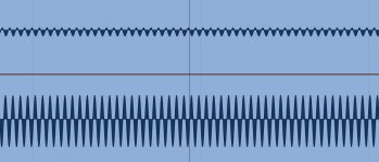

made mistake there left is V2 right V1 :) ofcourse
What I can see it's a definite DC offset most likely at the amp's output (??). Do you have mutimeter/voltmeter of any kind?
When you removed the panels and still heard the distortion at V2 but not V1, was the HV bias supply still connected to the transformer? or did you disconnect it from the transformer when you removed the panel connections.
V2 is sampled after the signal has passed thru the 15uF capacitor so even if the amp did have some DC offset, the capacitor should effectively remove it I would think.
I'm still trying to come up with a reason for this type of distortion at V2 but not at V1...something very odd is going on.

For this kind of application, where the magnetizing inductance of the transformer plays a big role, a very low coercivity material is essential, otherwise it will cause the kind of problem you notice.
As a temporary fix and to confirm the effect, you could mix your low level audio with a high level ultrasonic frequency (>20KHz more or less, depending on your hearing abilities).
...For this kind of application, where the magnetizing inductance of the transformer plays a big role, a very low coercivity material is essential, otherwise it will cause the kind of problem you notice...
It seems that most core related distortion mechanisms, including that due to DC offset or residual magnetism that I had suggested, result in distortion that gets worse with increasing volume which does not match the symptom described by WrineX.
Rereading the post by Elvee the comment about inductance playing a big role suggested to me a possible mechanism for the distortion. The inductance of the primary and the series capacitor form a voltage divider. The larger the primary inductance, the larger the portion of the input voltage that will be present across the primary.
Now, the primary inductance of all iron core transformers is a function of the number of turns and the permeability of the core. The permeability of the core is a function of the input voltage, increasing from some initial value of usually several 1000 and peaking just before core saturation starts. This results in the primary inductance portion of the voltage divider being a function of the input voltage. Usually the primary inductance is large enough that it's impedance is significantly larger than that of the series capacitor.
But poor transformer iron has very low initial permeability and would result in very low primary inductance for low input voltages. So, only a small portion of the input voltage appears across the primary. This also means that the majority of the voltage drop due to any current distortion caused by the core will show up across the capacitor and distort the voltage fed to the primary. As voltage amplitude increases, the primary inductance increases and a greater portion of the input voltage will appear across the primary and distortion is reduced.
The fix is to use better core material, or drive the transformer from a lower impedance source (ie no series impedance like capacitor)

Yes, in short it is caused by the non-zero coercivity resulting in hysteresis and causing distortion, just like in raw magnetic recording.
The fix, temporary or definitive, could be the same: add a high frequency bias.
