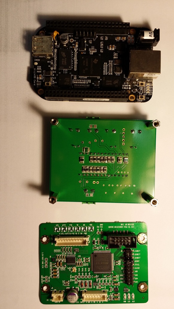

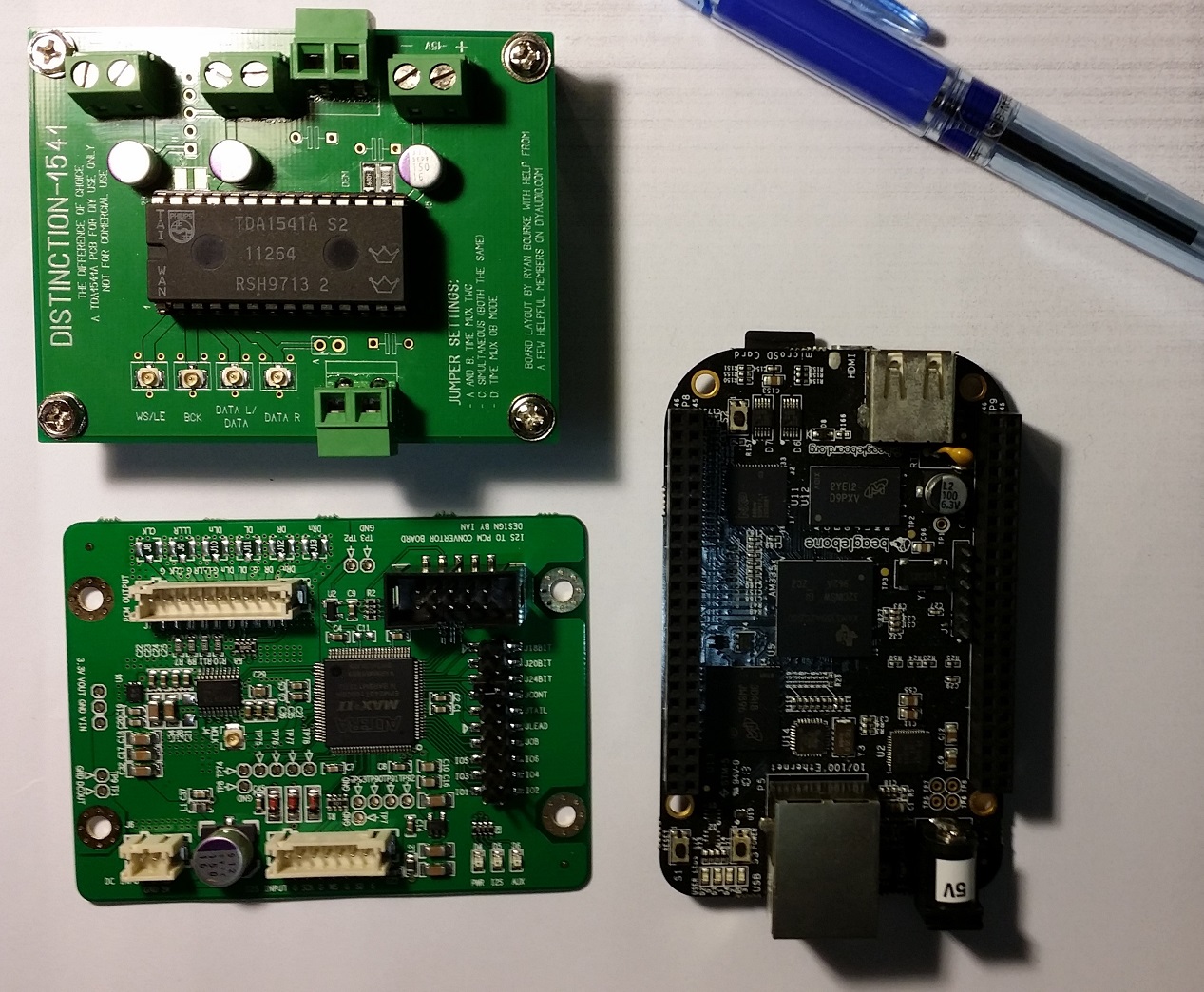

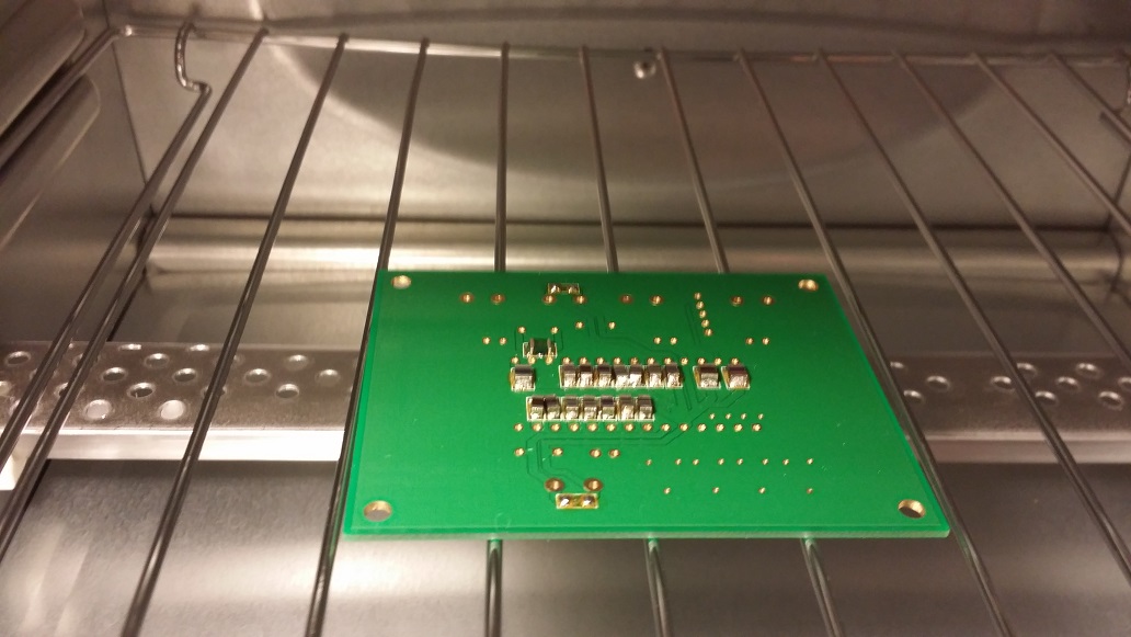

Distinction Finished Pics
Proudly presenting my just about finished Distinction. I think this board is beautiful. Thanks Ryanj for the board. I think this captures some of the best ideas put forward by Thoreston, ECDESIGNS and many others. It will be a while before I have the rest of the power supplies etc done. Pics are taken together with a BBB and Ian's I2S to PCM board.
Looking good! Thanks, it was a pleasure to give something back to the DIY community. Keep us posted when it finally gets to sing.

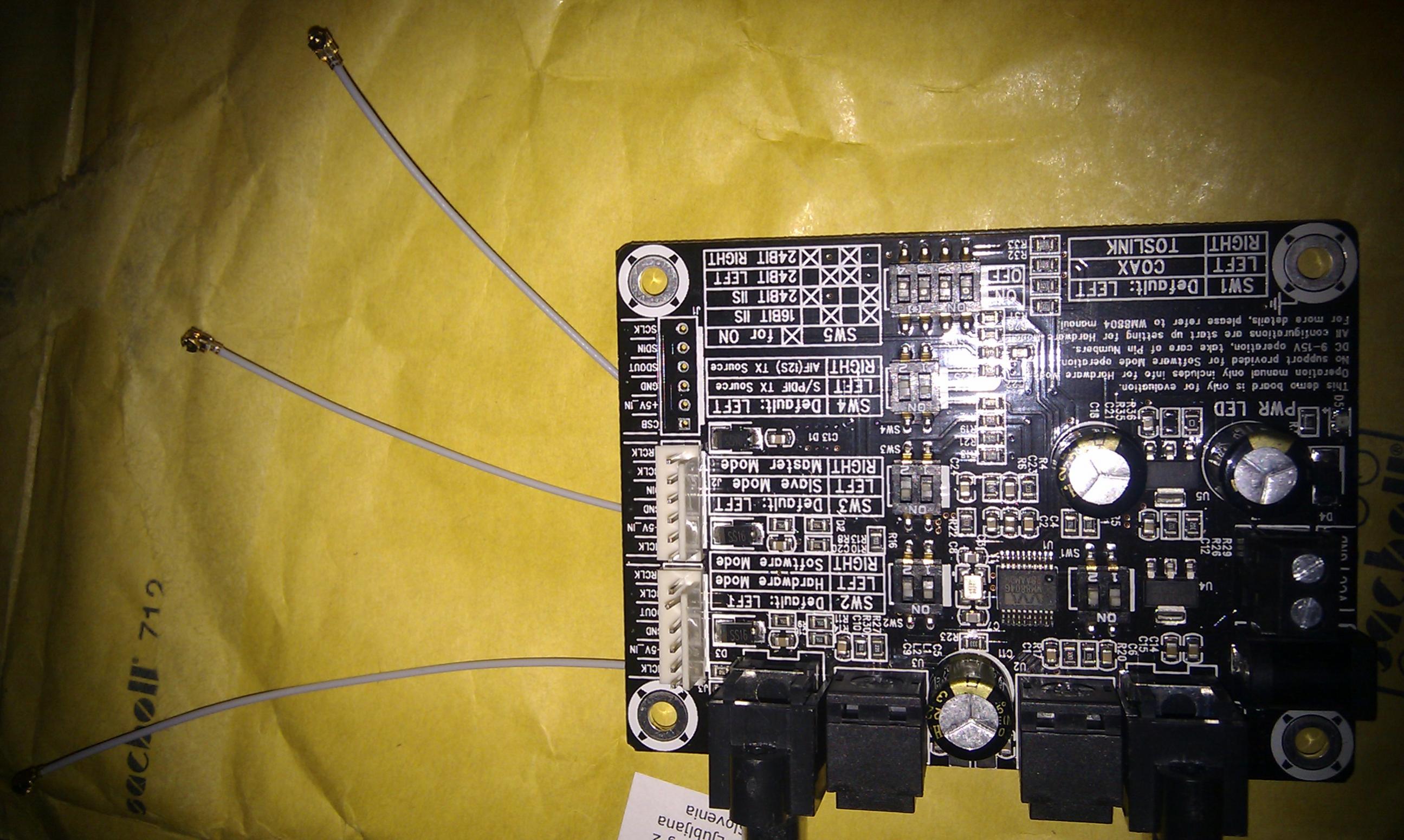

Made some diy as i 'm waiting for the new WaveIO as input source (it will have uf.l connectors on the daughter board!)
Here a spidf 12 euros Sure-electronics boards with hardware mode with its embeded XO. The W8805 chip is 50 ps jitter "only" and have a little fifo embeded !

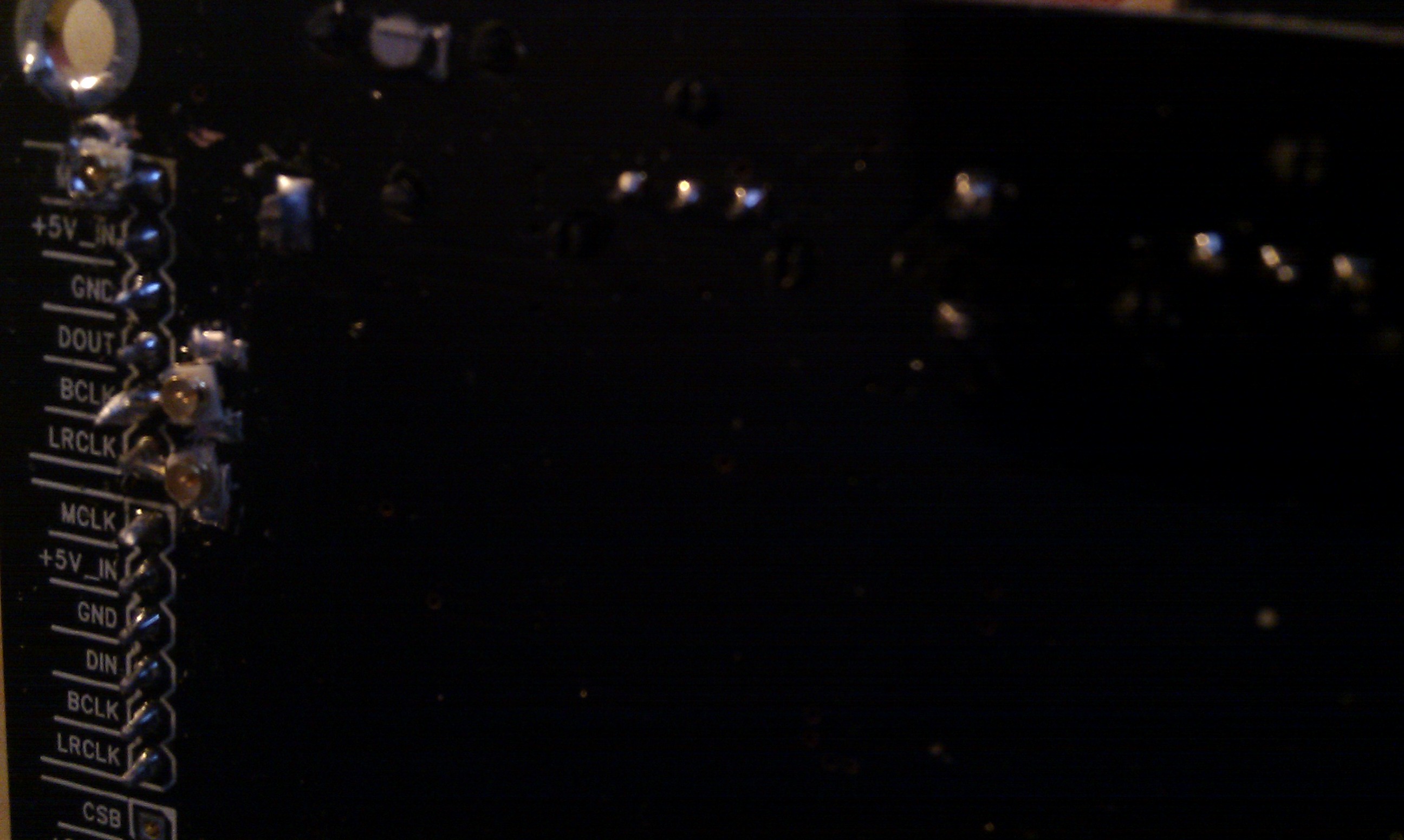

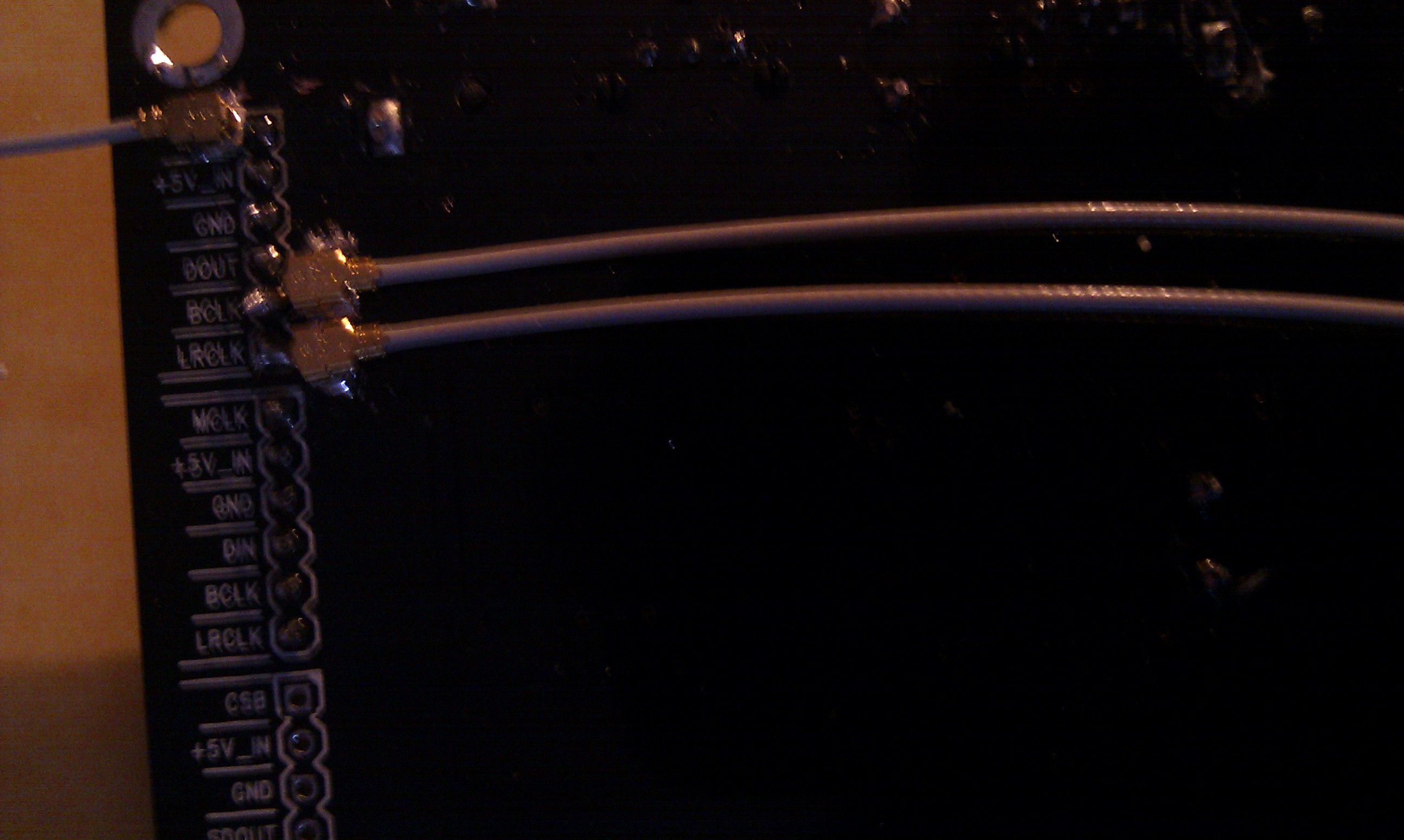

As the pcb output has a bad GSSSSS I2S signal (G= gnd ; S=signal) connector, I putted uf-l connectors. With the uf.l cables I have now a GS GS GS connection : each return path signal is near from the signal (as it is coax) + boards are at the same impedance (50 ohms) + coax output line is a shield for the hot signal line !
Of course I will try also the Ian I2StoPCM boards to feed the Distinction-1541 in simultaning mode ! With Uf-L connectors we can easily change of boards... but not too much as the connectors are fragile : maybe three times max ? Have not tryed yet :D!
Well, maybe I will try after to tweak the caps of the boards. I found the KZ Muse 50/100v (25v unadvised) worked much better for this wolfson chip than a polymer cap in the case of the Subbu (use the same chip but a better embeded power) management. The Sure Electronic board has an input voltage of 9v to 15 v... here the quality of volatge is important as well , maybe the embeded ldo is not the last brand new one (hey it's a 12 euros board) so I will put a good pre 9V reg)! On the board some good 0405 smd caps size are present for decoupling...

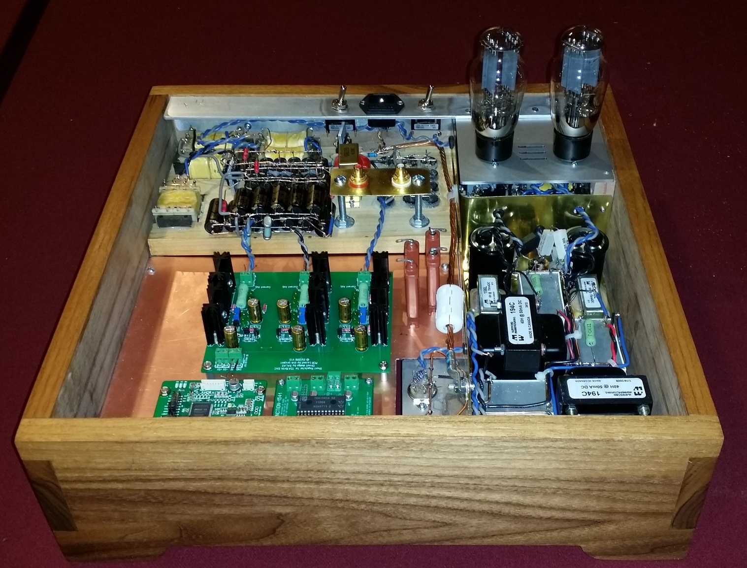

Any update on your progress?
Sure. Actually have made a lot of progress and fairly close to finally hearing it. Soon I'll update my blog with a build overview.
As you can see in the pic, things completed include:
- chassis and layout. power supplies are separate from dac. Sections are isolated using brass sheeting. 2 story layout. BBB, WaveIO and Ian I2S 2 PCB below, and Distinction upstairs separated by copper pcb groundplane.
- Tube output section. Dual mono, tube diodes, all film caps and chokes. Modeled after Lampizator big six. Should be pretty good.
- DAC power supplies finished. Separate transformer for every rail. Ultra soft recovery diodes, lots of filtering caps. Salas shunts all working.
Left to complete:
3.3v supply for Ian board,
mount the pcbs, and
figure out how I am connecting everything, and last
design a nice Aluminum top sheet with holes for tubes, etc.
