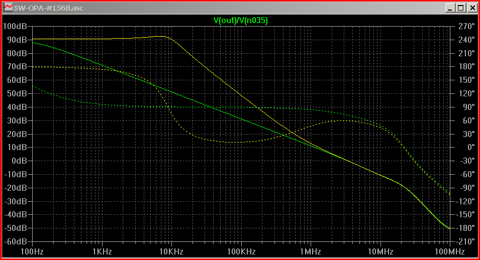

splitting the Ccomp, bootstrapping the middle to the driver output gives 30 dB more loop gain to 20 KHz; costs < 10 degrees phase margin
heck it even looks like flat loop gain to 10 kHz
from the below Ltspice sim, simple Middlebrook loop gain V souce in series with feedback divider
split Comp, doubled pF, added 500 Ohm to Q15 emitter
green trace: original single pole loop gain;
yellow: split, bootstrapped Ccomp 2-pole comp
To keep the ball rolling, here's a quickie knock up of the schematic from #1568 for those who are averse to fiddling with the versions already posted. Appears to be OK, haven't checked everything, I'm sure people will point to any problems ... :)
The PSRR looks much, much better of course. One thing though, can't push the output standing current up to 8mA easily for some reason ...
Frank
