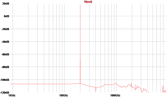

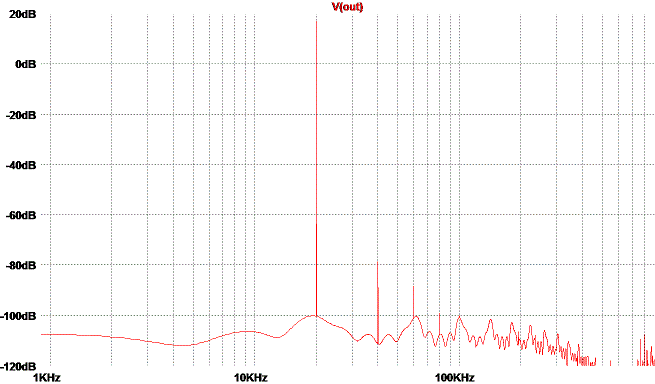

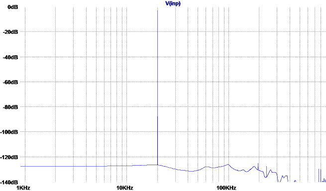

I've been playing with fas42's model of Guru Wurcers FET i/p 990 version from #1511.
The 990 has a similar topology to a low feedback power amp I did a lot of work on circa 1990. So I have a lot of 'real life' vs 'simulations' I can call on.
I'm using this project as "Become a LTSpice guru for Dummies". In the 90's, I spurned SPICE for my own Circuit Analysis programme ... but that was of course only linear.
I think it might be possible to get near Wurcer performance with less complexity.
There's still a lot of work to do but it appears that this is possible given that it doesn't have to be unity gain stable ... as long as a clear tweak path (caps vs noise gain) can be written .. as with Guru Wurcer's.
What can it do?
In the tested form, 10x gain 600R load
+292V/us -175V/us
20kHz 10Vp distortion FFTs are enclosed. I'm still trying to get to grips with LTSpice. In particular, the FFT of the input waveform Vi.png seems to vary from day to day. Vo.gif shows the individual harmonics are easily -110dB.
But here I'm cheating. Both the zillion V/us and low THD are obtained by using Prof Cherry's 'inclusive' compensation. This is far more subtle than Self and even Baxandall realise. One advantage of this method is by not slowing the output of the VAS, 'crossover' is minimized. This is in direct contrast to the Gospel according to Self and others but I can vouch for its practical effectiveness.
But one caveat is that the output of the VAS (Q16) needs to be kept pristine. Vo.gif is without the clamping diode Q8 which is essential for clean overload. The slight capacitance of the diode-connected Q8 is enough to degrade the THD to Vr.gif. 2nd is now -95.5dB and 3rd -105.2dB. (Note the input FFT floor has changed yet again.) BC546 best out of 1n4148, 2n4401, 2n5501.
Suggestions on low capacitance diodes (with good SPICE models) for Q8 and also advice on how to get super low distortion sine waves in LTSpice would be appreciated.

Incidentally, the clamp diode Q8 in Scott's & fas42 models need to use collecter/base rather than emitter/base. Emitter/base has higher capacitance and will also Zener in this position. I'm impressed that fas42's SPICE models actually reflect this capacitance (if not the Zenering)

for a given spread what affect does the spread (mismatch) have on thd/harmonics of X10 amp and X100 SW-OPA? From worse case measured from the 19 pieces to tight spread of maybe 2%. I suspect it might be a small difference because of the high olg/fb available. What does sim say?
Your instincts are good, Richard ... as a first exploration along those lines I altered the VTO of the BF862 model to create 2 new versions, BF862.02 and BF862.03 such that cut-off Vgs was firstly -0.85, and then -0.5, giving a nice spacing of Vgs at 100uA around Scott's figures. BETA was slightly adjusted to give Idss's of 25 and 10mA, maximums per the data sheet.
Into 1k load, gain of x100, 20kHz at 20Vpp the 2nd harmonic is down 89dB using the normal BF862 model. Then I tried 2 extra runs with BF862.02 on +ve input, BF862.03 on -ve; and then reversing that. Severely mismatched, so the source resistors had to be adjusted to 5 and about 75 ohms to correct offset.
The distortion only deteriorated to -86dB in the worst case ...
Frank
That's as it should be... a minor difference -- 3db in this case -- for high gnfb designs.
Then, the diff pair matching might best be focused more on dc and or thermal tracking/offset considerations rather than for lowest thd/harmonics. Thx - RNM
