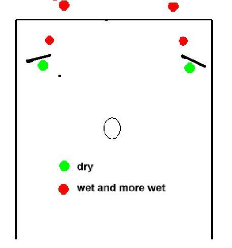

Now things have become too detailed for me to explain them in words. 🙄 A picture might be better. This is where I "see" the phantom sources:
attachment.php
"Dry" is fixing the sound to the speaker. "Wet" moves the phantoms away from the speaker, but also increasingly to the center. Distances to the front wall or behind the front wall are only descriptive - "more wet" is farther behind the wall than shown, but I can't give an exact distance.
Is this roughly in line with other's findings?
I don't experience any remarkable changes in the heights.
Elias,
with SSSx5 - do you hear any comparable change in the positions of the phantom sources between "at the side walls" and "at the center"?

Note: If you look at Rudolf and Helmuth's pic's - Helmuth has greater separation of L & R relative to Helmuth (..than Rudolf's L & R relative to Rudolf). Because of the lower cross-correlation for Helmuth, the image is slightly in front of the speakers, whereas Rudolf has the image directly at his speakers position. If Rudolf were to move L & R closer together, then he should have the "dry" recording's image move back from L & R marginally.
