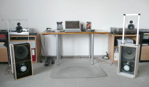

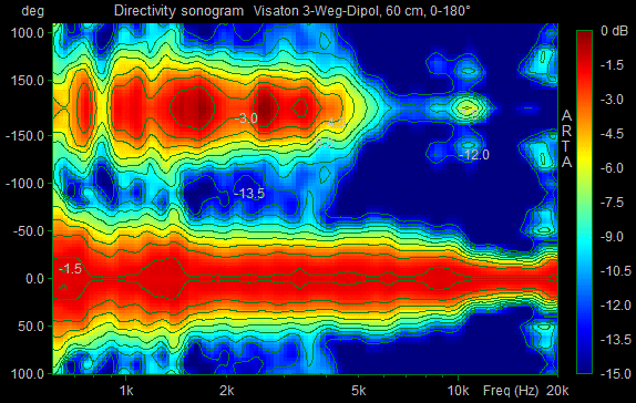

I wonder how your system is different than the others?
attachment.php
"True" figure 8 dipole without baffle for mids and highs.
