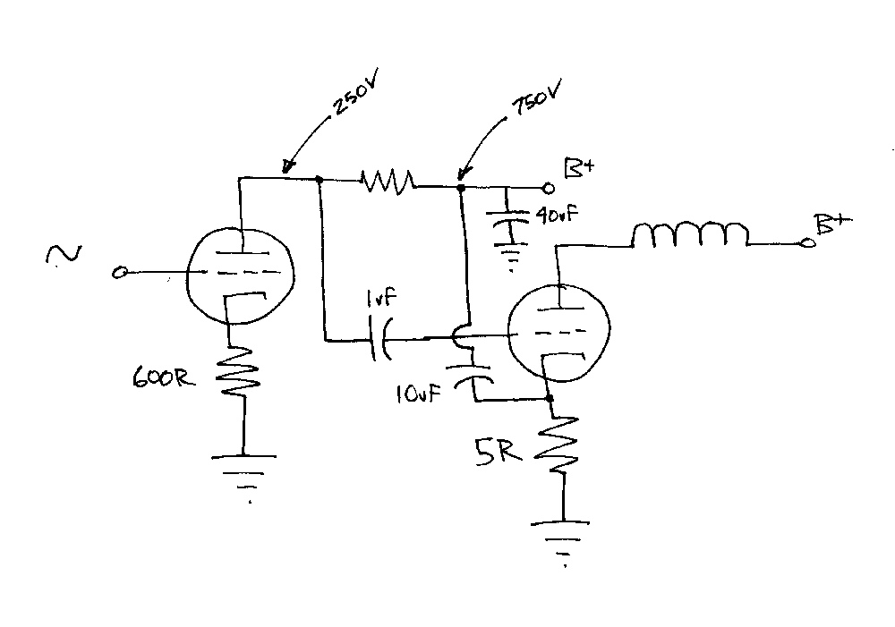

jeff mai said:I don't follow your reasoning.
Jeff, WE coupling relies on amplification to match B+ noise levels on both sides of the output transformer. The coupling method I'm suggesting is purely passive. There exist, as a result, several operational differences between the two. One important difference is that the shape, for lack of a better term, of the amplified noise signal in WE coupling will never match the shape of the noise signal it's intended to match because:
1. the amplified signal will be distorted by the tube, and
2. the method really is a form of feedback and thus will suffer some part of the range of difficulties feedback introduces.
The coupling method I'm suggesting doesn't suffer these (call them shape-matching) difficulties, but suffers, from what I can surmise, from amplitude matching. The amplitude of B+ noise appearing at the grid of stage 2 varies according to the amplification function of the tube of stage 1, the variation itself taking the shape of a tube-distorted sine wave; the amplitude of noise appearing at the cathode of stage 2 is constant.
The residuals of these two methods of coupling will therefore be different. Whether one is "better" than the other or whether either is preferable in any application is left to one's subjective perceptions of the result.
Kuei Yang Wang said:Sorry, I do not think so. Your methode also relies on the active device.
Thorsten, I'd appreciate some description ahead of your conclusion to explain how you arrived at that conclusion. In my estimation, the B+ noise signal appearing on either side of the stage 1 tube's anode resistor is about as close to being the same in all respects---except magnitude---as two signals could be. This similarity is a product, as I see it, of the passive nature of the coupling method which takes the noise signal across one passive device, a resistor, and couples it passively through two capacitors. The noise signal appearing on the other side of those two capacitors should be virtually identical, except for magnitude (probably frequency dependent).
One possible problem with the coupling method I propose, as Ari pointed out to me, is the coupling capacitor will form a cathode bypass capacitor for the cathode to which it connects, shunting AC through the capacitor down the B+ line through the PSU capacitors to ground. Depending on the value of the coupling capacitor and cathode resistor, high frequency amplification might be lifted audibly.

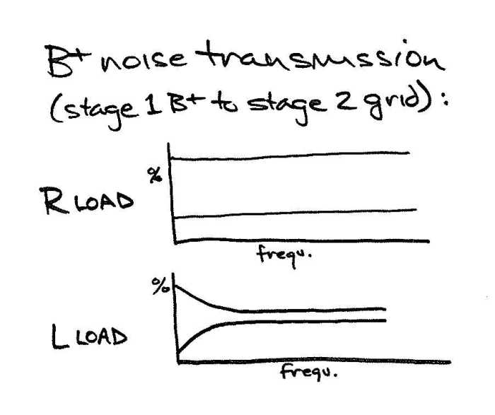

serengetiplains said:Jeff, WE coupling relies on amplification to match B+ noise levels on both sides of the output transformer. The coupling method I'm suggesting is purely passive.
Is it? Really? Please think through the whole thing again.
serengetiplains said:2. the method really is a form of feedback and thus will suffer some part of the range of difficulties feedback introduces.
No, it is not what you seem to imply, namely negative feedback, look at the polarity, it is positive feedback.
serengetiplains said:The coupling method I'm suggesting doesn't suffer these (call them shape-matching) difficulties, but suffers, from what I can surmise, from amplitude matching.

Kuei Yang Wang said:No, it is not what you seem to imply, namely negative feedback, look at the polarity, it is positive feedback.
I do not imply that WE coupling is negative feedback. B+ noise is but a signal that moves as quickly, and with all the subtleties, of a music signal, and is in part created by a music signal. Assume in WE coupling, and at time X, that the instantaneous voltage has changed from the previous moment. What WE coupling attempts to do is to eliminate that change by creating the same change in voltage on the far side of the transformer---in effect, by taking a portion of the voltage change on the B+ at time X through a capacitor and amplifying it. By the time this function has occurred, time X is time Y. The problem inherent in this scenario is a problem common to feedback schemes.

I've been playing around with values in light of Ari's suggestion that the noise capacitor forms a cathode bypass network with the power supply capacitors. Because an estimated average 33% of B+ noise passes to the grid of the output tube, I want 33% of that same noise coupled to the cathode. Given the cathode is a 5R resistor, my coupling resistance should therefore be 10 ohms across the frequency spectrum. Because of the cathode bypass network formed by the noise cap, achieving 10 ohms resistance as such requires using a large capacitor (of the order of 1000uF) in series with a 10 ohm resistor. I compromised and used no resistor + a 10uF capacitor. With this setup I get high frequency lift of a noticeable but not overly objectionable amount ... at least for experimentation purposes. 10uF gives me 15 ohms reactance at 1KHz, which is in the range of what I want for noise coupling.
The result? Much cleaner mid and high frequencies, including (so far as can be differentiated from high frequency lift) greater high frequency extension. The difference, to my ears, is much greater, as I said, than replacing power supply capacitors with premium varieties, and probably constitutes an upgrade equivalent to that offered by going differential, without the downside of greater complexity differential circuits entail.
Combining this method (if one does not use Ari's stacked supply method) with WE coupling should give a very quiet SE amplifier, with all the benefits of SE circuit simplicity.
A picture of my essential setup is as below. Note that the output tube uses fixed bias.
I've thought about this a little more and have come to the conclusion that the two methods:
1) AC coupling the driver stage B+ to the output stage cathode
2) AC coupling the output stage B+ to the output stage cathode
must function in exactly the same way. The output stage cathode doesn't know the source of the noise voltage you are coupling to it.
The difference between the two methods is the noise itself. It would be interesting to run two wholly separate supplies for driver and output stage and invert the phase of the incoming AC on the driver B+ supply. Most of the noise on the two supplies (which will be residual AC hum) will then be out of phase with respect to each other and it will be easier to separate the effects of the two methods.

Jeff, I do like the idea of combining the two forms of coupling. As you can see from the scenarios I drew above (assuming they're basically correct), both forms of coupling are needed for nulling driver + output B+ noise when supplies are decoupled or fully independent.
Let's also examine non-decoupled supplies in a 2-stage amp. Part of the B+ noise appearing on that supply finds its way to the grid and is accordingly amplified. If the amount of noise appearing on the grid is 50% of the supply noise, and the output tube amplifies 4X, a 2X noise signal will appear at the output anode counterphase to the noise on the B+, thus an overall 3X noise signal will appear across the output transformer to be reproduced in the speaker.
Now inject some of that noise at the cathode of the output tube. 50% noise injection would null the noise at the grid for 0X noise at the anode leaving 1X noise at B+ = 1X noise figure across OTX primary/secondary.
75% noise injection at cathode = 50% nulled by grid = 25% remaining at cathode x 4 amplification = 1X noise at anode counterphase to 1X B+ = full noise cancellation.
The above numbers are crude approximations and omit problems arising from phase shift and noise amplitude variance at the grid. Hence my conclusion "full noise cancellation" is wrong.
Regarding the varying amplitude of B+ noise transmission, if the driver is resistor loaded, say, where RL = 2Rp, an average 33% of B+ noise will appear through RL and be fed to the grid. I say "average" because the actual amount of B+ finding its way to the output grid varies according to the conduction of the driver tube, which is to say the amount of voltage drop across RL changes relative to grid voltage. Changing grid voltage causes Rp to vary which changes the voltage division in the series B+--RL--tube--ground----ie, changes the amount of B+ noise passing to the grid of the next stage. I plotted values to calculate B+ noise transmission at various points of tube operation on a 6SN7 loaded with a 68K resistor on a 750V B+ rail. To obtain the calculation, I plotted tube currents at three grid voltages and calculated the voltage drop across RL for the given current. That voltage drop, expressed as a percentage, indicates how much B+ noise appears at the stage 2 grid using the formula:
100 minus (voltage drop divided by 750) = percent of B+ noise at grid.
Here are the results:
Grid V..........Ia...............Noise Transmission (%)
0V ............. 9.7mA ................. 12
-10V .......... 7 mA ................... 36
-20V .......... 4.5mA ................. 59
In the above setup, B+ noise transmission to the output grid varies from 59 to 12 percent, the midpoint being 36%.
On a resistor loaded stage, the amplitude of B+ noise transmitted to the grid of the next stage therefore varies on the pattern of a tube-distorted sine wave: up and down and up and down, but not as much up as down.
One method of reducing this amplitude variance is to inductor load the driver. An inductor's high AC reactance will reduce overall variations in the voltage divider effect of B+--inductor--tube--ground where the resistive component "tube" varies. Inductive reactance, however, varies per frequency, thus the variance in B+ noise transmission will be reduced less for lower frequencies---the variance pattern, if you will, looking like ringing reducing in amplitude.
