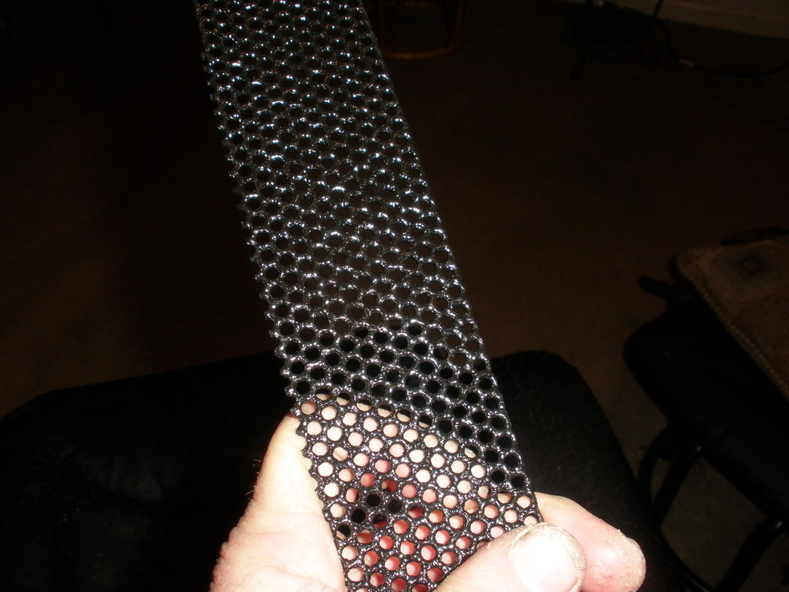

Calvin i think had a bad experience with rhino, so many variables and i wish there were pics of his stats. the thing with rhino, if you make a mistake, i have something to take it back to plane metal in five minutes, so nothing is ruined.

I agree as well, just wish i had a picture. mine looked well, ok, but it was a test. make sure youu use the "zoom in button" on the lower left, Calvin, did yours look anything like this? Ypu have me so curiuos, want to know what went wrong.

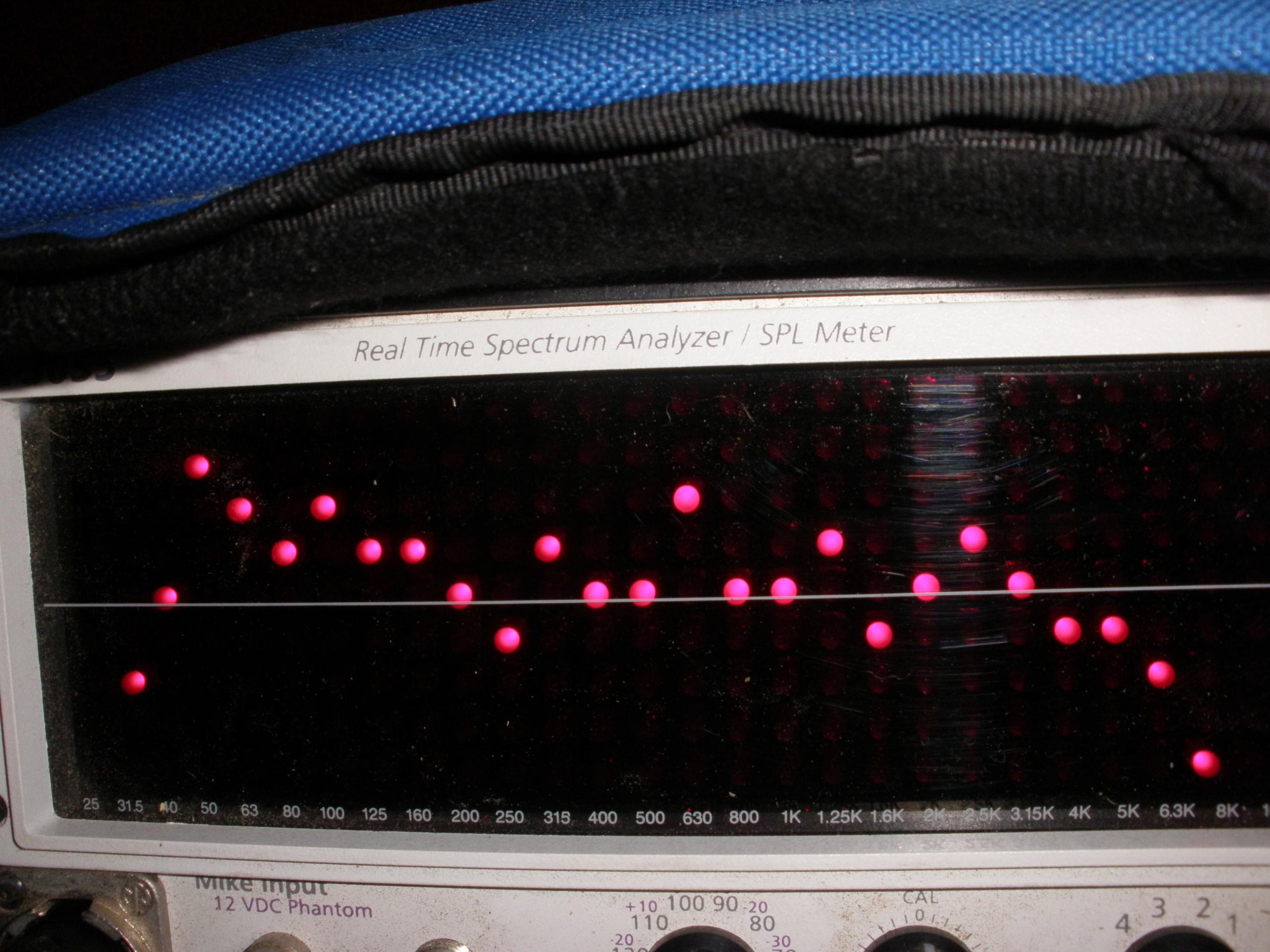

I have it now, Audio Control, have both RTA and SPL mic, trying to something with pink noise, any other suggestions??? i had a test cd, went to or above 20K and popped some fuses, no biggie, just cant watch the meter and clipping at the same time. here is a pick of white noise, i think, no label on the disk.

I'm guessing that dip centered at the 630 hz band is the dipole cancellaton-- you probably have your crossover frequency set a bit higher than mine (275 hz). It will sound a lot fuller once you get that dipole cancellation EQ'd. Pushing a test tone to 20khz into ESL's will really tax the amps-- fortunately, actual music typically doesn't contain all that much energy in the highest octaves.

Hi Mavric,
You might try measuring just the ESL by itself, no woofer. Then measure the woofer by itself, no ESL. This should give you a clue if the dip around 630 is just the dipole roll off of the ESL, or an interaction between the woofer and ESL.
I'm not sure how you have your crossovers set up, but you might find that if you swap the phase of the woofer, the dip at 630 may fill in.

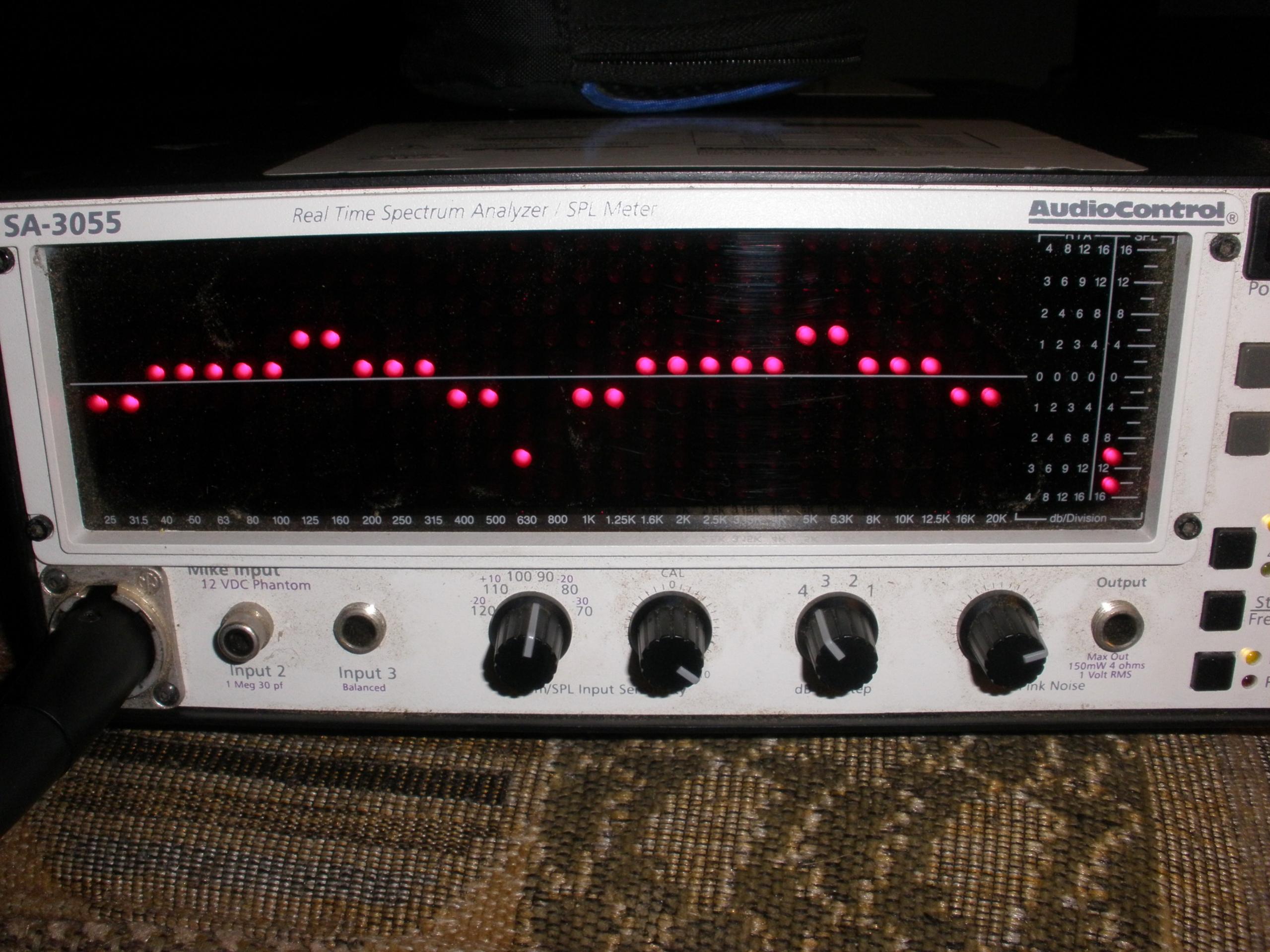

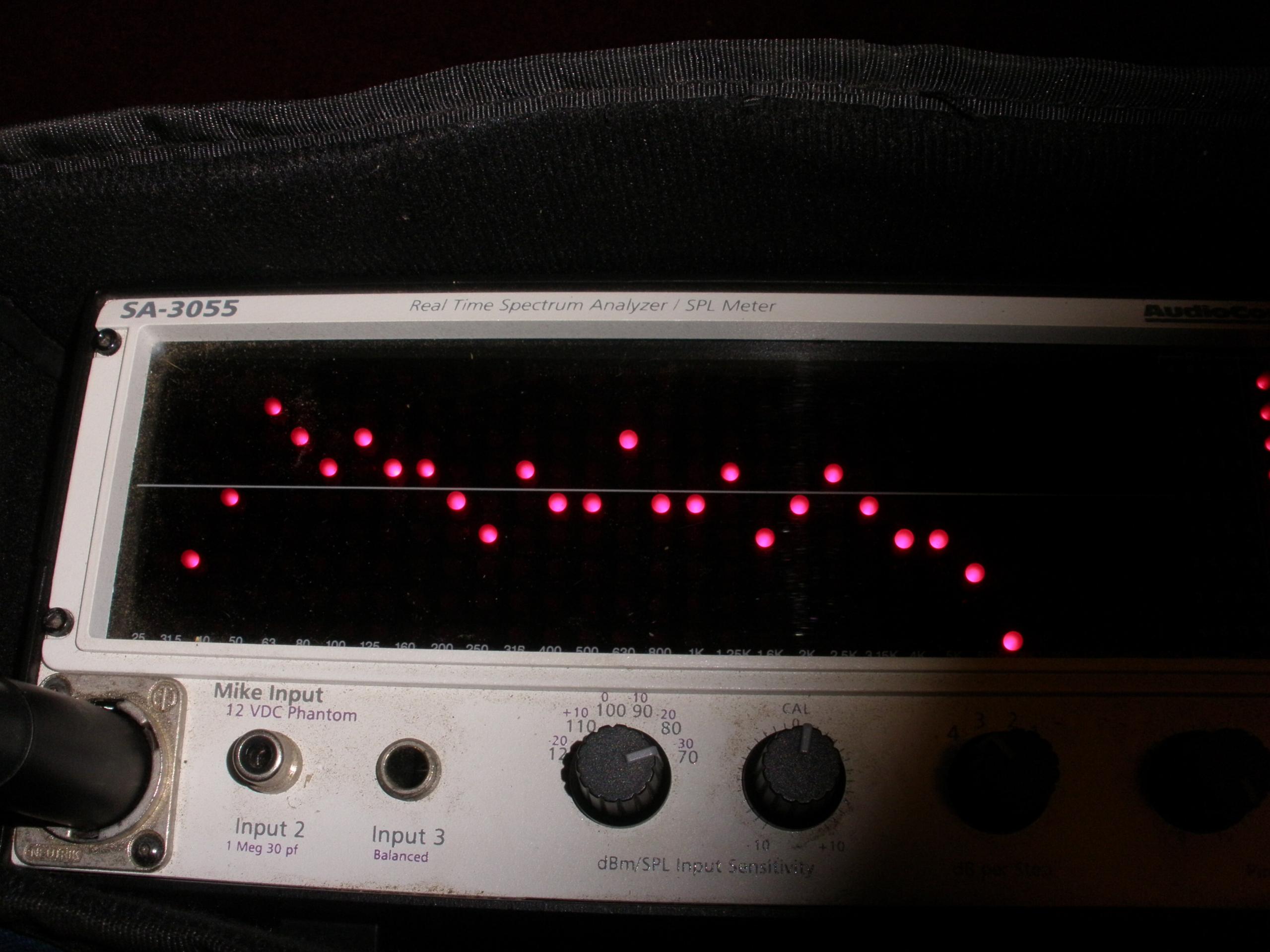

here are some base test, i am still trying to get the cross over adjested. there is a sharp roll off at or around 600 hz, @ 24db, the only problem is that these are old amps, 4 ohm MAX, clipping allerts go crazy when i put a little power( around 100watt, but the impiedence load?????) at very high frequency pops fuses. here are some pics of a traditional speaker a set up, notice there are ho high end, same song as a "conrrol".
