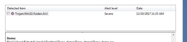

For some reason today MSE is now complaining about a Trojan in DiAna.exe - see screenshot below. In several years of use, DiAna is the only thing that has triggered MSE for me and this is a bit disconcerting! This seems to be unrelated to the initial ".exe in .zip" trigger??
On the other topic, I was inquiring about any necessary changes to the .ini file and preferences for the RTX. Things seemed to have evolved in the last several days and I found it hard to track it all to the current state.
I'll probably sit this one out until there is a quick start document or clear steps, and it no longer triggers my normally insensitive antivirus utility.

Yesterday, the file was clean according to MSE. Today however, MSE also falsely identifies the file on my PC as a trojan. Totally ridiculous, of course. The real problem is that programmers not backed by a large company can't pay an army of lawyers to tell MS (and other vendors of virus scanners) to shut their stupid mouth. Yes, large software houses also struggles with false positives, but do have the means and power to force those sloppy anti virus companies to make an exception for their software, i.e. to suppress false positives warnings.For some reason today MSE is now complaining about a Trojan in DiAna.exe - see screenshot below. In several years of use, DiAna is the only thing that has triggered MSE for me and this is a bit disconcerting! This seems to be unrelated to the initial ".exe in .zip" trigger??
Sure, just wait when things have stabilized and their is no need any longer to fiddle around with the ini file (I also would hate that).On the other topic, I was inquiring about any necessary changes to the .ini file and preferences for the RTX. Things seemed to have evolved in the last several days and I found it hard to track it all to the current state.
Cheers, E.
Edmond you compiled the exe with non Microsoft compiler. It's most likely not signed and this would be why MS thinks it's virus. If you compiled with an MS compiler I don't think this would be an issue as MS signs the exe.
For those of you having trouble with MS essentials follow this link and try adding an exception for DiAna.
How to configure exceptions for Microsoft Security Essentials/Windows Defender in The Grid 2 - thinksmartbox.com
Edmond if you get an installer set up for installing DiAna it may have options for including exception in MSE and Defender.

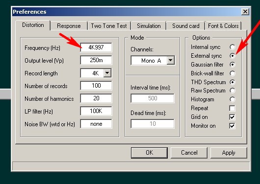

External oscillator
That's certainly possible. The only thing you have to do is setting the frequency in the distortion menu to approximately to right value. In the pro version you also have to select "External sync" in the same menu.
FYI, "Internal sync" works faster as the frequency is already exactly known. In the demo version this option has been grayed out, as data is swapped via disk, which takes some time. During this time, the frequency of the sound card might have changed a little bit due to drift (which would introduce extra noise). Therefore only "External sync" is available in the demo version.

Edmond,
The raises another question. Can DiAna be used with an external ultra low distortion oscillator rather than using the dac in a soundcard? How would the frequency setting work with an external osc.

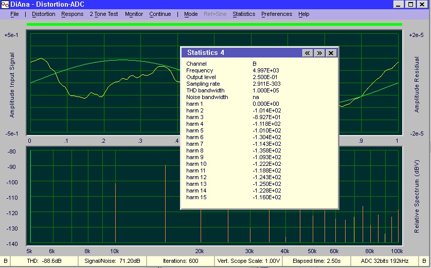

List of Harmonics
To all,
Something like this: (see picture)
Cheers, E.
I would have preferred Harmonic values in the listing (statistics) as well. It should be possible to export as a text file with comments for recording the data for reference.
Re: export: I would vote for export option of data as a CSV or similar delimited file format. That way all your options for postprocessing are wide open.
Jan
would be great, indeed.
Pls consider an option to select the field separator for those people using a comma "," as decimal sign (default eg in Germany).
TIA
Ulli
