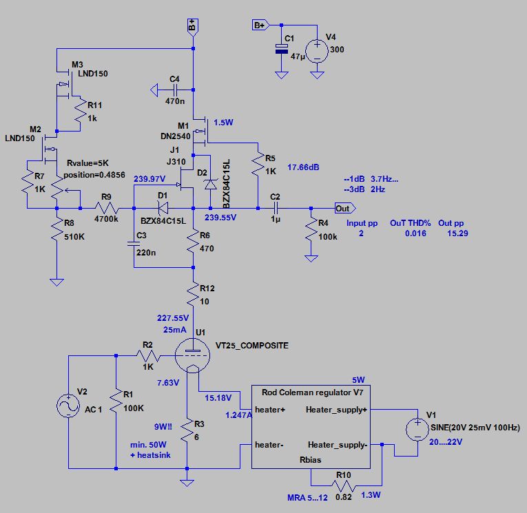

For best temp response of the LND150 CCS pair you need to aim at 500uA ref current so the resistor needs to be adjusted accordingly to the reference voltage you want in the lower JFET
Hi Ale,
That is correct. I used 510k which allows a max of 255V. I am aiming for about 225V, so the CCS is working fine. I read somewhere that in order for the Mosfet and Jfet to work properly, the Vgss mosfet> Vgss jfet. Looked at the datasheets and DN2540 works great with 2SK170, but J310 seems to have a higher Vgss.
Hi Radu,
If you can post a quick sketch with your implemented circuit and voltages we may be able to find out. Do you have protection zener across the drain and source of the J310? They may not survive turn on, depending on how gently your HT rises and current is drawn by the load. They don't harm at all but worth adding it. Try replacing both top FET and lower JFET.
cheers
Ale

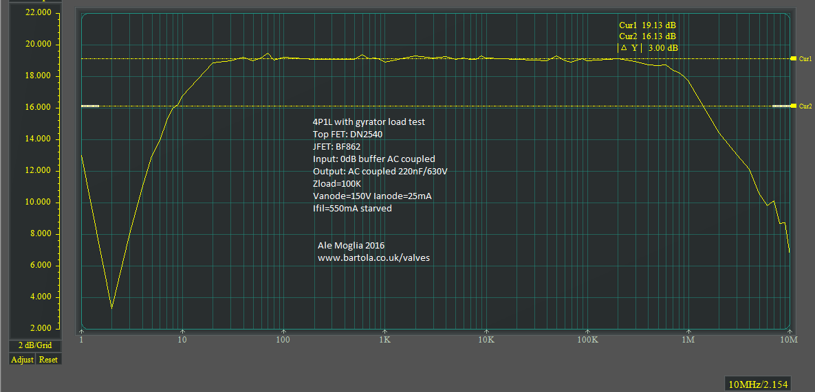

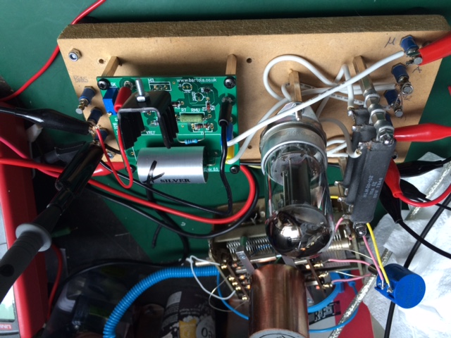

Gyrator board with BF862
Here is an example with my abused test mule on a 4P1L. You can see the benefits of having a BF862 JFET in the bottom position. Due to its great performance and lower capacitance it performs brilliantly up to 1.5MHz! It also sounds great. The LF response is impacted due to the AC coupling of my measuring gear.
The operating point isn't optimal. I just set it to 25mA, VA=150V, filament bias using Rod Coleman's regulator and filaments staved down to 550mA. The filament resistor is 15R. Just followed my 4P1L stage design in the test mule.
Protection zeners between drain and source are required. BF862 is a sensitive chap and may be damaged during turn on.
Ale

Yes, maximum IDSS is 25mA, hence the operating point on the test mule. As Bela asked, what is the operating point you're aiming at? You will probably need to stick to a J310 for 30mA and above.
If you stick in a DN2540 (TO-92), you said it was working ok, right? If that is the case, I will suspect on the J310. Where did you buy them? I take you are using the TO-92 version and not the latest SMD?
