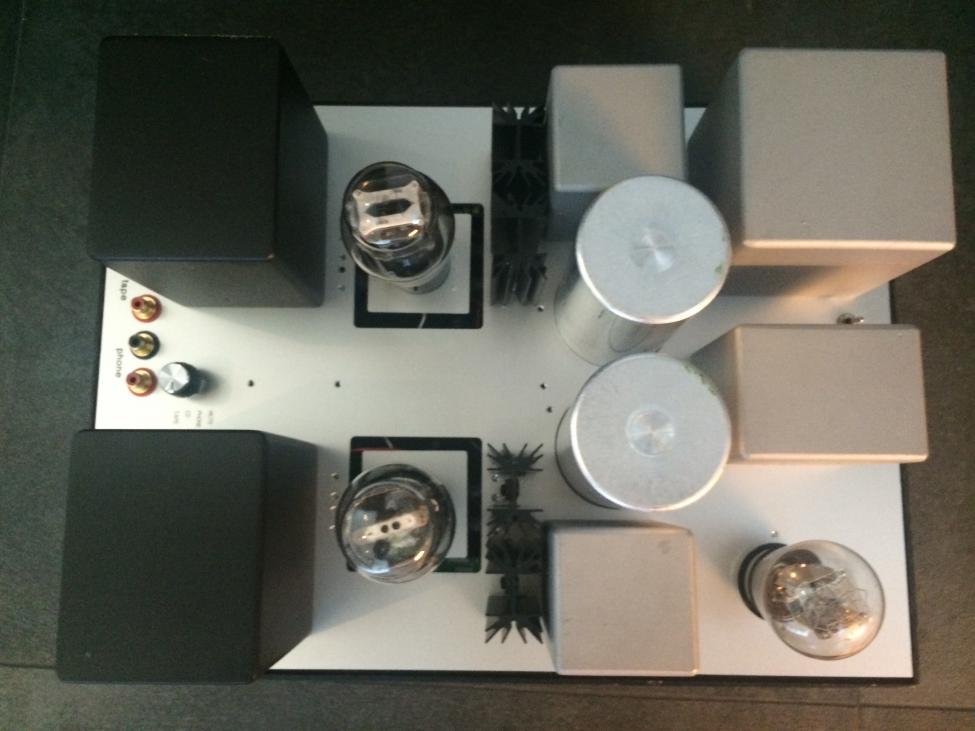

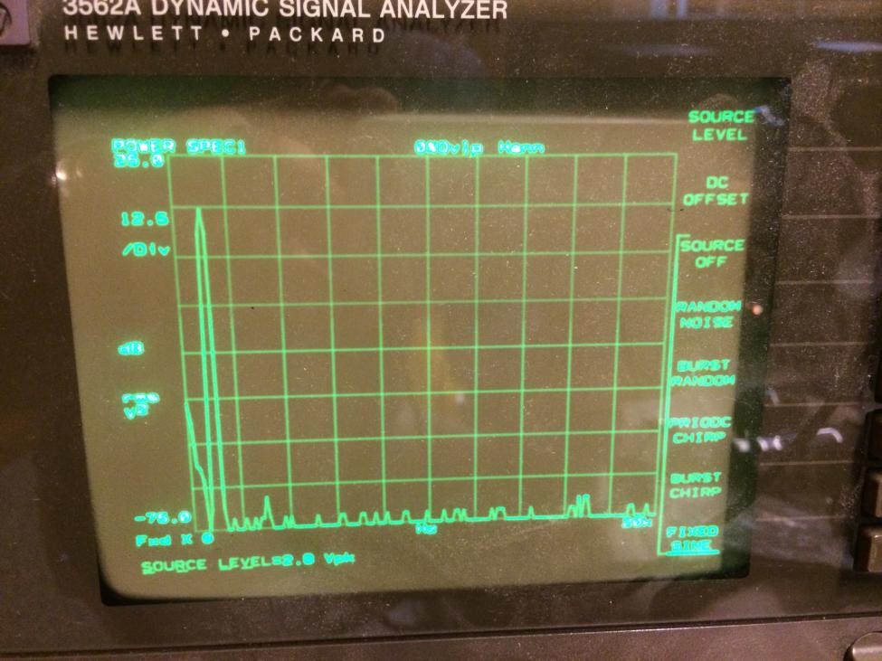

"Yes, we can make the 10 line-stage hum-free now.", Thanks to Rods regulators!!!
This one is "Silent"
(Tribute's irons in psu, and stepdown opt with tapped secondaries for volume control)
Spectrum from output with 2,8v signal in,

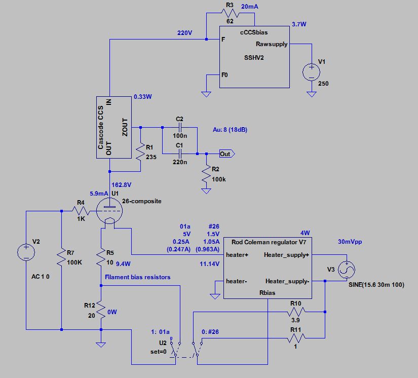

I agree with Ale about the tonality of the 01A. And thanks to Rod you can built now DHTamps/preamps hum free, but most important with no sound degradation. Also thanks to Ale, one can built them at lower cost and great sound using his gen2 gyrator.
I recently built a switchable preamp between 01A and 26. Little mod and 10Y can be used too. The trick is to find the operating point that have the same Ua and switch the Rk and R sense of Coleman.
Hi Radu,
Do you like it? :)
I'm afraid it's a bit more than "little mod". :p

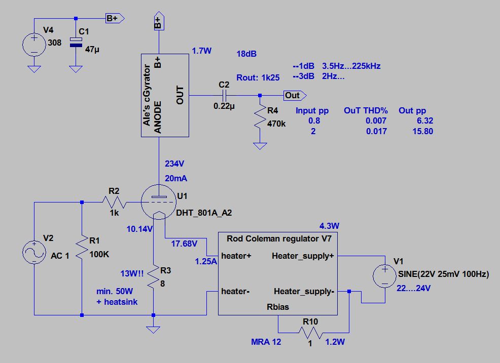

I use my 10/801 preamp with 320-340V B+ (between 260-270V and 25-30mA operating points) and 8R bias resistor.
It's another animal than "low voltage/low current" preamps as 01a or 26.

I do like that I can switch between two wonderful sounding tubes.
Regarding the mods for 10Y: I was thinking more of a lower operating point something like 180V, 15mA, -7V. Then need a little twitch to the Rsense, keep Rk at 7ish ohms and replace 2SK170 with J310. I never tried 10Y as a preamp, so I am not sure that the operating point that I proposed is a good one. Looks good on the paper though.
Radu

I also use in my 801 preamp J310 (and 1kV depletion MOSFET) in Ale's gyrator.
I prefer higher (25-30mA) anode current.
The tone -IMHO- "smoothens" about 25mA (I mainly use graphite anode 801s with moderate -7..8W- dissipation). The "steel" plate tubes (10, 10Y, 801 a etc.) "requires" higher anode current (in my 841-10Y-801a PSE amplifier I use this tubes at 30mA).
In this region -if the tube is in good working condition- the 3th distortion spectrum line is decreasing a little (according to my measurements), second is dominated (at line levels), so overall tone is become cleaner.
It's my experience, in my system, appropriate for my taste, so strongly subjective. :p

I assume it's somewhat like the 26 schematic you posted above, but with different operating points, etc.?
Right.
I'm a lazy man, so rarely make changes in proven solutions. :)
It's a bit oldest schematic (only for simulations). In the reality the B+ and the anode current is a bit higher, so operating point is about 260V/30mA.
I will start soon separated topic as "10/801 preamplifier", where updated schematics -preamp, HT, LT supply etc. and pictures about the constructions) will be shown.
