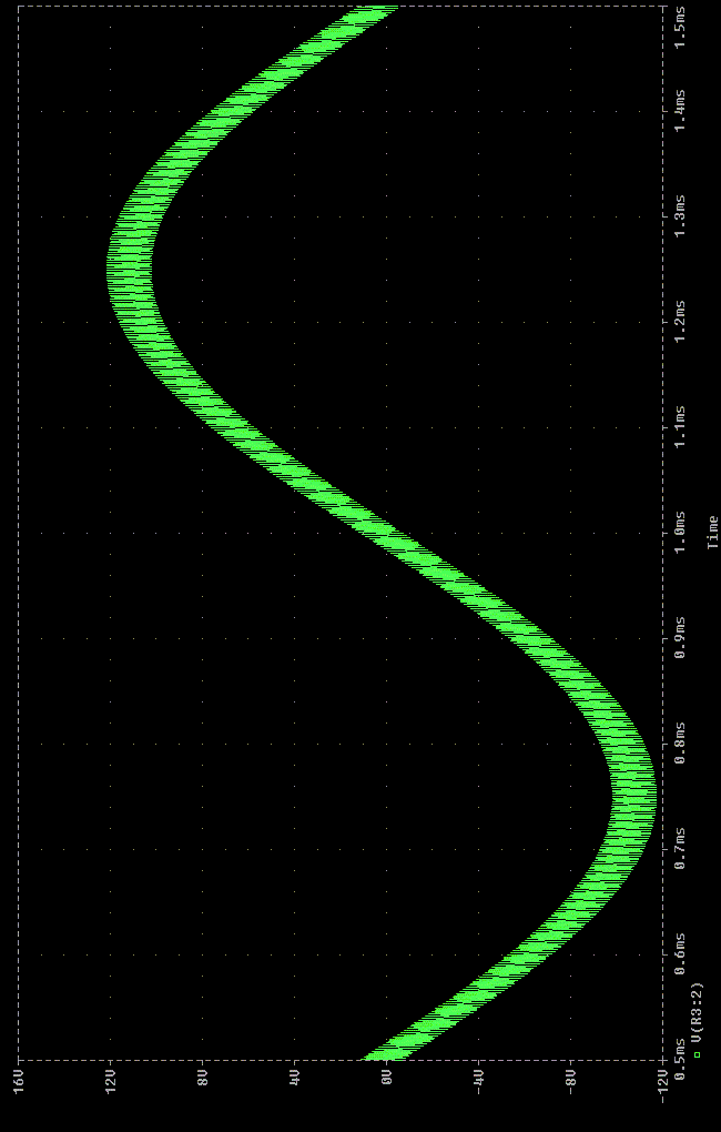

classd4sure said:
Sorry, I'd like to help ya with that but I can't. All I can do is take screenshots with it, if I zoom in enough to see the part values better I'll only be able to get 1/10 the circuit in the screenshot, then I'd have to flood the forum with a bunch of partial circuit badly implemented screenshots ....
you can take a bigger screenshot, zip it, and attach it
you won't be limited by the image size resolution limit
That's how mine simulates. Input signal is about 2 volts. You can see that I also have some offset. I don't think it would be worth to trim around the offset on the simulator. This should be done on a real life circuit. The switching residual is around 1 volt peak. If one wants lower then he has to lower the filter cutoff frequency or increase the switching frequency. Simulated THD is around 0.1 % with k2 dominating and much smaller k3. The rest is way below those two. While the absolute figures aren't that great (I didn't say that it is tweaked for optimum, did I ?), it is basically an optimal THD spectrum.
BTW: This time I used it in non-inverting mode.
Regards
Charles
P.S. if anyone likes to get the .SCH file, drop me a mail.

BTW: I tried to increase NFB by about a factor of five on my posted simulation example and it gave a significant reduction in THD and IMD.
Regards
Charles

on your simulation, what's the DC bias point of the mosfets?
mines (based on your schematic) are dissipating more than 200W idle :(
Ouch :eek:
I didn't pay attention on this one (one nice feature of simulators: nothing explodes even when heavily abused !). I just took some restistor values for the gate-drive without any calculations. I have now decreased the discharging resistor to 1 Ohm and things improved (even THD !). This will still not be optimal (definitely not) but one has to play around with the values anyway.
One cannot talk of DC bias in this case - it is called crossconduction (or shoot through).
If your simulator takes the .sch files from Microsim I could mail you my one.
Regards
Charles

Charles, looks good, lowest I got on mine so far is .2%....I was having many kilowatts shootthrough .....20K.......aaaaaaand....I've decided to abandone the pulse transformer Idea ..(for now) since I was obviously wrong about it not adding much complexity. I still think it would be most worthwhile attempting for an all out power design, but necessary? I doubt it.
So I'll fix my old circuit up a bit and redo what should have been redone a long time ago.
