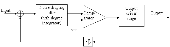

Bricolo said:In fact I asked for a basic schematic. No power/THD defined in it.
For a block schematic, I think the one I'm attaching here is useful.
A first order noise shaping filter (one integrating op-amp) is highly desirable to get good performance over the entire audio frequency range. Higher orders should be even better, but introduce stability problems. (Probably more problems than benefit for us at this point?!?)
The "output driver stage" contains the output filter as well.
By the way, I also like Bruno's idea of separating control/feedback from the output test mule . The first PCB could be constructed with a line somewhere separating the parts, so you can chop off and replace one part later...
If no-one else beats me to it (or protest), I will try to post an Eagle schematic tonight with a few proposals in place - to get something more concrete to discuss around.
Meanwhile, I would very much like to get suggestions on how the output driver stage should be constructed. I am familiar with circuits like IR2110, MAX626, HIP4080, and a few others in the same category. I like the IR2110 for the kind of output stage I have in mind, but I wouldn't mind switching it for some chip with a lower number of pins, a bit higher switching performance, possibly at the expense of lower voltage tolerance. (500V isn't needed here )
Or is the discrete driver from the UCD patent useful? (Haven't simulated/worked on it myself, so I don't know how it performs...)

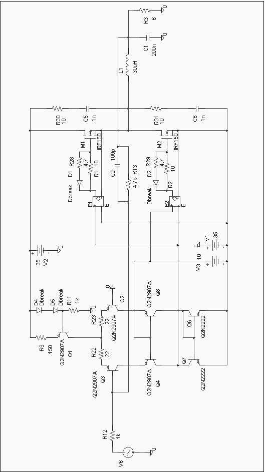

johanps said:
I don't see what causes de self oscillation in this diagram
That's the circuit BTW.
Transistors and FETs are the ones I just had on hand (i.e. my SPICE library). In real life there are of course better suited models available. Gate drivers were modelled as voltage controlled voltage sources.
The dimensioning (and ciruit) does of course leave much room for improvement.

Uups, noticed that the "+" and "-" inputs are not marked on the comparator in that picture.Bricolo said:I don't see what causes de self oscillation in this diagram
Anyway, first ignore the noise shaping aspect (just think "amplification stage"). Then, if the momentaneous voltage on the output is lower than the input (times the feedback factor beta), that difference will be detected by the comparator, causing the output to go "high". This will quickly drive the output to a voltage slightly higher than the input (times beta), and so on... The mean value of the output will track the input. The precision with which it does so depends on the loop delay (i.e. the self-oscillating switching frequency, and the order of the noise shaping filter.

It's the whole smash: L1, C1, C2, R13, R12 plus the time delay from the comparator input to the power stage output.Bricolo said:If I compare your schematic to Johanps's loop.gif, I can't see the noise shaping filter (integrator).
Is it formed by C2 in the feedbacl loop?
JohanPSs loop is what we call a sigmadelta loop. You'll have to rearrange the blocks a bit (split the loop function, take the output halfway and add the input somewhere else) in order to "fit" the UcD schematic into that drawing.
The ingredients are the same but the recipe changes a bit. Or the recipe is the same but the ingredients change? Or both? Uhh never mind.

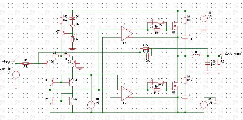

phase_accurate said:That's the circuit BTW.

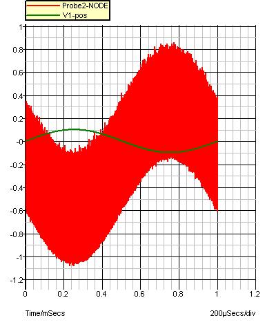

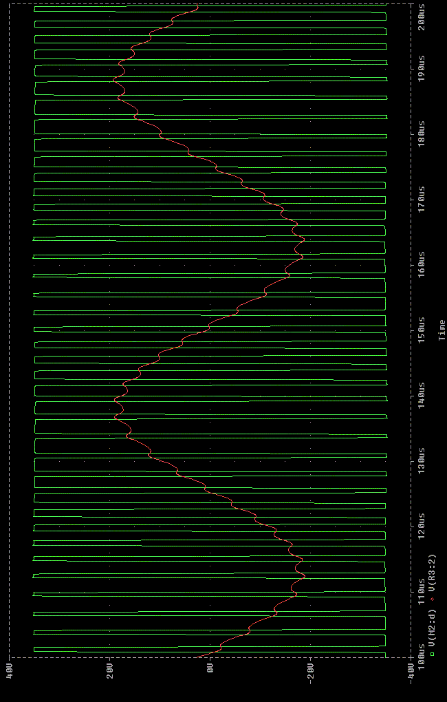

what did I wrong? mine simulates terrible...

Bricolo I can't see why it works at all. hmmm
Charles, how is the upper gate drive signal being level shifted to follow the load voltage in this?
Also, please do me the courtesy of explaining why you mixed the feedback signal with the input? Is that because of the lack of an inverting driver stage so it basically works exactly the same way?
If not I have no clue.
I think when it comes down to it, I prefer using the patended driver over anything like a driver IC. Probably easier to use, faster, just has to be optimised so the gate signals intersect like \/ rather than like /\ to minimise shoot through.
More importantly it demonstrates alot of the proper techniques for a discrete high speed half bridge driver and easily simulates!~
People would learn alot more by using that.
