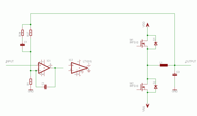

Attached is a small (partial) schematic, intended as a more concrete proposal to stir up some more discussion. (It's embarrassingly incomplete, actually . )
But it does have a first order loop filter (noise shaper), a comparator, output mosfets+filter, and the feedback.
There's a template for a comparator, which should read LT1016 in the picture! That's a very fast comparator; perhaps too fast for our immediate needs, but it has nice complementary outputs. It does require +/-5V (or just +5V/0V), so it's a bit of a hazzle in that way too. If anyone has a another suggestion, feel free to share it...
Whether the output from the op-amp goes to + or - of the comparator depends on whether the following output drive circuit is inverting or not.
Assuming it's OK to use dual positive/negative supplies (Vdd, Vss) with GND in between, the issue is how to drive the mosfet gates, with suitable amplification and level shifting of the comparator output(s).
Chris (classd4sure) suggested AC-coupled gate driving, which would imply using P/N-fets instead of two N-fets. That's actually how I myself have done it before - but I would be very happy to come up with another solution with only N-fets and no AC-coupling on the mosfet gates.
Perhaps using an IR211x-like driver circuit, but with AC-coupled level shifting between the comparator output and the driver circuit?
Or a discrete driver solution similar to the one in the UcD-patent (again with some level shifting needed)?
Or am I completely lost? You tell me! .

No, I have simulated exactly the circuit you have proposed with the LT1016, using AC coupled mosfet drivers as well as low speed optocouplers to prevent latch-up. I bet the low speed optos could even be replaced with 6N137 ones to make it better.
I wonder if high power can be had without mosfet drivers and their high peak current supplying ability and high input impedance. I seem to be in subwoofer drive mode again.

Too fast? No such thing
In my defence (I feel the need), when I had suggested AC coupled I was still thinking of a tape and bubble gum 2 cent circuit that could be wired in under 10 minutes.
If we want a bit more quality...throw that idea right out the window, delay is hell on those, and while it can work I dont' think it's actually intended to provide level shifting so much as a bit of a dc offset for the gate signals to help them turn off.
Have you taken a look at the driver circuit in the UCD patent? Check out the circuit I posted earlier. I haven't seen a simpler , or smarter design, and it can be simulated easily, few parts. If anyone can match that without running to a hip4081 or something like it..then I'd say it's a candidate.
+- rails are easy to do and since I think we're all agreed on a simple op amp comparator it'll make life easy.
In the UCD driver the pnp turn off bjt provides the isolation to the drive signal while isolating Rgs from the turn off current. Hard to beat. The other just operates as a simple switch with baker clamp to avoid saturation.
I'll spill the beans on my other drive circuit later on when I at least have it simulating.
That's an interesting implementation of a second order loop.
Wonder how that would affect the phase shift?

Bricolo said:classd4sure, can you show us a higher resolution pucture of your schematic?
I'd like to simulate it too, so I need a starting point for the values
BTW, I saw no integrator in your schematic. Does this circuit not need one, or did I simply look too fast?
Sorry, I'd like to help ya with that but I can't. All I can do is take screenshots with it, if I zoom in enough to see the part values better I'll only be able to get 1/10 the circuit in the screenshot, then I'd have to flood the forum with a bunch of partial circuit badly implemented screenshots ....
Not my design but I'm fairly certain there's an integrating component in the feedback loop itself, the cap?
See how simple and compact it is? The more you learn about it the more you'll be impressed I promise.
I'm still uncertain as to how the gate drive signals are biased in your design but I'm sure Charles won't mind filling us in.
In spice you can simply the current source above the comparator with an ideal one, as someone already stated I think. One problem I encountered .....is that simply didn't work good? I wasn't able to minimise the dc offset with that.
Now I'm simply using 1 resistor in it's place, and it's working so good I'm wondering if there's a point to using anything more, if it's all powered by the same rails, compliance isn't a factor....might improve supply rejection?
The lower you can take the current to power the comparator the better, I still haven't been able to get it very sensitive to input though, but the DC offset is way down.
The rest of your circuit is fairly ideal so values shouldn't be much of a problem.
