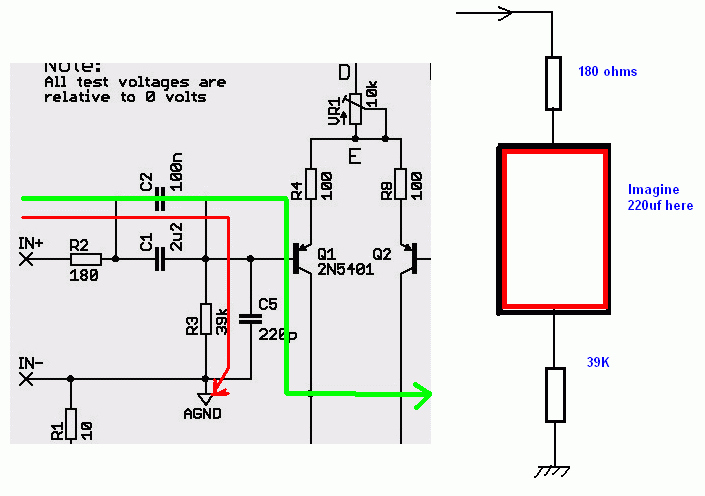

So today I gut the missing Parts for your Dx Standard, the TIP 41/42 and some strange Resister valves like the 82 and 820 Ohm,s and some Elna Audio grade Condensers for the Bootstrap.
For the Input I would use 2,2uF but the lovely Lady in the Store gave my 22uF Bipolar and I donut saw it, bat I have some Elna Silmic 10uF for the Input if dis is Ok for you Carlos.

Hi Dan,
the filters fitted to the input of the power amp must define the passband of the amplifier.
The High Pass filter consists of the DC blocking caps, which can be fitted in the Source and/or in the Power amp, combined with the Rin setting resistor should set the bass response of the amplifier.
If you fit too large a capacitor in this filter then you risk generating an AC voltage across the NFB capacitor creating avoidable distortion and if the PSU capacitance (filter) is set higher than either of the input filter or the NFB filter then you risk LF instability.
Select the correct DC blocking capacitor value to suit what is fitted inside the amplifier (NFB) and PSU.

AndrewT is rigth..better to use the correct parts is you can
But the harm you gonna have with your parts will not destroy the sonics entirelly.... you can use this way for a while till you find the good parts to install.
Try to obbey the schematic values, the resistances and capacitances, to obtain the tested performance all folks that had assembled have obtained.
Do not bother with fashion parts, or silver mica, poliester, black gates or such things..the amplifier can works fine with the parts you find...but obbeying the values suggested into the schematic....if those parts can really reproduce better sound, something i do not believe, will result even better to the equipment to install black gates or something alike..but it is guaranteed nice performance, with delicious sonics, even without those sophisticated, high technologie, mythic or fashion parts.
Fashion and expensive and golden parts will make enormous difference if you believe them...if you believe golden capacitors will reproduce golden plated highs, them use them and you gonna listen this way, as we have our will that controls our brain.

Hallo AndrewT
When I understand you Right then you mean if the Input Filter cutoff is to close or lower then the NFB Filters cutoff then the interactions between them can cause Distortions?

Make sense to me... electrolitics are coiled and use to kill treble
about the MKT i have doubts....but may be an interesting idea to test.
Watch the schematic...observe that the input resistance is in series with the input condenser, and this one is in series with the first transistor base resistance..this is a filter to ground..the biggest the condenser, the smallest will be your treble as the filter will have, alike an enormous throat, to eat your treble, to sent if to ground.
regards,
Carlos
