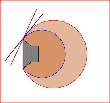

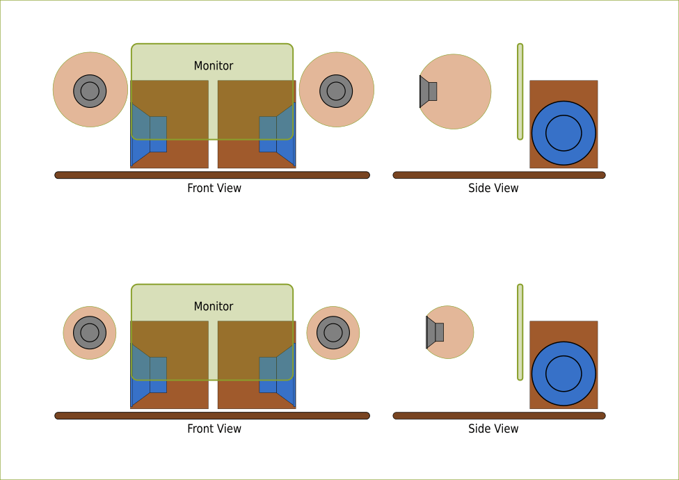

Anyway, to continue thinking about the WAW possibility, a couple of drawings with the two sizes of Ikea bowl:
(the use of a pinkish colour for the spheres might have been unfortunate!)
So really there would be space for either size. The larger one would have a suitable Q for use 'as is', the smaller one would need to be crossed over to a woofer (or EQ'd) due to a somewhat higher peaky Q, BUT is usefully less physically intrusive.
However the bigger one will clearly give a wider, smoother baffle step and WRT edge diffraction its angle with the driver is also noticeably shallower. Probably a similar difference to having one 45-degree bevel or making the same thing from two bevels (each at half the angle), which people report as being similar but distinguishable:
So I still think either would work. Clearly the bigger one would be 'better' from an audio perspective, I just need to try it to see if I can live with such a thing around the desk, or if a smaller one would be noticeably preferable in a usability sense.
As an aside, both sizes of bowl are also small enough in depth for having the woofers directly behind (and somewhat below) them; i.e. facing forward rather than to the sides. Not a biggie, but might be more sensible given that a single (rather than dual opposing) woofer per side is being used.

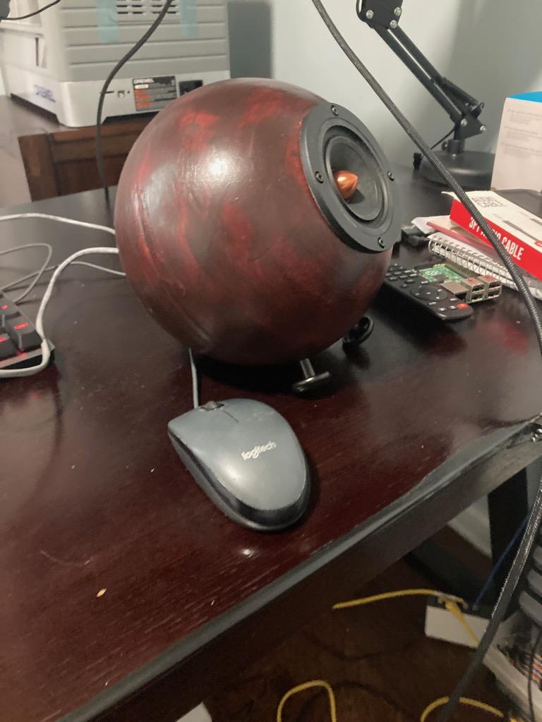

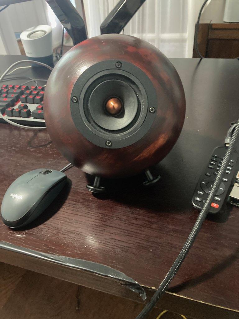

Just did my first speaker using the ikea bowls. Not really happy with the finish and I made a lot of mistakes. About to build the second one but this time I want to use a router to sink the driver. Im using a full range driver Dayton Audio 'PS95-8 3-1/2" Point Source Full-Range Driver'.
Reactions: 1 user
Looks quite successful for a first attempt. It is the nature of what we hobbyists do, very often the things we build are also their own first prototype. So it is quite common to finish and then wish one had made a few different choices. I think it is partly why people endlessly tweak things, go on to later make an improved MKII, or even change their mind and make a quite different version.
It was a good idea to make one speaker before the other, so that you can make changes and improvements on the second one. Personally I would not change or replace the first one until I had listened to them as a pair for quite a while. To see if they sound right and if their character suits you, before making any decisions about what to do next.
