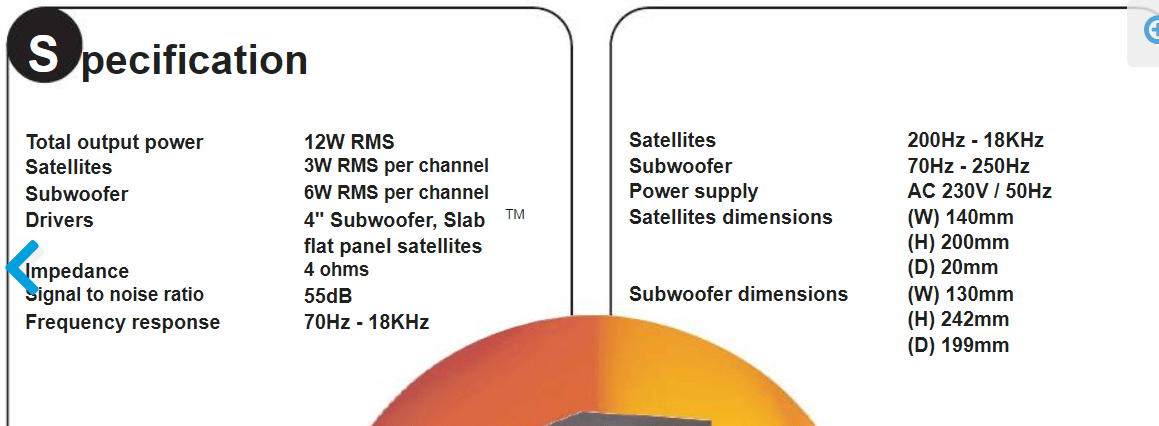

Interesting. I had never known or thought that a cheap set of computer speakers will use DML technology. Below are the specifications, pulled from its manual Packard Bell Model FPS100
Satellites are crossed at 200Hz, which aligns with the experience of DML users on the forum (they can't do bass too well).
That SNR though.
I'd like to see somebody try and replicate this, but better, utilizing modern construction methods and understanding

LOL I don't know about understanding but I'll give it a go. The speakers don't sound too bad but the amp is very poor. Tone is set via a woofer volume control. It clips and I suspect the unit is meant to sound boomy. I can test the panels on their own. That gives some idea what a panel of that size, aspect ratio and wattage can do. Other sizes etc will need constructing from scratch but at least I have a guide of sorts.I'd like to see somebody try and replicate this, but better, utilizing modern construction methods and understanding
Unlike most of the people in the dml thread I do feel it's worth looking at commercially produced ones when I can. Not that there is anything revolutionary about these.

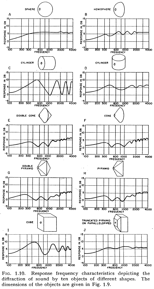

Thanks, yes I will probably use some other shape in the final thing. It is very likely to be round or spherical, though if my wish for a tapering cone shaped rear enclosure comes to fuition that might be triangular; if so I might make the front baffle respect it in some way just to be a bit different.I would not put a speaker in the center of a square box for the main monitors. The response will be dreadful.
You can fire the woofers upwards if cabinets are too close to the sides of your workstation, but then they are open to people placing drinks on the woofer.
Though this won't be a flat baffle, it'll be significantly radiussed or have big chamfers. I'm sure people have seen the classic work by Olson. This is a version that Planet10 posted:
When the baffle edges are removed enough to make a truncated pyramid, a square box is almost as good as a sphere. Though IMO one mistake lots of people make with this is scale; the driver needs to be relatively small in relation to the baffle shape for it to work this well (cramming a speaker into a sphere that is little bigger than its diameter isn't the same). I'm a little constrained on that, but at least a well rounded baffle shape is looking safest at the moment.
