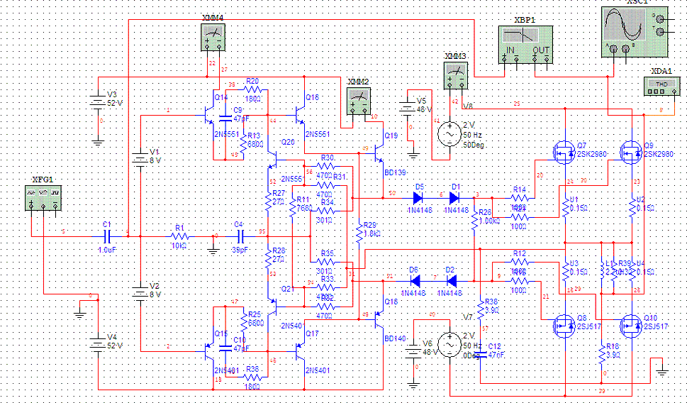

I tried measuring the prototype today, and ended up with slightly worse distorsion figures than before I implemented the EC network. Second harmonic was at -77 dB at 10 watts into 4 ohms resistive load and 150 mA idle.
Increasing the idle radically reduced the distorsion, I had no problems reaching -85 dB at about 300 mA idle. But the thing is, the amp was slightly better before! So I assume the EC network may still be "operating" outside its good range.
I measured 3,3 volts between the gates, and the zener at the input is now 16 volts instead of 22 volts.
I put 500 ohm trimmers in place of R34 and R35 in my schematic to be able to adjust the feedback. Turning these trimmers didn´t affect the distorsion at all, but the idle slightly. So something is still wrong, but I can´t figure out what until I have some time to simulate the thing again.
/Rikard

I ran this in the sim, it works perfectly! Note, this is of course only the output. I can adjust the values of R34 and R35 for minimum distorsion, and the values are quite critical. 20 ohms in either direction immediately shows up as distorsion. I managed to get a simulated distorsion as low as 0.003% !So the EC network should be in the correct operating area with these values. Only thing is I don´t know how close the FETs are to the 2SJ201/2SK1530 ones.I´ll tweak the values in my prototype and try again. I do have another one so I could build the EC once again if I did mess something up now.
And here is the complete amp with VAS. I use boosted rails in the prototype, filtered through "gyrators". Works ok. In the sim I added 2 volts of 50 Hz AC at the final rails to simulate ripple. Seems to be unaffected by this amount. Had to zip the picture since it is too wide to upload.
I tried cascoding the predrivers Q1 and Q2, but could not get rid of oscillating.
Lets here what you think guys!
Complete amplifier with VAS
... except for the input section .. it is complete
Made my head go crazy for a while

Thanks, maybe someone can solve the problem with cascoding Q1 and Q2. I tried adding a transistor to each of them connecting the base to the base of Q11 and Q12 resp since these nodes have a constant voltage in respect to the rails. The bandwidth increases a lot, but after a few cycles it gets unstable. Didn´t help adding freq compensation at the FET gates. Don´t think that is where is oscillates. Tried a small feedback cap from the cascode output back to the inverting input of the diff amp as well, but still oscillates. Removing the extra transistors makes everything stable, and as it seems to perform well maybe I will just leave it this way.
If somebody have good EWB models for the 2SJ201/2SC1530 I would be thrilled!

cascoding and get unstable
try a bit more compensation capacitance: C-dom
because when cascoding I think the amplifier get a changed open loop bandwidth
just a guess
Just have to get the thing working in practice too.....
see this post
and also the post BEFORE & AFTER in the Spice Simulation thread:
http://www.diyaudio.com/forums/showthread.php?postid=1255538#post1255538
Bob Cordell was also annoyed, after contacting Hitachi to get those models

frankly, I am having considerable difficulties finding anything I like about this design. The correction occurs over many stages and unlinear diodes strongly reducing its accuracy, on the whole probably doing more damage than good. Numerous other topological annoyances and massive negative feedback effects will keep the subjective qualities at a less than mediocre level.
i kind of ran out of time this morning as i had to leave for work, but i was going to mention that with triples, EF is the type that has high Miller capacitance, but CFP puts the Miller (of the output devices) capacitance in series with the load, rather than in parallel as the EF does. with the output device capacitance in series with the load, rather than in parallel, the amp will be easier to stabilize with capacitive loads.
- Designing amp with 2SJ201/2SK1530
