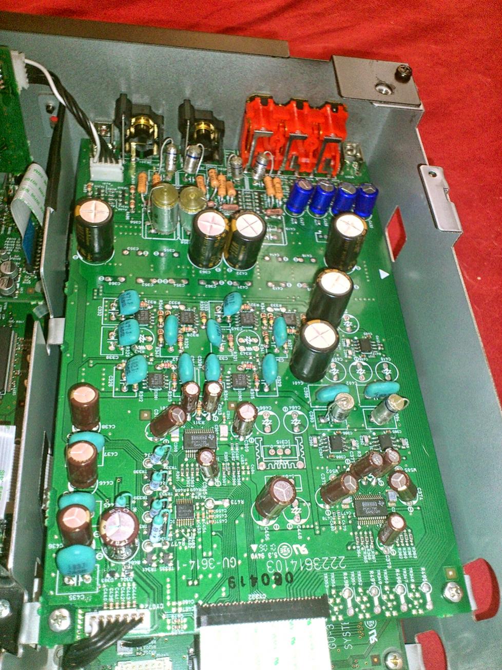

denon dvd-3910 service manual ?
I think replaces all film capacitors

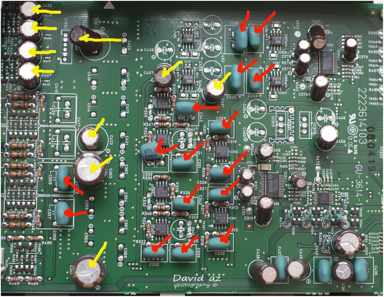

I also buy at the end 14 electrolyte capacitors of
NICHICON - UKZ1H101MHM1 -100uf 50v
Meanwhile I leave the capacitors of the original 18NF
I hope that after I replace 40 parts
The sound will be worth the effort :)
A week and a half until the parts arrive

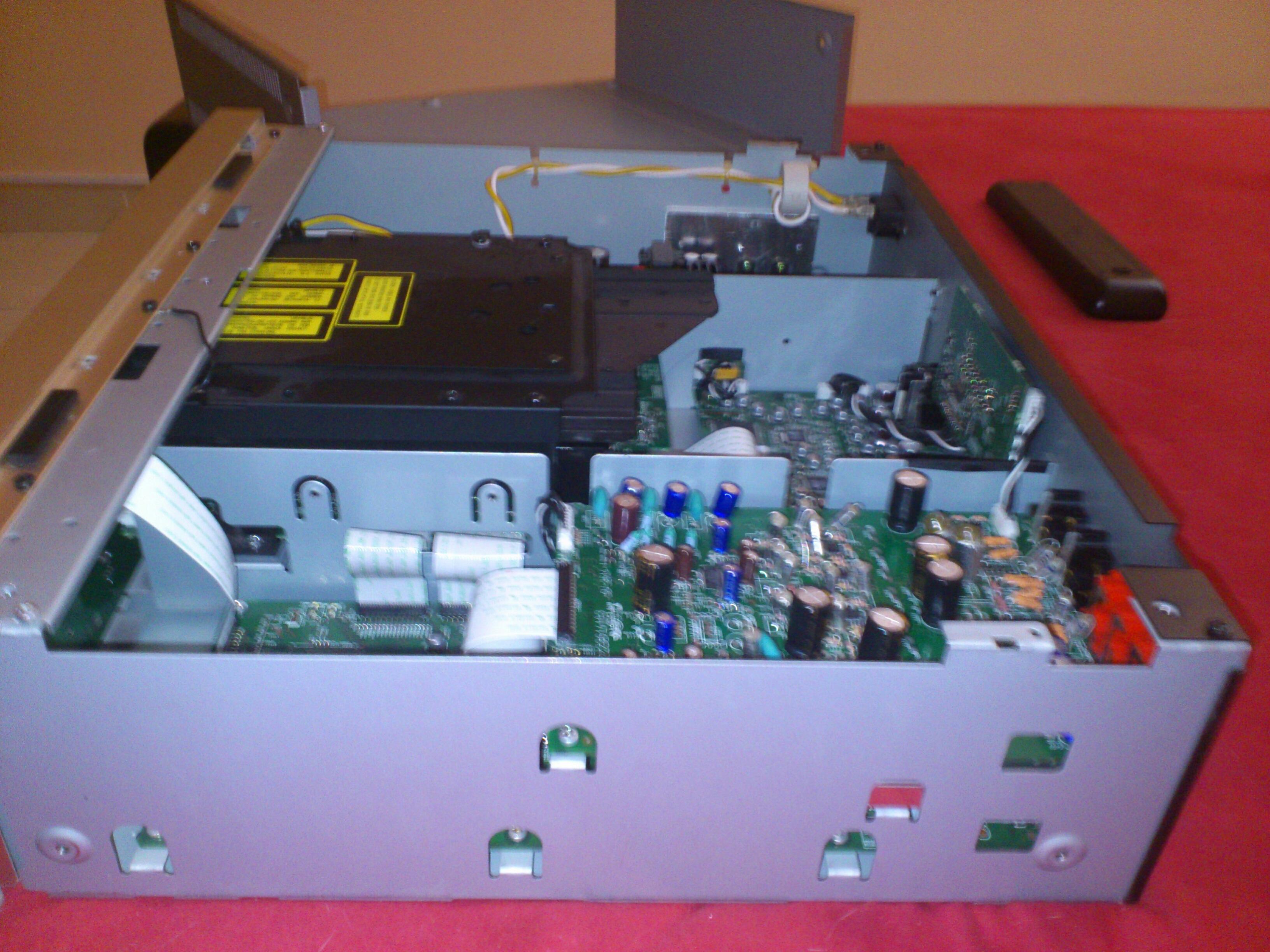

i bought All equipment for the project :)

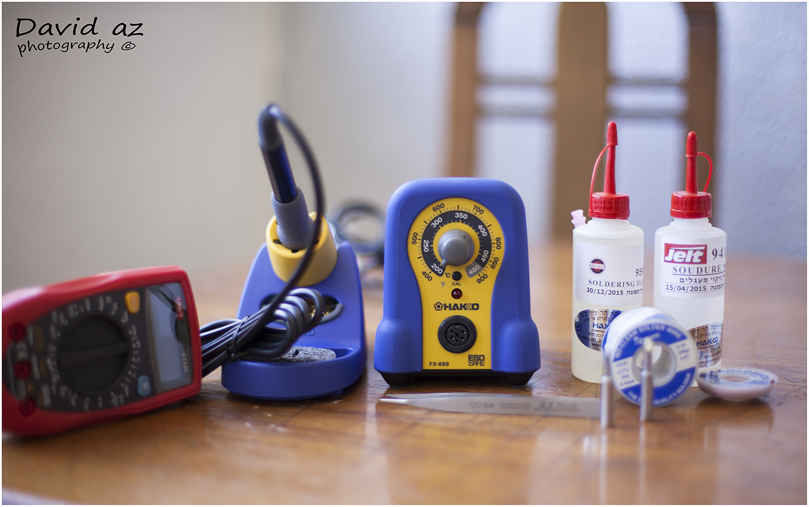

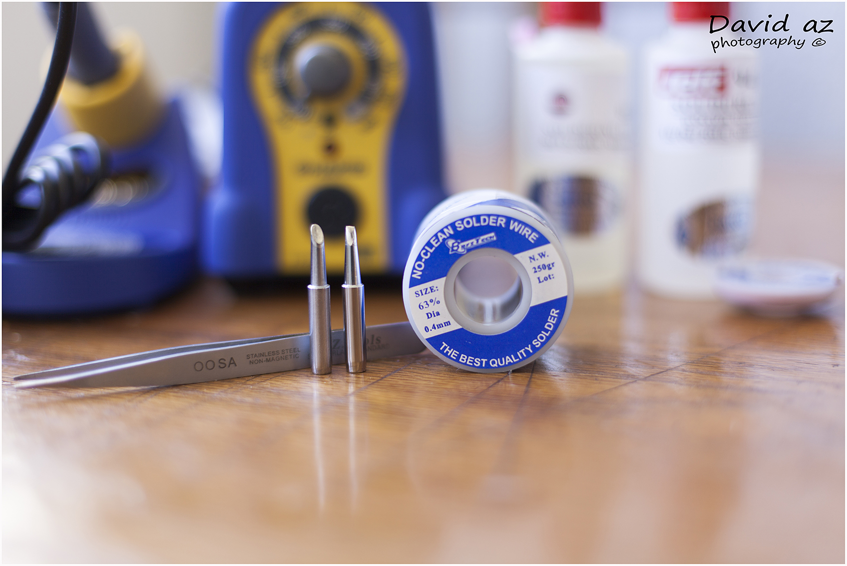

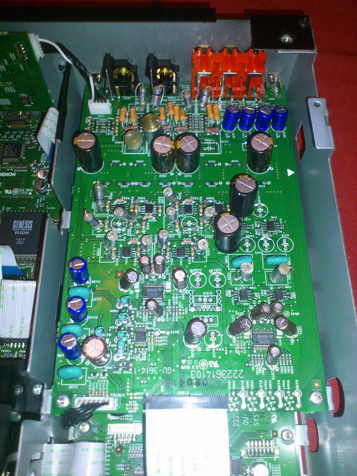

I finally finished the project improved audio circuit
The DENON DVD 3910
How to replace the 60 parts

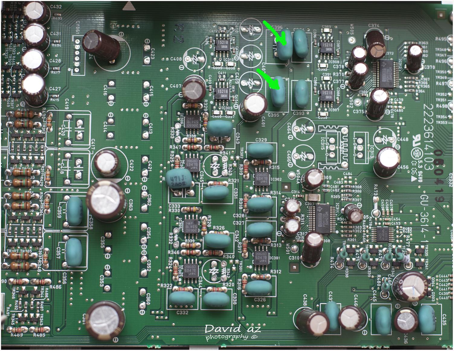

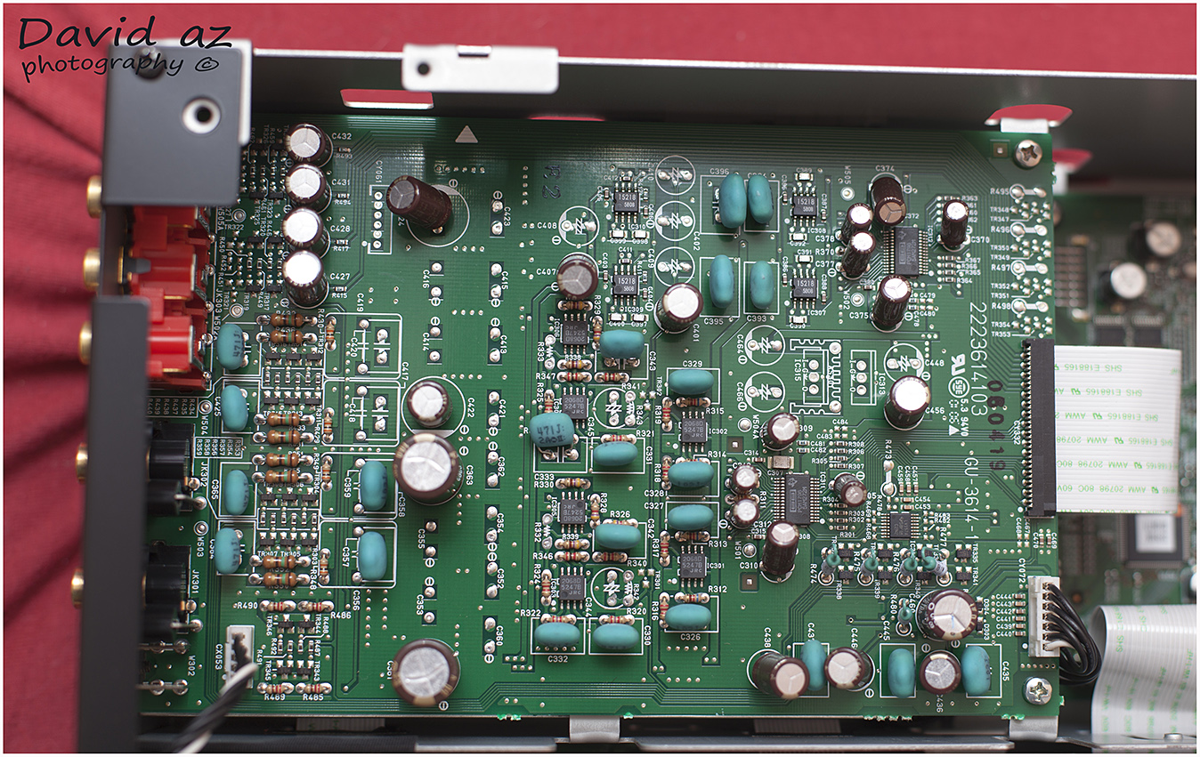

Photo before and after(With this signature before)
Now he goes BURN IN
100 hours
But for starters I can tell
The sound has become much more accurate
High frequencies Snmaim much clearer
And the sound stage is much greater

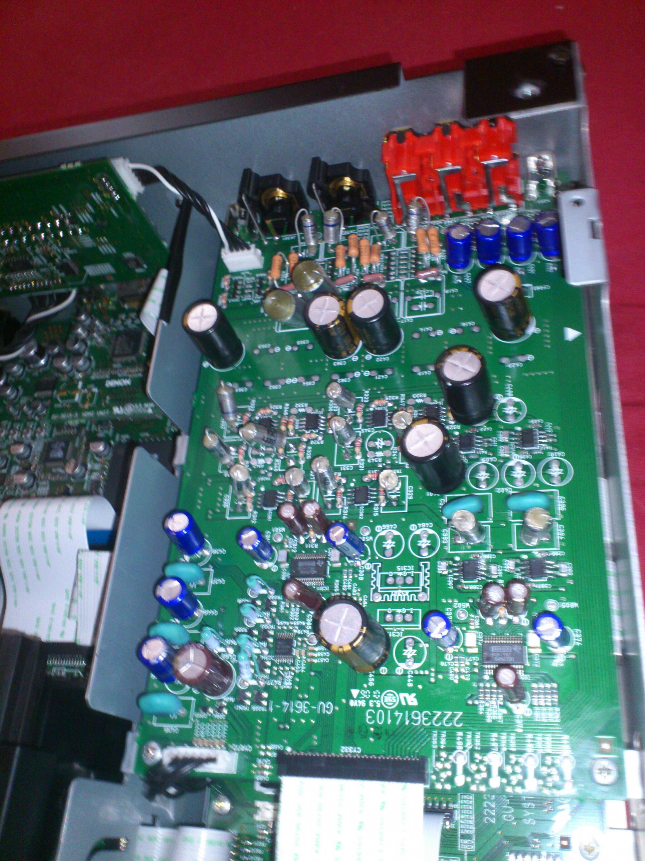

Remember we talked so what OP AMP responsible stereo?
i learn from Mistake of installing OP AMP
STERIO OP AMP are C301.C302.C.303.304.C305.306
At first I changed as you recommendations the OP AMP C307-C310
I did not hear a difference
So I started to replace the OP AMPS C301-C306
When I hooked it did not sound testing
On the left
I checked what the problem OP AMP C305
Was not installed good
I fixed it
And now everything works perfect
ׂ( Before you say
The device is set
SOURCE DIRECT-ON in the menu )
So two stereo channels autput op-amp is C301-C306 100%
Learn from mistakes lol ;)
It was a lot of work
I changed about 60 parts
10 OP AMP
14 resistors
and most
Film Capacitors
Electrolyte capacitors
