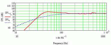

Sorry -missed it. OK, Dimitri with B20s? See attached FR. Now, normally I wouldn't advise building something like this for obvious reasons -it's going to be overpowering in the LF. However, one of MathCad's limitations is that it can't properly account for the vent aspect ratio, which in the case of the Monolith cabinets (mental memo: must design one for something with the 1:4:9 proportions of the 2001: A Space Odyssey Monolith) is very high. You can expect some LF losses due to this, which should, unless I'm very much mistaken, bring it near flat. You can tune them anyway by adding some reticulated foam in the vent to make a quasi-aperiodic cabinet, or at least a damped vent box.
As for what they'd sound like compared to the Half Changs, like I said elsewhere on a similar topic, its a bit like comparing hippos to rhinos. Same driver, completely different types of cabinet, in this case an ML-V / ML TQWT against a BVR. The latter will give a larger scale presentation as it's coupled to a lot more air. The former should have the classic WB sound, which is known for having similar traits to a bipole, and work nicely up against a wall too, which is what they're designed for.
Thanks for the information Scott! I really appreciate you and everyone else's patience in trying to find the enclosure that suits my needs, a little extra LF won't bother me much as I love bass! I'm sure I can cure it with a little more stuffing if it is too much though...

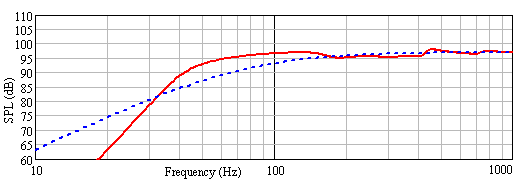

Scottmoose said:Roughly 48in x 21in x 5.5in (HxWxD). 4 FE127E drivers, run bipole, two on the front, two on the rear baffle, with an FT17 supertweeter crossed in. We haven't decided on the XO point yet.
circa 14 - 16K ?
How about FE126 with appropriate series R?
From my brief audition interuptus with Brynn last weekend (hopefully to be consummated this weekend, along with first session with the Bamboo Fonkens), once you control some of the aggressive upper midrange of the 126 with EnABL and other majikul tweaks, there is certainly an extra degree of dynamic "jump" over the FE127.
With 4 of them (126) in one box, I'd imagine that the X-max limitations that some worry about would be substantially mitigated - and for folks with a Decware Zen amp, the 2ohm load with drivers wired in parallel could be "velly ineresting"
just a thought

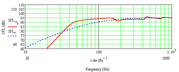

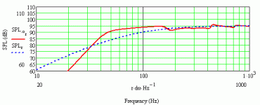

Good idea. 5ohms series resistance does it for the 126 and there aren't any Xmax issues to worry about in the nearfield with four of them, providing insane SPLs aren't needed.
BTW -forgot to mention, the drivers for the sim are assumed as being in two pairs, each pair wired in series, then the two pairs paralled.
With the XO, I reckon we can be fairly flexible. We should be able to keep it clear & out of the telephone band, so it's really selecting the point at which the output from the drivers starts to comb.

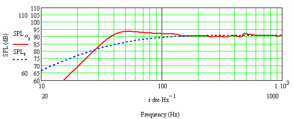

Thought you guys might fancy a sneak preview of this -I sent the preliminary data to Dave earlier for QC & assessment. This is for dedicated 2001: A Space Odyssey fans. Or those who like both the aesthetic & bass.
It's a 6ft tall MLTL with perfect 1:4:9 proportions. Initial concept uses two 8in Pioneer drivers, plus tweeter / supertweeter with a variety of possible configurations, and will give solid performance down into the 20Hz regions. Upgrades to Fostex and / or hemp drivers should be possible with minor modifications. Polished satin black finish is prefered, though if you're able to make it out of clear perspex or glass, that would be fine too.
You'd need another pair -the volume is too much for a single unit. This is where we're moving into the realms of seriously large cabinets: FYI, external dimensions are 72in x 32in x 8in (HxWxD). Each. So a big room is fairly mandatory, or these huge slabs will dominate the space like little else.
