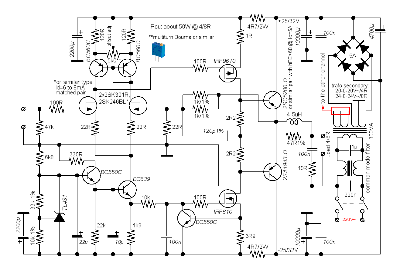

Because I received a lot of PMs regarding this project...
Due to the engagement with my work (yes, the money is not
a good thing, but still works when you need to buy some stuff),
I don't have enough time to spend it with my hobbies. The other
reason is that I already moved to the vacuum team. It is simpler
and long time short circuit at the output is not a big deal at all :D
Attached is the schematic of DoGC with some little improvements.
Will try to test the offset stability at different ambient temps and
will report the results here ASAP. Thank you!

@metal
I think you are a little too much questioning this circuit.
It has several interesting parts.
And my opinion it is rather simple.
We can not make too simple if we want a good amplifier.
