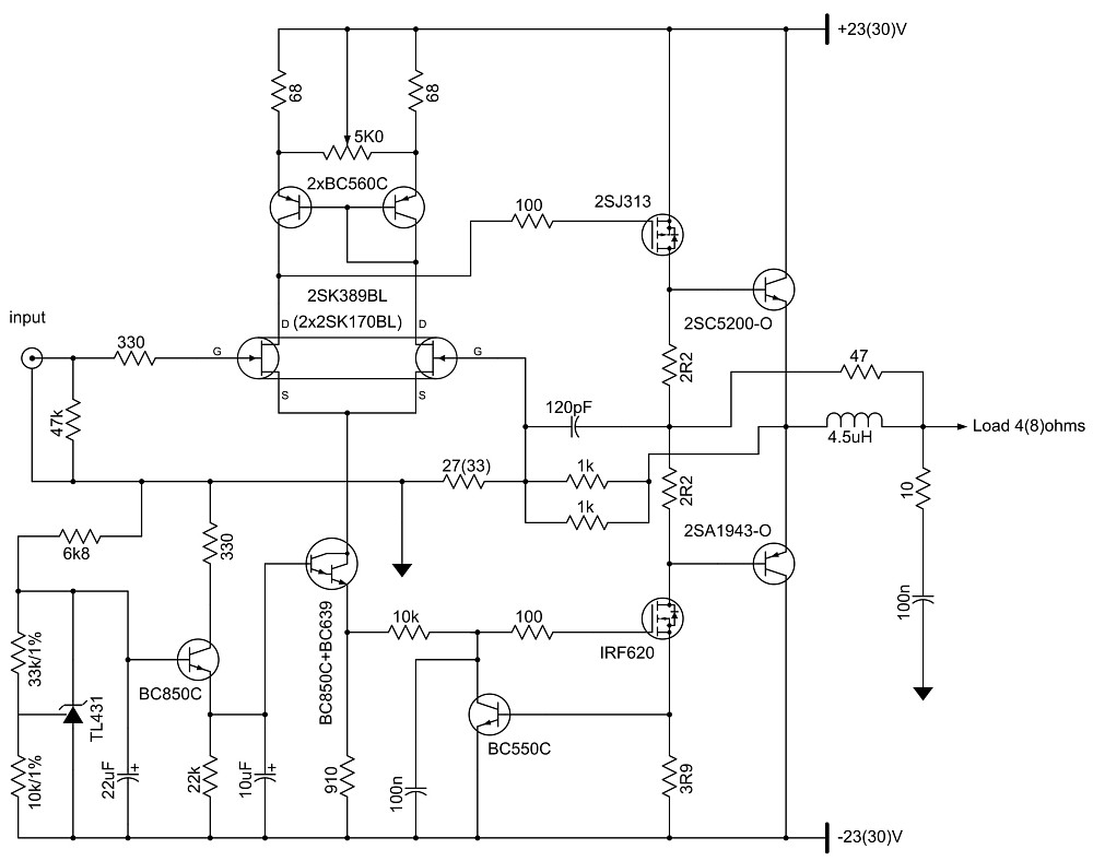

abpea said:Hi Guys,
I'm building the current version of Bora's amp (post #314 above) but don't have a power supply yet. Can someone recommend a nice regulated shunt ps I could use with this amp?
Thanks -
Bruce

It is possible, offset is floating approx. +/- 20-30mV
Current source for IRF620 is unstable "upside down", wich compensate instability of diff. input stage...
Carefully look at schematic - there are transistors after shunt regulator 431, and "strong point" for 620 is emmiter of CS for Diff. stage.
I have score of amps, no problems with offset.

Bias current for 9610 is higher than necessary (in this case), so unstability is not much important value...
Output transistors ("dumpers") are near class B - approx. 320-350mV Ube (depending on temperature range).
This is a feedforward error correction amp.
Dumpers originally working without idle current.
Is it possible to get thermal stability without any emitter resistors at the output stage?

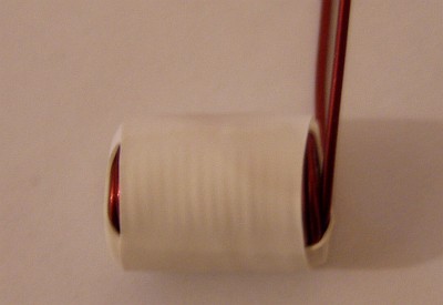

Kolega, haresva mi usilvatelq - slushah go v edin priqtel, no iskam samo da otbeleja...na kartinkata za izhodqshtite droseli pishe (0.86 with lack isolation) ... lack na angliiski oznachava lipsa na neshto i edva li horata sa razbrali kakvo se ima vpredvid, spored men po-dobre za lakovata izolaciq e da se izpolzva varnish. S netyrpenie chakame pdf-a na platkata, za da izprobvame i pravotokovata versiq.
