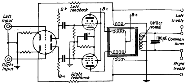

Hi Piergiorgio
I've digged a bit around your idea, trying to design the OPT.
At first, it seems that 1000 turns on an 1sqi is a bit optimistic and I had to go up to near 1700 turns to keep AC induction below 1.2 tesla for 25Hz at 8W. This using a 7.2cm² core (EI84A), M6X grade iron.
It remains acceptably small and provides some extra space in the copper window to accept the "DC cancel" winding.
For now, my guesses are:
4 primary sections, each in four layers of 103 turns, wire dia 0.28mm.
All in serie, 80 Ohms DCR, 160Hy ( ! ! )
Interleaved with 5 secondaries, each in one layer of 84 turns each, wire dia 0.4mm, all in paralell, 0.4 Ohms DCR.
The thickness of insulation at primary to secondary boudaries being 0.3mm.
Estimated leak inductance in the 5Hy range.
Above that, the DC cancel winding, 1648 turns wire dia 0.2mm, some 170 Ohms DCR.
There is less than 160v rms accross it, so no special insulation need to be inserted between layers.
Well, all that to check if the OPT was feasible, I think it is.
Not yet worked on the choke.
And after that, perhaps a full prototype ?
Yves.

Smoking-amp:
I'm playing with vizimag to see the fields on some geometries. Maybe yours idea of rolling togheter a soft magnetic sheed and a magnet can work. My guess is the rubber magnet are not strenght enough and has too low coercitive field.
Better is to roll togheter two sheet one of soft iron and the other of some hard magnetizable medium and after winding the coils magnetize the hard magnetic material. I do not Know how to magnetize it in the radial direction.
Yves:
I think that this arrangement (Farber modified) is worthing most for low plate resistance high current tubes, I'm thinking on a 6080PSE. True that the simulation is not considering the flux level (actiually was 1 squared cm, not inch!), but just the inductance.
Yes, I think a test bed for this solution can be a good experiment.

Ring magnetic compensated core
I see a bigger problem: because the magnetization of PM sheet is radila, the flux in two adjacent soft magnetic sheet is opposite, so half the core is prepolarized in one direction and the other half at the contrary. Because turns are wind over both the core, half of it will be forced in saturation.
See this schetch:
See this schetch:

Hi Dave,
Looks like something could be put together. Thanks for the info. I just was throwing my $.02 cents in on this idea originally. I haven't even built a SE amplifier yet! If you guys want to pursue this thats fine with me (just cut me in on the patent too! but maybe better to just leave as public domain?) Would need to put a bit of money and effort into this to get it rolling I think. Then some tests to see how it performs and probably a few iterations back to the magnetics construction to get all the kinks out. I'd be happy to help out if needed. This is something one would pursue to get a manufacturable product. But is massive overkill for just a simple DIY project. A potential pitfall is if the magnetics drift in strength over time. This could end up requiring a complex control system to keep it tuned up. Just don't know until after you spend all the money on it.
As far as a DIY project to just build a SE amplifier with flux cancelation, I think there are easier ways than all this magnetics development. An idea I came up with recently is as follows.
The easiest way to do flux cancelation is to just use an extra inductor or current source in the various schematics mentioned. The current source is attractive due to its lower cost, but is a big waster of power. Fortunately there are some ways to build an efficient current source.
Using a Mosfet with a small ferrite inductor (air gapped) in series with its Drain output, we could use a PWM (pulse width modulation) chip to switch it at high frequency (say 100 KHz) to produce a regulated average current. Current sensing in either a source resistor or a current xfmr. provides feedback to the chip for average current control. A series resonant LC trap to ground (or B+) after the ferrite inductor (ie at the current source output) would be used to remove the switching frequency residuals before connecting to the SE tube amplifier. The Mosfet would have to be able to handle the plate voltage swings from the amplifier but would dissipate little power since it is either totally on or totally off.
No doubt some tubies will not like digital stuff going on though. One could clean this scheme up a bit by using a (say 100 KHz) carrier sine wave instead of PWM. And controlling for average current by DC bias of the Mosfet. The filter would then do a better job of cleaning up the output without any extraneous EMI generation. Wouldn't be quite as efficient as the PWM square wave, but still could be pretty good.
I myself lean toward the three channel (L, R, -L-R ) SE system with just a simple DC voltage controlled series bucking coil system (AC signals sum up to cancel out of the bucking voltage). This is a nice and simple scheme that adds a center channel which some people have liked for sound or can just ignore the L+R output.
A very, very interesting variation on this would be to use a single E-I core xfmr to do all 3 outputs on one xfmr. The L and R signals would use primary windings on the outer two legs of the E and the -L-R signal (with doubled DC bias) would use the center leg. The AC signals sum up correctly so no conflict in flux around the core occurs. The DC bias currents on the other hand cancel out, so no need for even the bucking windings. All automatic DC flux cancellation. Neat. Getting three outputs from one xfmr. looks pretty attractive to me (put secondaries over the primaries on each leg). This should make a good DIY project I think. Call it the "something for nothing" SE circuit! (in reality the three legs do have DC currents in them, but they all sum to give a N pole on the top of the xfmr. and a S pole on the bottom of the xfmr. The huge air gap from top to bottom of the xfmr thru the surrounding air forms the usual SE gap for limiting DC flux, and boy it will be limited with that big a gap. Hence, something for nothing.)
Don

Just for completeness, our old buddy Norm Crowhurst came up with a design for a stereo SE amp using a single output transformer. The OT offered DC cancelation in the core and a third channel of output. Norm's design uses leakage inductance to form a simple crossover so that the center channel is bass only, while the L and R channels deliver the mid and high frequencies. He does point out that there's no reason the L and R channels can't be full-range.
Norman H. Crowhurst, "A New Stereophonic Amplifier," IRE Transactions On Audio, May-June 1961, p 66-72
Hi Dave C.,
Norman's design is using the leakage reactance of the xfmr to provide separation of the treble between the two channels. Only working for the treble since the leakage reactance is small compared to the individual primary reactances. His bass winding is picking up the common part of the signal between the two channels.
There's another design around too that gets two true isolated channels out of one transformer, don't know what its called off hand.
The "something for nothing" design uses the third leg of the E core with -L-R signal drive to provide complete and full bandwidth isolation between channels. The "something for nothing" design does use the leakage reactance for isolation between P-P mode and SE mode in a similar manner however. Adding an extra inductor (or high Z pentode drive) in the -L-R drive allows this leakage reactance to be set to a larger value effectively since flux can then "leak" thru the third leg of the E.
Just a note on the triode drive on one side and pentode drive on the other side of a P-P xfmr idea for DC compensated SE idea. The pentode needs to have linear transconductance (and equal to the triode's at idle) in order to not distort the triode's control of voltage. This means either putting a degeneration resistor in the pentode's cathode or using a vacuum tube current mirror drive for it. (predistortion by shunt diode followed by 3/2 power gm of the pentode) see:
http://www.diyaudio.com/forums/showthread.php?s=&threadid=40595&highlight=
Don
Don
