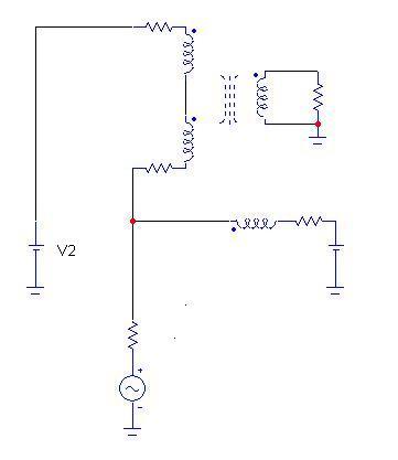

Hi
It appears topologically similar to the following
(apart from the use of CCS)
and it is a parafeed.
hint: substitute V2 with a capacitor.
Federico
Here is a sort of brute way of compensate for any DC in the transformer primary.
Federico

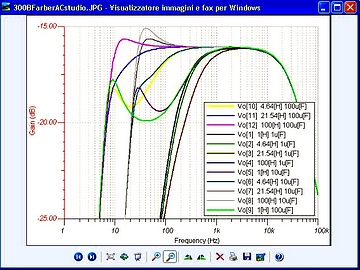

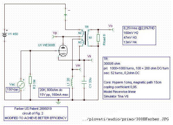

Farber inductor version simulation
Just a little bit of playing with Spice. A little modification , combined Fig1 and Fig.3, one can obtain this circuit that give 8W at 2% THD with only 1 square cm section of iron and 1000 turns.
The 20H inductance works also as cathode resistor, and dissipated quite a lot of heat but can be large and there is no insulation (works at only 15V) to worry about.
I assumed an aux winding made of half the section of the main coil.
Not bad, for such a small iron.
Re: Farber inductor version simulation
Tell me if I fail.
The cathode is AC grounded, so just the DC current flows trought the transfo and the choke wich voids shortening AC.
Due to the direction of windings, reducing the value of the cathode bypass capacitor sould introduce some POSITIVE feed back at the low of the spectrum. ... I bet
Could you simulate that "big boom boom" behaviour ?
<edit>
At second thought, the choke comes in parallel with the auxiliary winding and, as so, short it at low end, BUT the cap does exactly the inverse effect.
Perhaps a "certain" value of the cap could compensate for a "certain" value of the choke

Yes, the value I posted for C and L are what after few trial give a good flat response.
Tweaking the value of C there is a bass boosting due to a combination of lack of AC grounding and the resonance of LC tank.
It is easy possible to go down to few Hz of power bandwidth but appears a bad ripple. Tweaking both L and C can be found some satisfatory response.
The question is: this arrangement can have some advantage over the common parafeed? Maybe less requirement of high Q inductor, less isolation for the same, low voltage cap.

Great results indeed.
The dark side is that the total amount of iron (choke + tranny) will probably be the same that with the "gap" method.
Nevertheless the tweaking between L and C open a wide an intriging path, I like that !
Yves.
