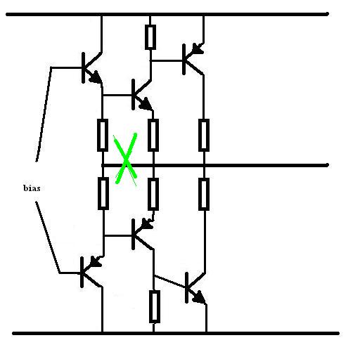

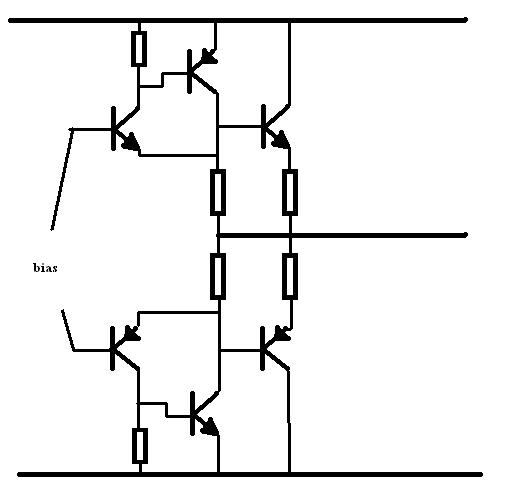

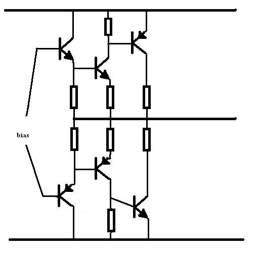

the main idea is like thisthanh said:can anyone know about "triple output"? it's not triple darington
Look like a better idea, and I imagine would have better voltage swing than darlington.
Would this be a hard arrangement to bias?
EWorkshop1708 said:Would this be a hard arrangement to bias?
its easy to bias but oscilation will be a problem . i saw few designs with this arrengement .if u will be able to stabilize it then the distortion figures will be much better then tripple darlington
Doug Self classified the ClassB output stage distortion into 3.
1. LSN (Large Signal Nonlinearities) occurs with BJT because they cannot maintain HFE with large output have to be delivered to the speakers. HFE fluctuation---distortion.
2. Crossover distortion. Happening when NPN ends working and giving task to PNP for reproducing signal.
3. Turn-off distortion. He said this distortion is helped a little in EF double follower, but cannot be eliminated in CFP output stage.
No.1 and 2. I could imagine. But I do not understand no.3. What is Turn-off distortion? Transistors have tobe turned off fast enough so it dont give distortion? Isn't that in class AB we try to have no single transistor tuned off at all? How it cannot be eliminated in CFP output stage?

Turn off distortion occurs because when a transistor is switched on fairly hard it kind of sticks on a bit even when drive is removed. The way to minimuse the effect is to ensure that the base can be pulled down hard and quickly (i.e. reverse biased) to suck out the excess charge.
You cannot do this with CFP because it's impossible to reverse bias the output device. To achieve this with EF output you need to use Self's EF Type II scheme, normal Darlington connection will not achieve the required reverse bias.

Hi, Richie00boy,
Thanks for the explenation. So if I say it in simple words, the transistor is not turned off when it should have turned off because it still has charge in the base?
In Dougself EF typeII he put small C like 100nF between emitor-emitor of the drivers, parrarel to the R. Is this C causing the charge suckout? What if I not put this C parrarel with R, this EF II will not be able to reverse bias?
Back to CFP. Sajti suggest to put small C 10nF between output transistors. He said this is for advoiding cross conduction. I wonder if this can also reduce turnoff distortion?
QSC uses CFP in all their power amp. The CFP driver resistor is quite small, like 22ohm. Will this be able to help reducing turnoff distortion too? (Usually like in Douglself book, he suggested 100ohm)

lumanauw said:So if I say it in simple words, the transistor is not turned off when it should have turned off because it still has charge in the base?
Yes.
lumanauw said:In Dougself EF typeII he put small C like 100nF between emitor-emitor of the drivers, parrarel to the R. Is this C causing the charge suckout? What if I not put this C parrarel with R, this EF II will not be able to reverse bias?
The R alone is sufficient to effect reverse bias, the C just helps speed it up.
lumanauw said:Back to CFP. Sajti suggest to put small C 10nF between output transistors. He said this is for advoiding cross conduction. I wonder if this can also reduce turnoff distortion?
I'm not sure what you mean by 'between'. Which terminals? Cross conduction is a result of the device not switching off as quickly as the opposite member in the output stage is switching on. Basically turn off distortion means the essentially same thing.
lumanauw said:QSC uses CFP in all their power amp. The CFP driver resistor is quite small, like 22ohm. Will this be able to help reducing turnoff distortion too? (Usually like in Douglself book, he suggested 100ohm)
The lower the resistor value then the more current it can flow at a given voltage, so yes, it should speed up turn off.

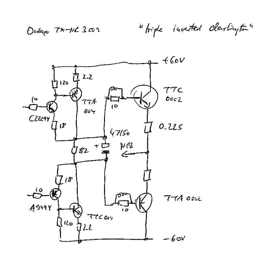

Sorry to be resurrecting a 10 year old thread. The pic for the quote can be found on the previous page.
There is something like this used in many higher end Onkyo amps and AVRs such as the TX-NR905 or the TX-NR3009 called the "three stage inverted darlington circuitry", see my atttached drawing.
This circuit has a conventional emitter follower output stage, but the predriver and the driver form a CFP with a gain of 1. The whole amp actually has NFB, but both the LTP and the VAS have resistive loads, so it is probably a low feedback amp. There is no miller compensation and no lead/lag. The dominant pole is achieved by loading the already resistively loaded VAS with a capacitor to ground.
There was also something which looks like an Onkyo engineer tried to explain on a public site:NON-NFB AMPLIFIER
There is only a partial sketch of the output stage. The NPN predriver is followed by a PNP darlington, so driver and output transistor operate common collector. The whole amp was non-NFB.
This second circuit places the output transistor in a local feedback loop, which the first circuit does not do. However, overall it will probably be slower because the output transistor is used common collector.
