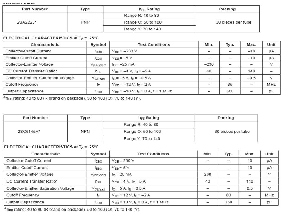

"It seems the output transistors are 2SC6145, and (highly) probably 2SA2223"
If the on-line Sanken datasheets are accurate, this NPN - PNP complementary pair are not very well matched.
Sanken 2SA2223 PNP fT=35Mhz, Cob=500pF
Sanken 2SC6145 NPN fT=60Mhz, Cob=250pF

No Bjts are really, the same matching diversity is found from onsemi pairs and for that matter from all manufacturers. This not only applies to output transistors but also small signal transistors.
