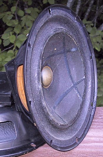

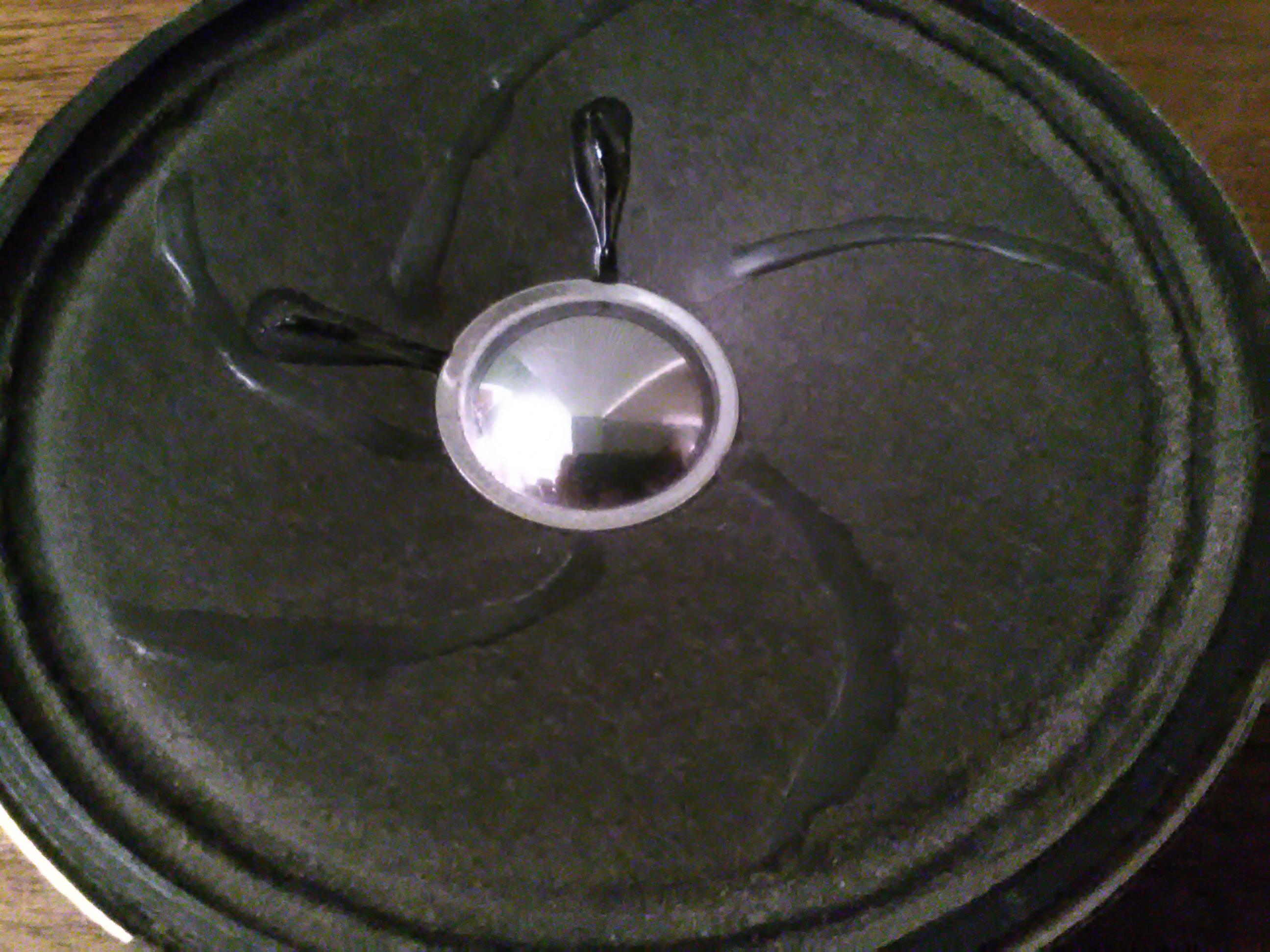

Perhaps it's not just the material used for the coating, but also the " pattern " - I did these " swirls " ( in PVA wood glue ) many years ago in an effort to dampen the ripples that go from the centre of the cone to the edge and reflected again. Unfortunately the rest of the hi fi wasn't good enough to reveal any noticeable improvement, but food for thought . Didn't the BBC ( or KEF ) coat the cones of the LS35a ?

The higher end Scanspeak drivers use a grooved pattern along the cone surface and fill it with a dampening substance, which i think is pretty smart.
There are some drivers that use progressive thickness cones, some of which taper towards the outside diameter. This type of cone often responds negatively to uncontrolled hand application of dampening materials, mainly because you're potentially adding much more mass on the outside diameter of the cone compared to the center, which ruins the driver upper FR. This type of cone does however respond very well to dampening the cone edge to surround interface induced breakup and bell mode resonances, getting rid of most if not all the typical midrange response kink it causes in untreated form.
I'm a big proponent of weighing the amount of dampening substance before and after application to obtain consistent results between driver pairs and for the sake of repeating the results if they were favorable.
Regarding silicone compounds, they do work depending on the specific type used and not all are suited the same (or even similar) for speaker cone dampening. The Permatex flowable silicone works well for lighter weight cones and sealing cloth surrounds because it adds less mass than most PVA based compounds. It dries clear and is self leveling, plus the working time is a bit longer which is a plus when treating larger cones. It also won't warp paper cones like other thinner water based substances, plus you end up with a moisture resistant surface and its more environmentally stable in the long term. This is a big plus with urethane based foam surrounds.
PVA does work better with paper cone drivers because it has better thermo dynamic conversion properties (converting mechanical energy into heat). Thats why its used so much compared to other compounds, plus its also easier to apply and non toxic. Most dome tweeters and mids use PVA based surface treatments. Plastic and polymer cone materials usually do better with visco elastic (latex) based dampening compounds, mainly because these cone materials don't bond well with water based coatings in the long run. Most kevlar cones I've seen use latex coatings. Without them, these cone materials exhibit very harsh, high Q breakup modes simlar to metal cone drivers.

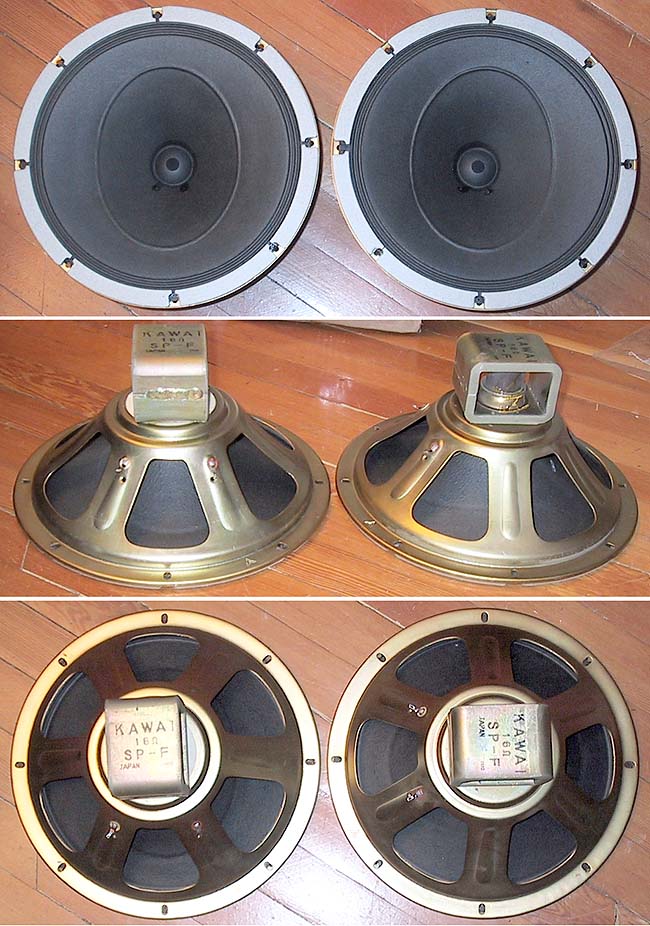

I recall a very vintage (1940s) 8-inch chassis that was particularly uncoloured compared with others of similar size. This one had a DC-energised electromagnet, run warm for plenty of field, and the paper cone was multiple corrugated, very fine pattern, radially and concentrically. Sounded beautiful on all sources, no shout, no honk, topped out with a little electrostatic tweeter. Intuition told me do nothing, and I put away the lacquer can.
