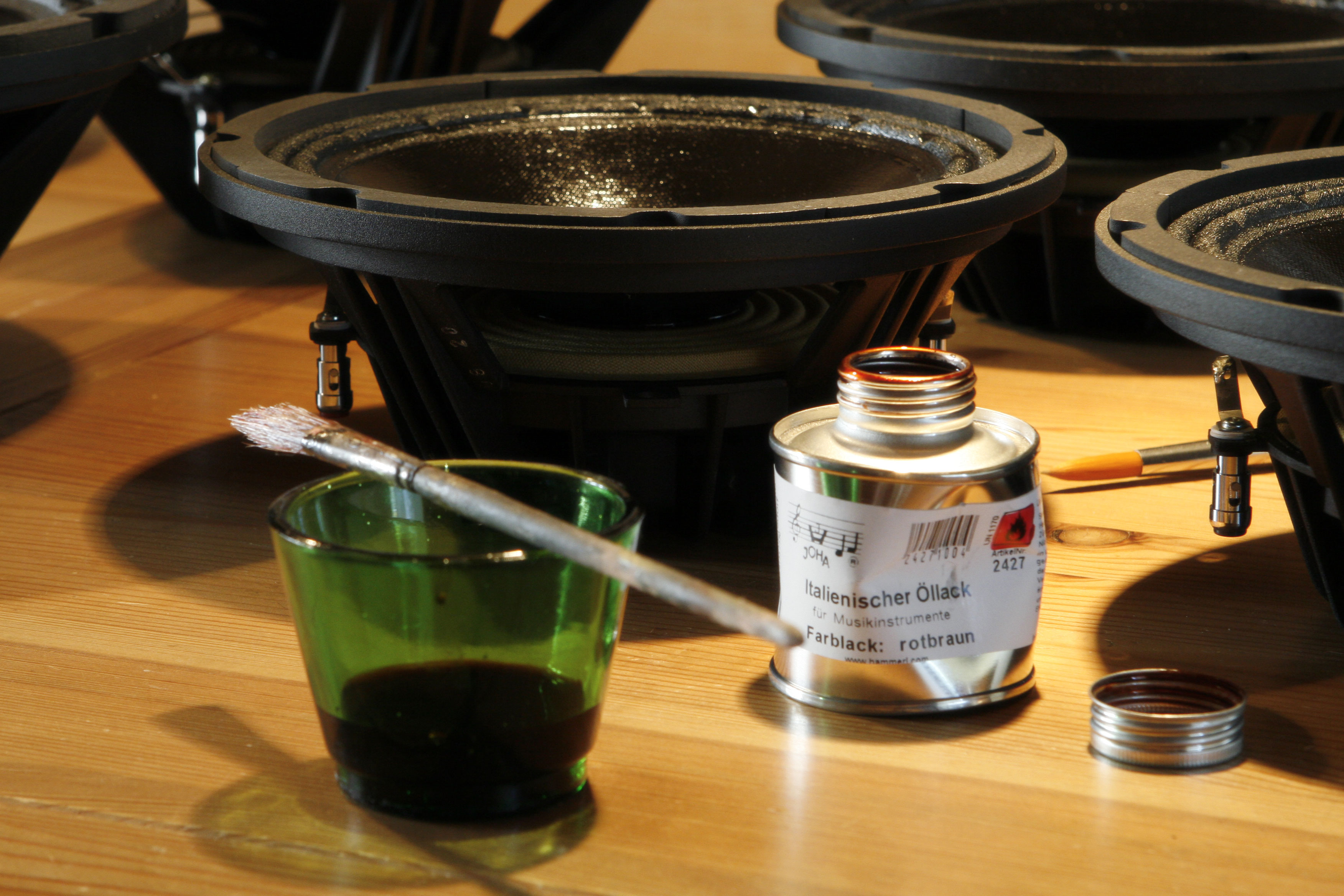

Trenner and Friedl make no secret of the fact that they coat some of their drivers with 6 layers of Italian balsamic oil varnish. The brand is even shown on some their pictures.
Trenner & Friedl Lautsprecher
http://www.trenner-friedl.com/download/RA-coating1-HR.jpg
I'm busy trying it on one cheap paper driver (rft) I had lying about . I can offer an anecdote in that I find that after only 2 layers it appears to lower shout considerably. Hard to say if it other parameters deteriorate. It definitely sounds as if it lowers distortions...especially at louder volumes.

LTS-50 is nothing like dammar as it doesn't stiffen the cone. The coating is very elastic so the paper cone retains it's original flexibility.
I've tried it with a single coat (my preference) up to insane number of coats which still allows the cone to remain flexible. Not expensive and less than a packet of cigs. Long shelf life as the bottle I have is still good after 7 years.
It's like a condom for cones.... protection but allows flexibilty and enjoyment. If you want stiff, then use dammar.

I use permatex flowable silicone to coat cloth surrounds and sometimes cones and dust caps. It works very well to control surround reflections in paper cone drivers using rubber surrounds, getting rid of that common 1-2 kHz wiggle. Ive used water thinned mod podge too, but it doesnt dry as flexible. PVA works ok for certain applications but don't let it get exposed to moisture.

What's bad with Damer and shellacs on paper ? Is it not what all this thing is about ? Making a sandwich with hard exterior and softer paper core, aka sandwich cones ?
I notice the non drying coating is making the opposite with an external damping instead an internal like the best foam core material at Focal, Eton, SB Acoustics...
ModPodge is a PVA formulation.
