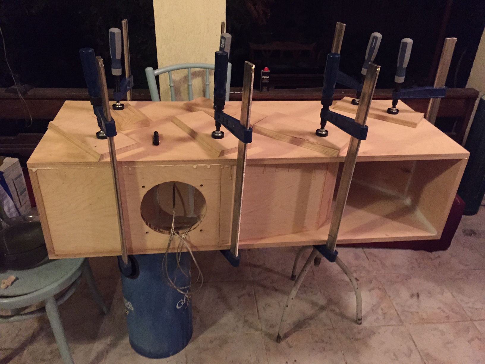

Hi guys, I'm half way through with my Dallas II project.
It's been like hell trying to put it all together. Cutting the parts is crazy, lots of freaky angles, and lots of stuff that can go wrong. After cutting all the parts I still need to correct some of them when gluing.
Anyway, I finished the exterior shell, and before I start putting the inside parts in I must decide for the cable route inside. Any ideas?

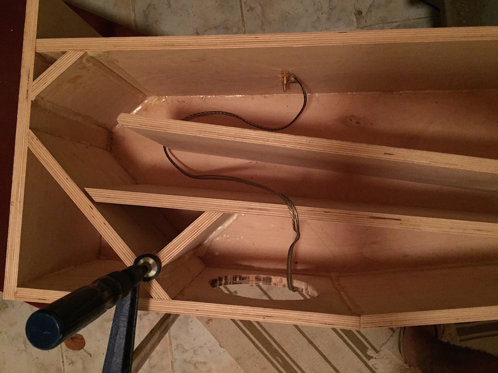

So I finally got off my *** and decided to finish this project. It's been in the basement way too long.
I am now thinking on the route of the cable. What would be the best way?
The large parts inside are not glued in yet.
I was thinking of going straight through them. Make a hole in each and then glue it back. This way the cable is as short as possible.
Would that affect sound? The fact that there's the wire suspended in the middle?
Or would it be better (and harder) to glue the cable down to the wood and route it?
I need to glue the large piece in the back of the speaker and I need to make a decision.
I still need to check the tolerance of each part before I put the final panel. I have some pieces that are 1-2 mm shorter. And I'm not sure if the glue will cover that.

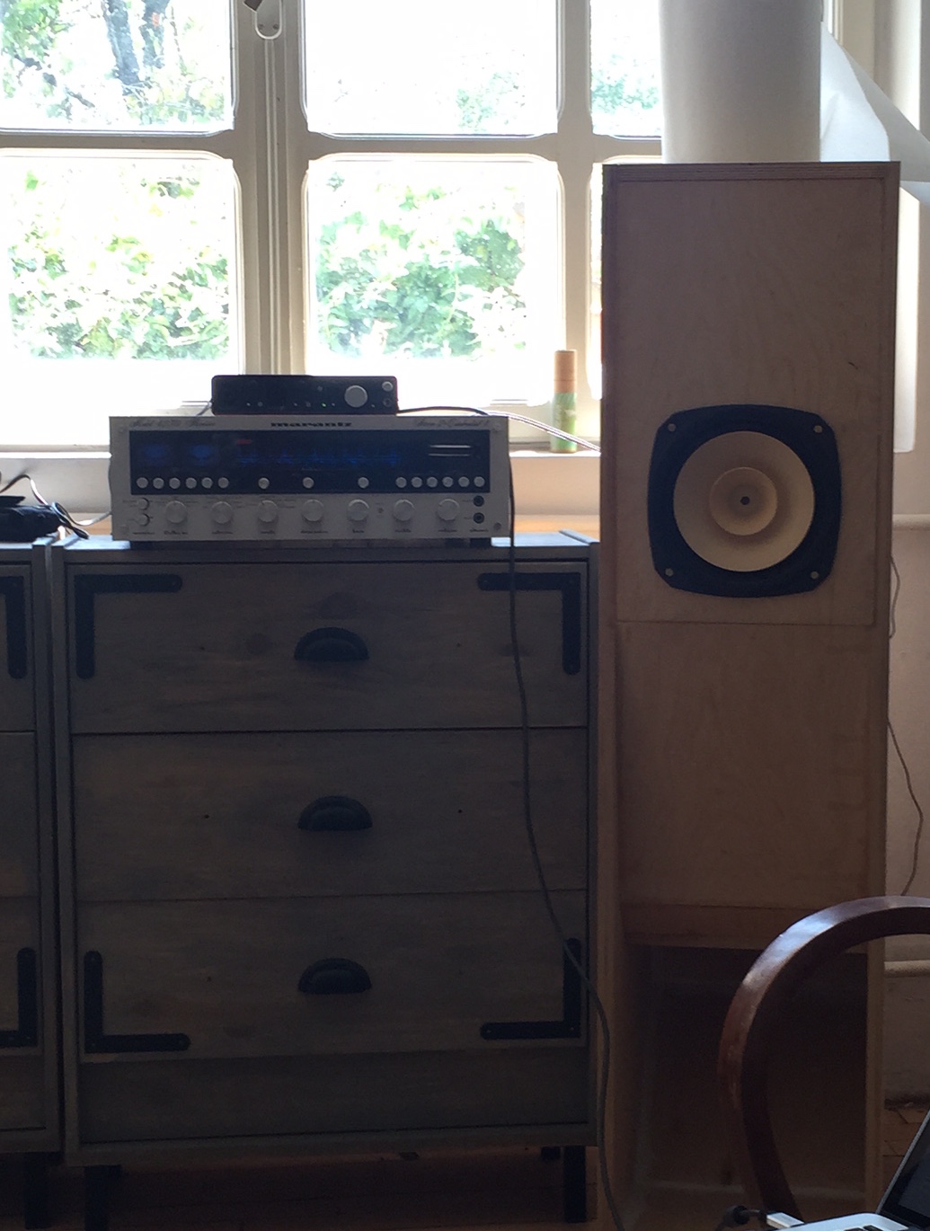

Finally, I've finished one!
I decided to run the cable straight through the inside parts, then I filled the holes with glue. This way the distance is short and cables don't vibrate on the wood.
I also used metal inserts for speakers, so I can take them off without damaging the screw holes.
I still need to finish the other one and paint them but so far I really like the sound.

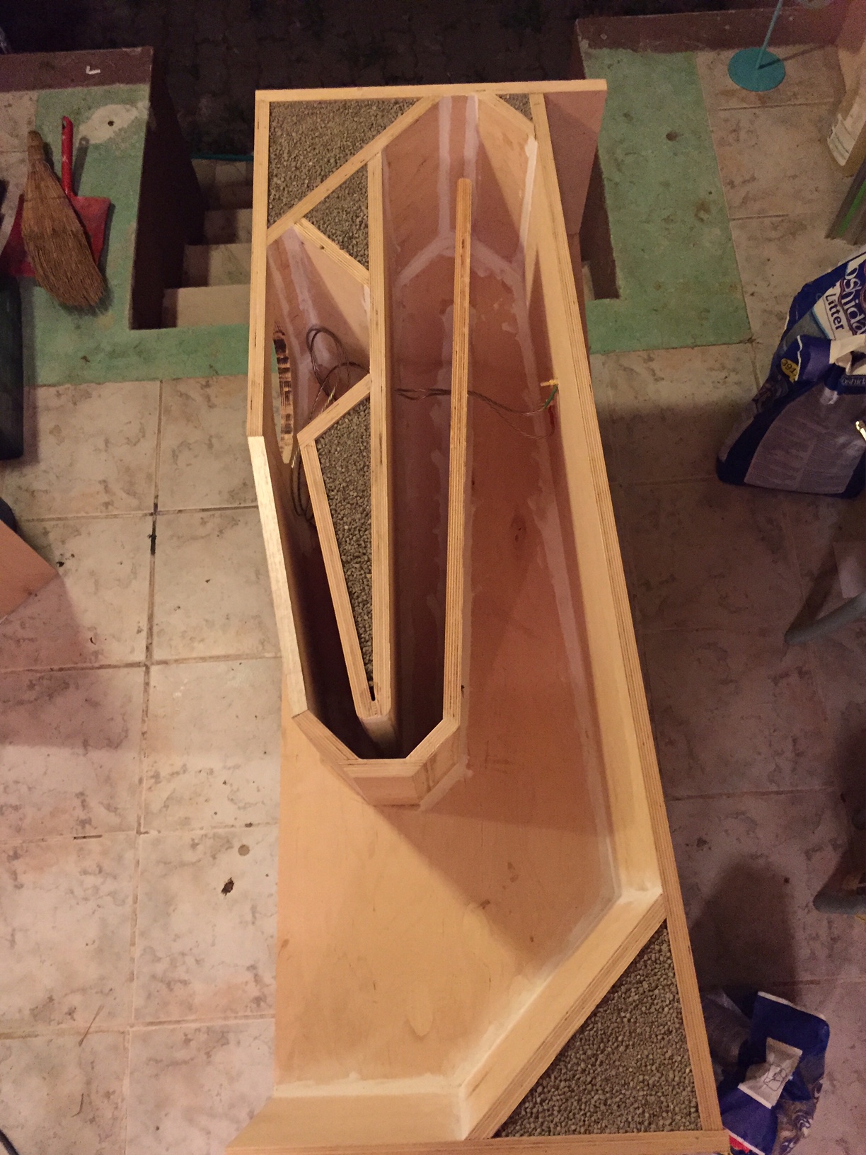

I used cat litter as filler. The speaker is heavy, I didn't expect it to be so heavy.
Trileru,
It's a big cabinet and also has cat litter in the voids... the FE206En is a not a lightweight driver - heavy with a good sized magnet... so your speaker should be heavy.
The build is looking nice, and good luck with the remaining cabinet!
