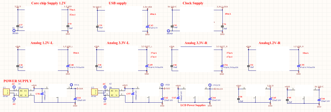

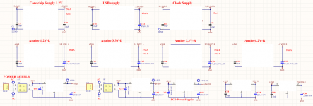

Have your tried to implement the ES9038 board with electrolytic capacitors in the power supply instead of Aluminium Polymer capacitors ?
I have an impressions that Aluminium Polymer capacitors are not best use for audio circuitry.
ok, and see schema for this cap!
thanks

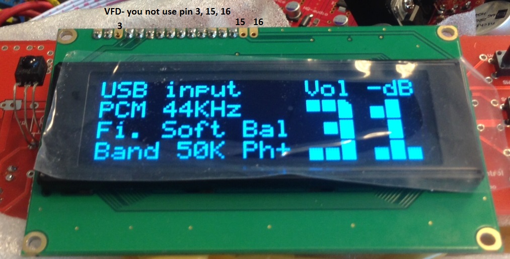

Controls and features
Controls and features:
1. Standby mode.
2. High volume display.
3. 20 x 4 LCD display.
4. Select the 4-way input and display the frequency on the LCD screen
5. Fuse protection - 220 VAC power supply / 5W
6.Turn on, off with remote control or buttons.
7. Simple and appropriate use for DAC chips: ES9038PRO, ES9028PRO.
8. Set up customizable protocols such as: volume, input as you like.
9. Select modes such as filter, frequency, left channel right.
10. Special and unique - Store settings according to your preferences:
A, Keep the big picture to the desired: lowest -100dB, largest 0dB.
B, Select and store left or right channel output - No need to reverse the output.
C, Selectable filter modes: (Pass band): 47kHz, 50kHz, 60kHz, 70kHz.
D, Option: PCM Filter Characteristics
E, Selectable filter modes: (Pass band): 47kHz, 50kHz, 60kHz, 70kHz.
F, Option: PCM Filter Characteristics: Fast, Slow Roll-Off, Apodizing, Hybrid, Brickwall.
@Quanghao
Can I bypass your AC input and feed directly 5VDC somewhere ?
thank you
Pepe
I think it's unnecessary, because the power supply is designed very carefully.
The lt3042 is great!
Therefore, you be careful, otherwise you will kill the DAC. I will not be responsible for doing this.
If you want to take a look at this picture!
Quanghao
