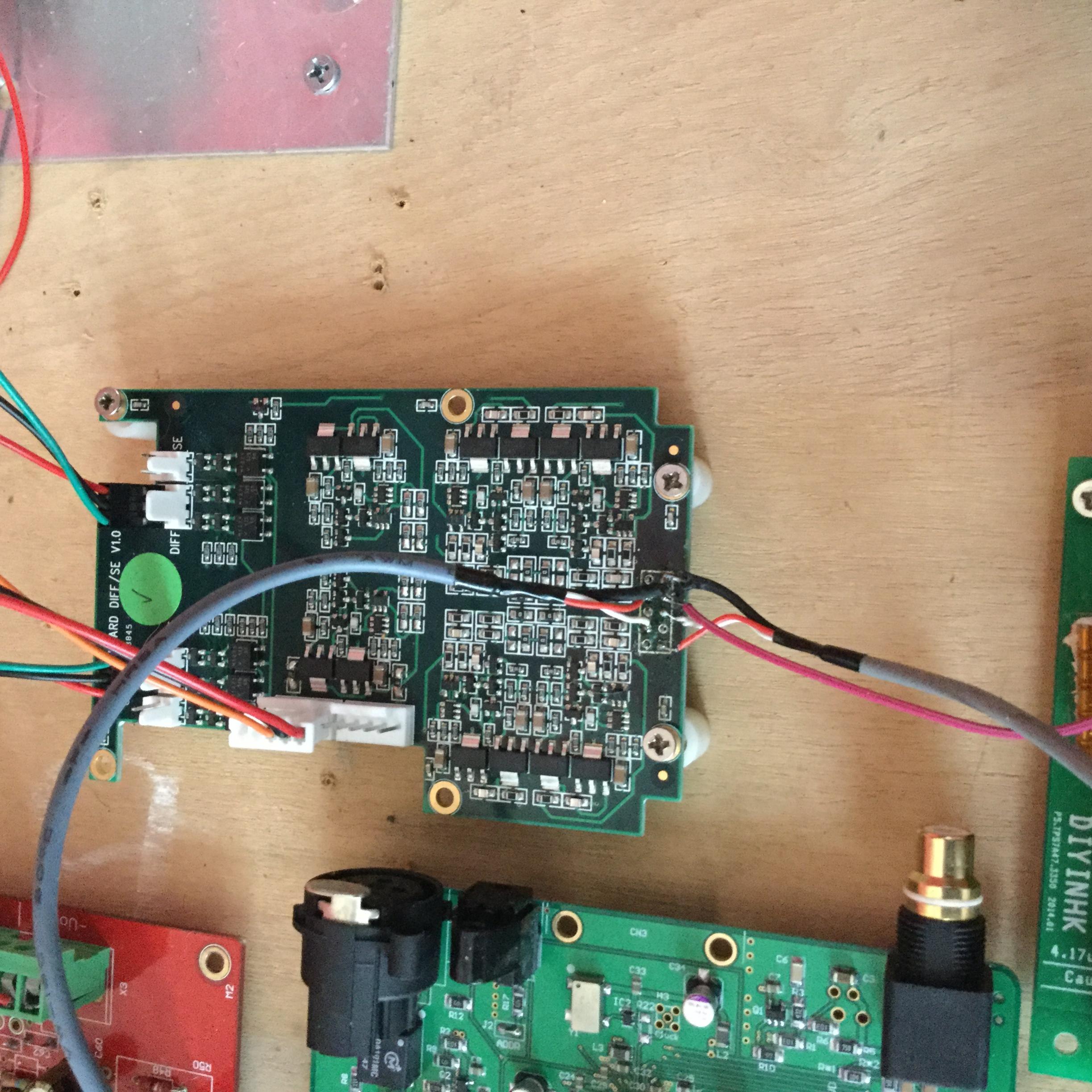

Here descrete out put .

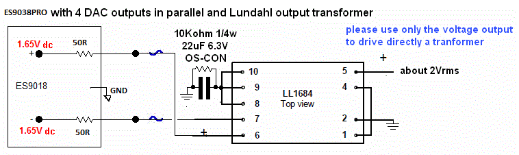

what design? and show me your connect to DAC ?? and link for this design ? (descrete out put )
Now you can test only DAC with no use iv output , simple test sound DAC.
You need use one cap 1 -220uF min 6.3V for test sound with your amli.
see schema
thanks
Now ok without descrete ,so I need to check IV out again .
Thanks quanghao.

using LL1684

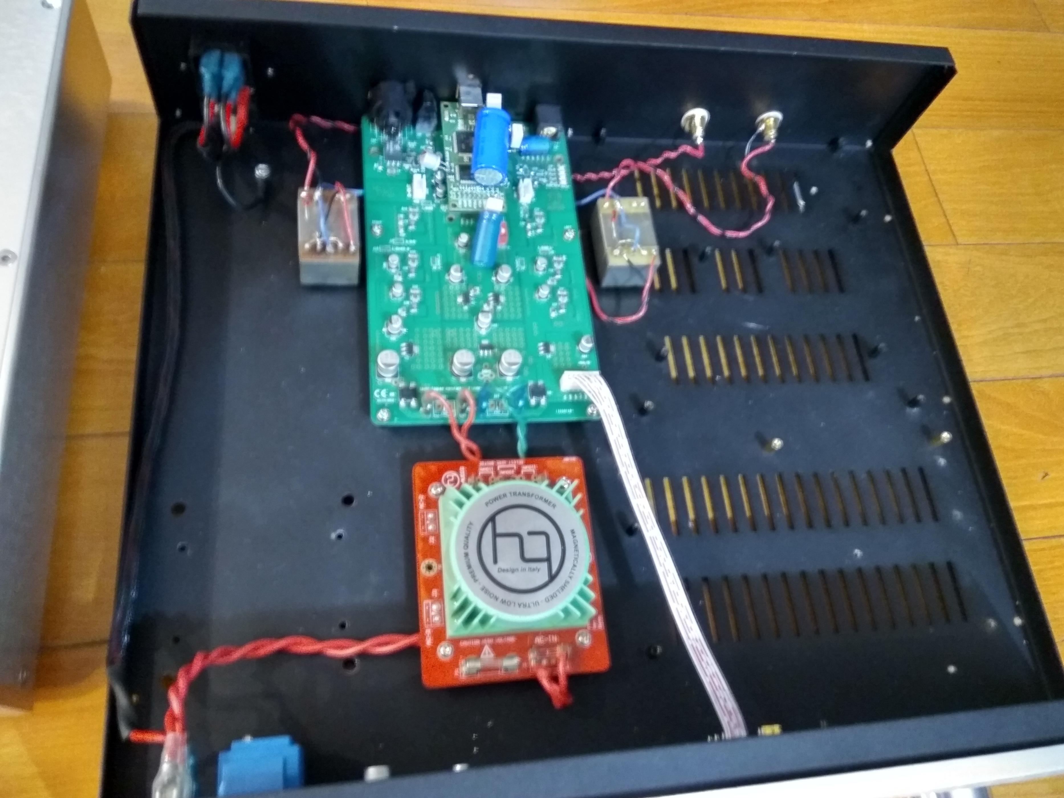

I solder the output transformer as described in message #183 by Quanhao without using his board. I use point to point connection approach. In fact I believe this will even sound better than using a board.
First get a copy of the LL1684 specs from Lundahl Transformers so that you know which connection is which number.
I first soldered connection wires (one for the +, one for -, one for the ground) from the output from the bottom of the ES9038 board. I then measure the required length of the wire by placing the output transformer next to the board.
I placed blutac on top of the transformer and connect it up side down so that the top of the transformer is now attached to the chassis through the blutac.
Then solder the resistors and the three wires to transformer. Then solder a twisted pair of wire from the output of the transformer to the RCA connector.
It took me about 3 hours to do this.
I hope this help.

Thank you Alan! This advice helps out tremendously. Would you happen to have a picture of how it looks?
