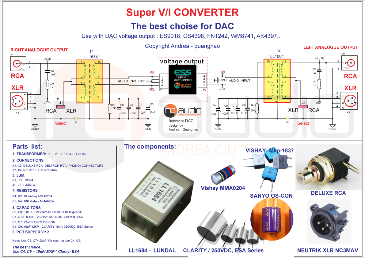

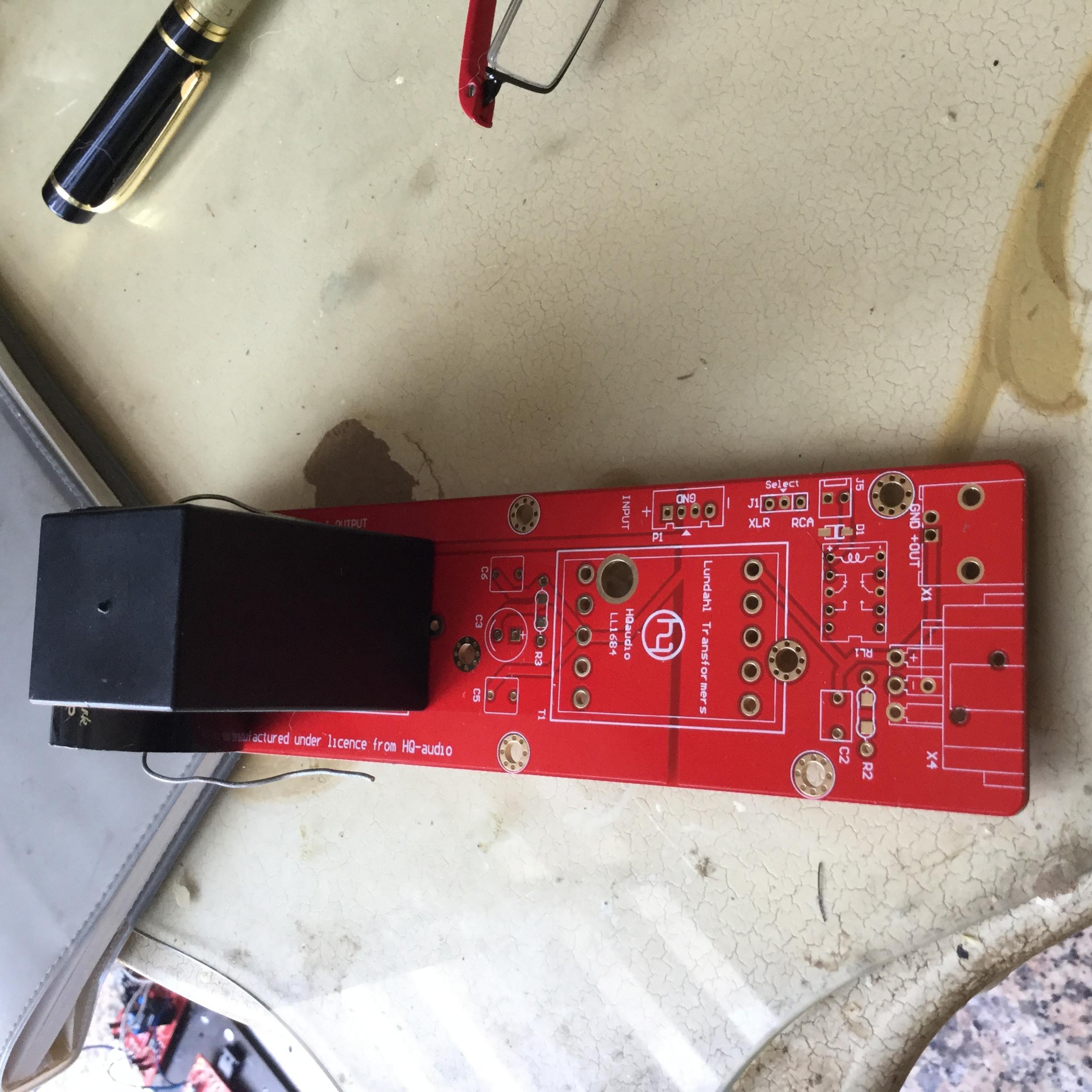

Quanghao
LL1684 is new design ?

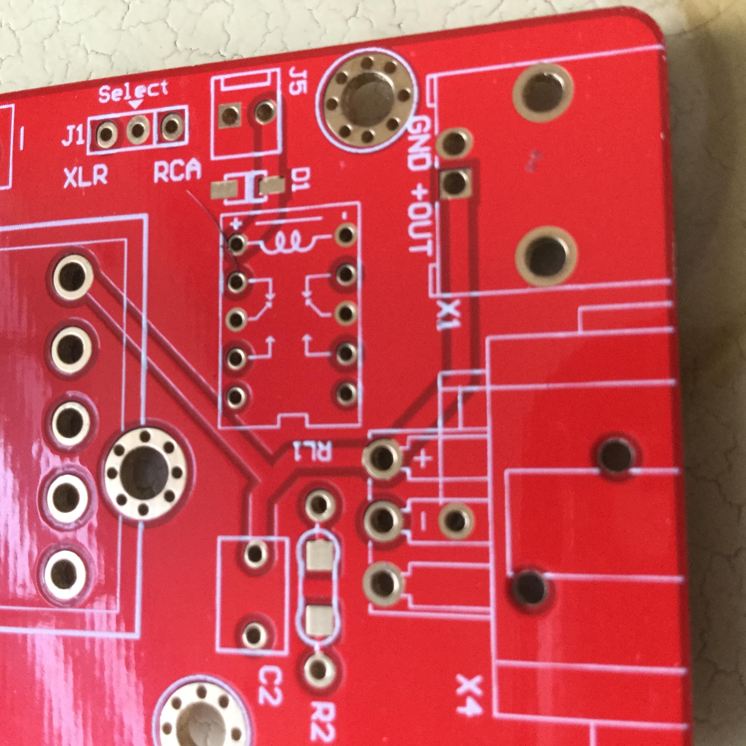

Let me know part list for RL & D1 .
Best
Myint
hi this more information: ES9018 USB DAC - Hi-Resolution System
and schema
Can the previous LL1684 board be installed in your new Chassis for the ES9038 ?
Usable, but you have to drill more holes to be fit, because the PCB is very small
thanks
Pls check for RL 1 &D1 ( no detail in ur link )
not use J5 and D1 and Relay. thanks

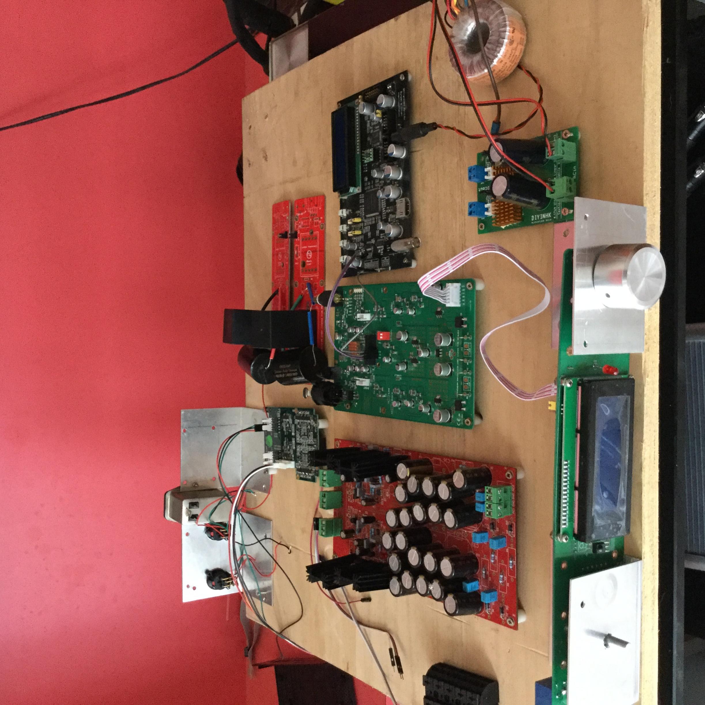

Cannot wait test 9038'dac with discrete output .
I2s input from SD transport
Please connect GND transport to GND dac.
Hi quanghao,
My I2s output is (data,DCLK , LRCk ,MCLK ) to dac Data ,CLk and MCLK .
So no need to use LRCK right ?
Input is set to USB .
If everything correct ready to start .
Best
Data, LRCK and DCLK always must be conected. Also, don´t forget connect GND.
MCLK, for this dac, is not neccesary.

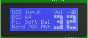

hi!
the DAC LCD it is Lock or No lock ??
check the setup off amanero for usb ??
thanks
Hi Quanghao,
You didn't answer on my emails. Why?
I received board 9038. Following information from post 23:
("Will this new ES9038 board fit the existing ES9018 board like plug and play ?
hi!
thanks
I returned to old pcb and I haven't photo of LCD with new board but I remember that was No lock with info like: PCM -/0/-
I don't use Amanero at all and i tried setup with and without Amanero.
I'm going to return and check everything again on Saturday.
