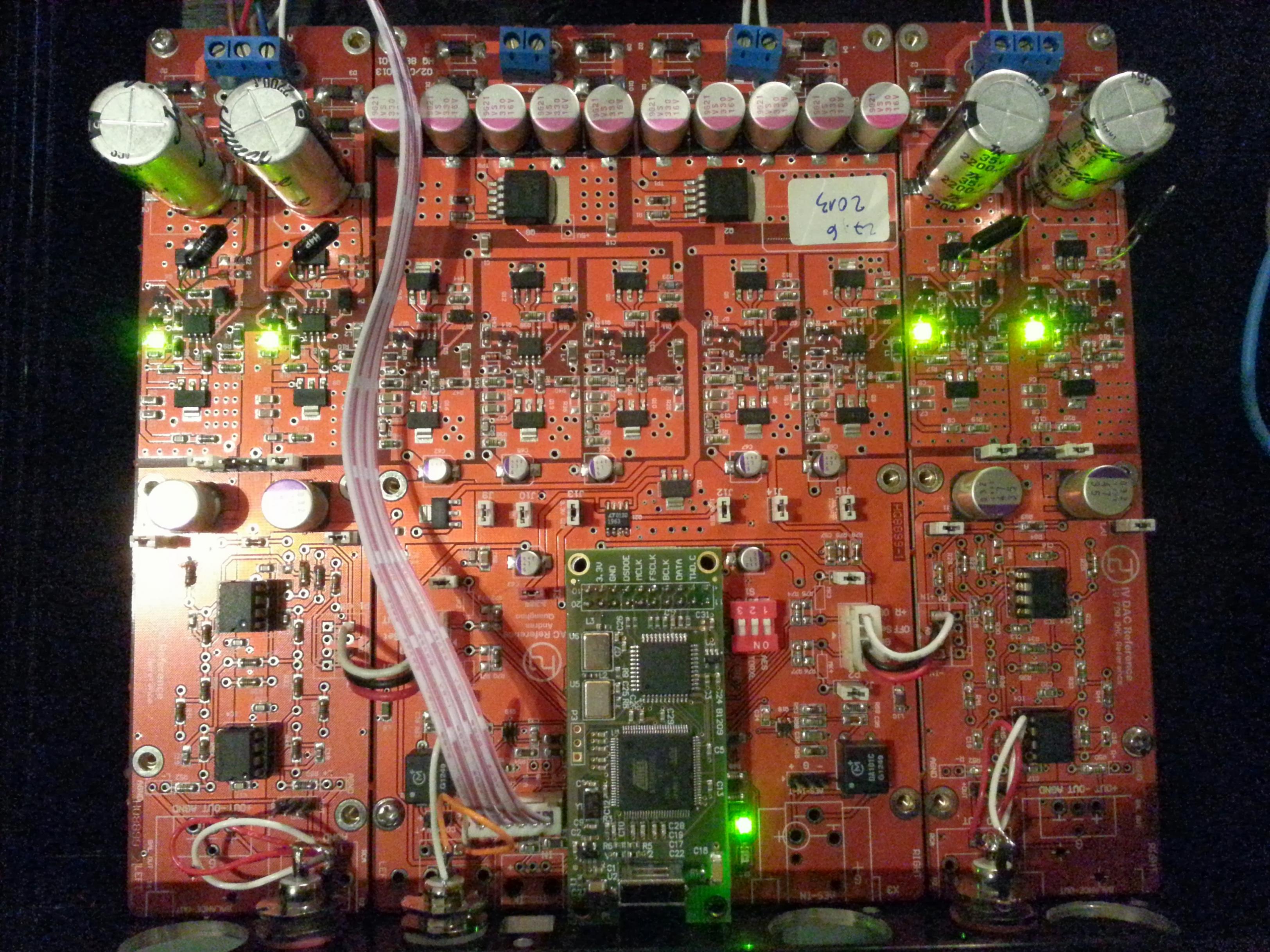

may be it, but i need image of your DAC, i can see it now ??

Hi Quanghao, here it is. not a very good photo but hopefully you can see what you need to see. I have uploaded the lastest firmware to Amanero but problem is still there.
Cheers Herbert

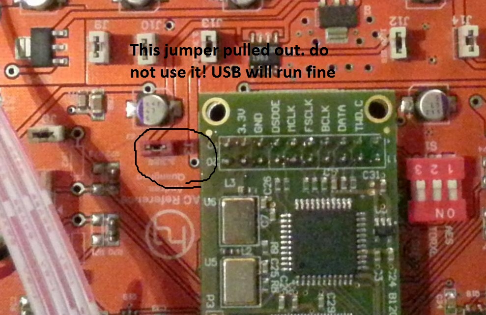

Hi bertchai!
may be you wrong,
I've seen you at the same time using two 3.3v power supply for usb.
3.3v power from the computer first
3.3v second power from the DAC. So now you do this picture:
This jumper pulled out. do not use it! USB will run fine
see image
HI Quanghao, I have a second Amanero with the 3.3 reg removed. Problem still there.
