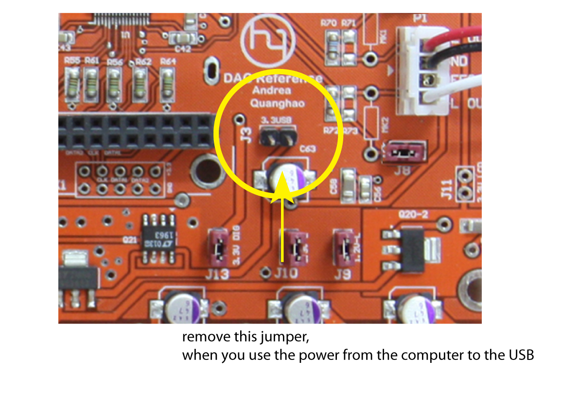

I'm experiencing a humming sound when using the USB Amanero input. The tweeters of my loudspeakers emit a hissing sound when the DAC is on mute. If I connect my amplifiers (Hypex Ncore) to a different source, all is dead quiet.
Could this be resolved with the solutions from post #1586?

PLESAE TAKE OUT THE JUM * UsB * in the PCB dac out!
thanks

problem: sound bad on usb input
solution: remove usb jump on DAC if you are using Amanero without remove the regulator

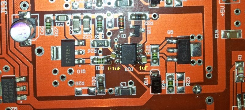

To help others find all relevant information and to make sure I understand all required mods correctly, I've compiled an overview below.
Could you please add a more detailed close-up for the shunt regulator mods? I think I understand Caad's picture, but it is quite difficult to see the exact connections. An additional picture of where to remove R9 and R10 resistors could be valuable for others as well, just to be sure.
Oscillation on shunt regulators (post #1586):
After receiving the final version of DAC modules we have detected a very little oscillations on shunt regulators in high frequency range (about 150KHz).
Measurements and simulations made with the collaboration of CAAD allowed to find a simple solution to this problem.
To make this modifications are not necessarily required SMD components but if you want to use SMD and you have problems to find these components you can ask to Quang Hào.
1) Remove R9 on op-amp modules (as suggested before)
2) Remove R10 on op-amp modules (as suggested before)
The following modification must only be made only on +1.2V , +3,3V and +15V shunt regulators.
3) Add 100n X7R as described on attached pic -->All are X7R (better dialectric compared to U5r , Z5R etc)
4) Add 1uF X7R as described on attached pic -->All are X7R (better dialectric compared to U5r , Z5R etc)
These modifications also will reduce the temperature on the shunt of the op-amp module.
Mods on OP2134 shunts (post #1626):
Please remove the power supply jumpers before applying these capacitors and check the voltage before reconnecting the jumpers.
Hum with Amanero USB input (post #1653):
Remove jumper if you use power from computer for USB connection to Amanero.
There are 2 capacitors to add for any positive shunt
the first cap 1uF is on pin 1-2 OPA2134
the second cap 0.1uF on pin 6-7 OPA2134
if you use SMD caps you can follow my photo
if you use normal caps follow the Caad photo
R9 and R10 resistors are only on OP-amp modules and these should be eliminate
