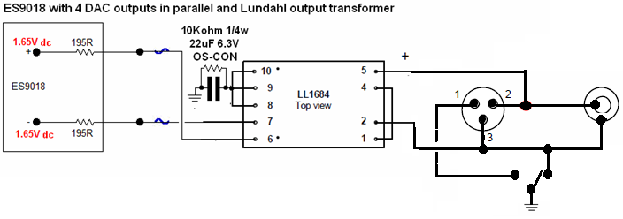

Hi Palmito,
I have the LL1684 hooked up like in this schematic.
Attention: the pin layout is from the bottom view (where you can see the pins), not like in the LL1684 pdf where it is the component view (where you see the label).
Danny
Hello,
I want to keep the possibilty to switch output between balanced and unbalanced. Can i use this schema ?
Br
Jacky
Hello,
Br
Jacky
Doesn't look good to me,
pin 1 on XLR should be connected to 1-4 bridge on LL1684
Pin 1 on XLR connects directly to chassis - always.
Pin 2 = + hot transformer
Pin 3 = - cold transformer
Let the secondary of transformer 'float'.
