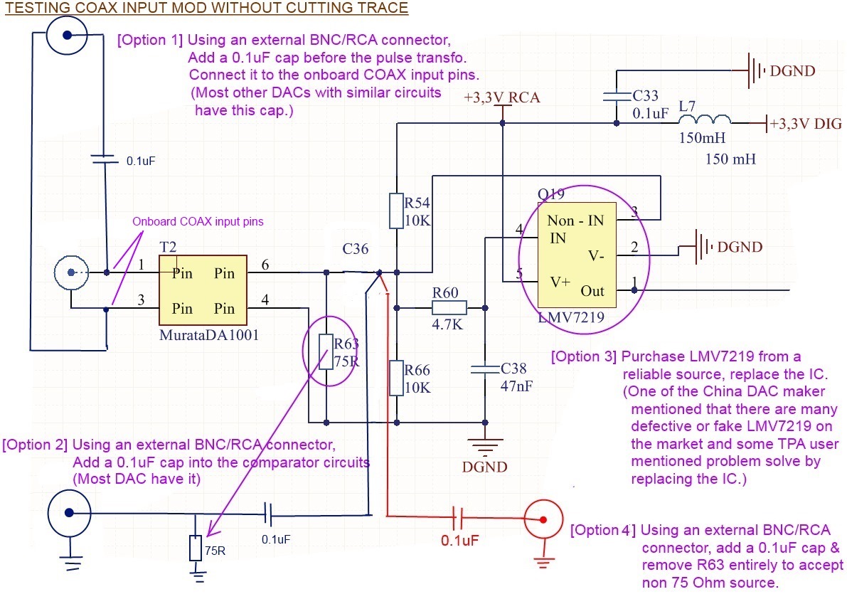

Does anyone know if there is a confirmed working fix for the SP/DIF input not working with higher sampling rates yet? I've seen a number of posts on this topic, but I've not sure if this problem has actually been resolved yet or not.
The COAX input circuits largely follows ESS official implementation so in theory it should works. I believe TPA has a similar implementation too. Compared to others, Quanghao has removed a 0.1uF cap before the input of the pulse transfo and a 0.1uF cap in the comparator circuits (C36). I believe his goal is to minimize the usage of caps in signal path to increase sound fidelity.
I do not have SPDIF source to test but from the limited info I gathered, I may try the following non-destructive mods to test the COAX input before implement it on the board itself.

There is no problem to use the spdif with high sampling rates.
With all due respect: Are you serious?
Then is it supposed to be my imagination that anything higher than 48kHz never, ever locks on SP/DIF, and that 96kHz over Toslink is just barely stable (cuts-out occasionally), and that 192kHz over Toslink is unusable?
I don't know why this problem is occurring here, but I can absolutely verify that all of these signals (which I am sending from my Oppo, via the same exact cables) are being decoded without any issues on a Teac DAC I have. But when I send these exact same signal to this unit, it simply fails to lock at all.
So I appreciate it when other people on the forum are trying to design a fix to a very serious issue which you guys seem to be in complete denial about.

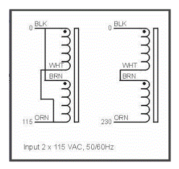

If I want to rewire mine to work on 110V, I guess I use only one set of the 110V primaries (red/yellow or blue/brown)? I have asked QuangHo for wiring diagram but have not received any response.
Hi NicMac,
Those R-30 transformers can be configured for 115vac or 230vac, they have dual primaries of 115vac, connected in series is for 230 vac.
I've connected the yellow-blue wire together for 230vac, the red and brown goes to the socket, see pictures.
Danny

Are you using the DAC module inside a metal chassie ?
Have you got the DAC shield by Qhanghao ?
Are you using the filter on main power ?
Have you tested the spdif output with other DAC ?
Also I would like to know if other person have problem with spdif.
