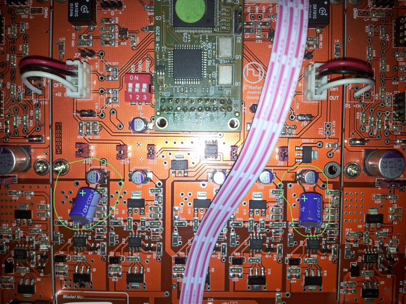

DAC module - correction
Add a 47uF or 100uF capacitor in parallel to the original 47uF on the 1.2V analog (L & R) to eliminate the little oscillation at 14KHz.

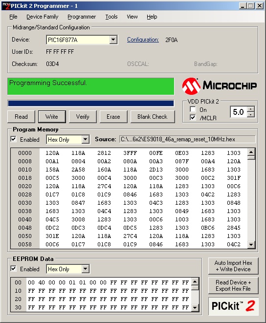

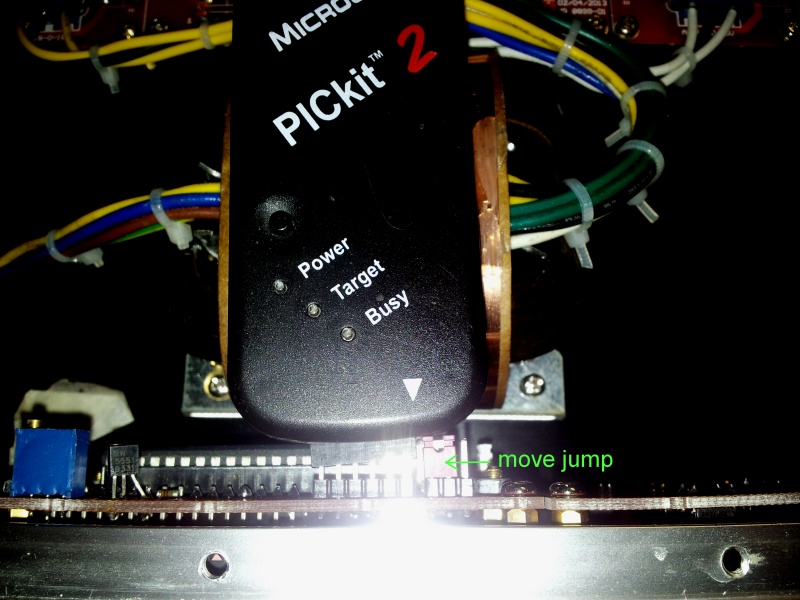

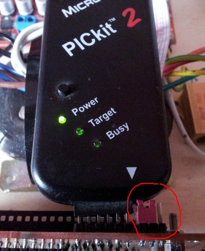

Firmware upgrade with Pickit2
Move both the 2 jumps in the second position.
You can do this operation with the DAC switched on.
After flash disconnect the Pickit 2 and move the jumps in the original position.

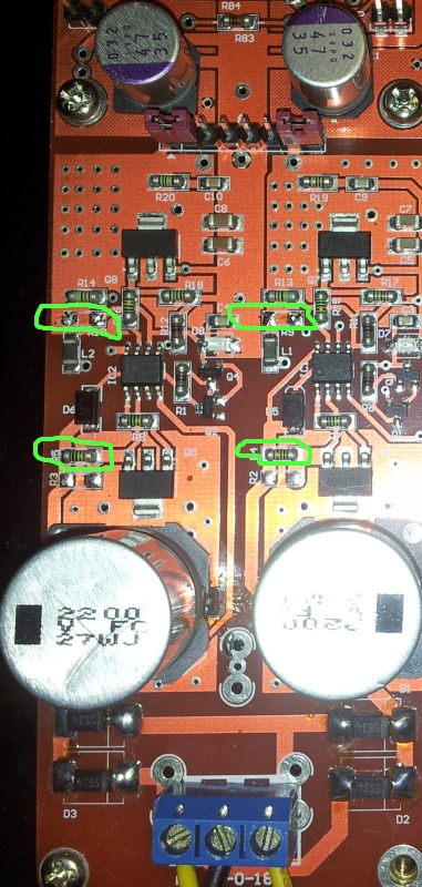

Op-amp module corrections
1) It is necessary reduce the current on shunt changing R4 and R5 from 10 ohm to 15 ohm because now the temperature of the second smd transistor is very high. Quanghao can send you the 4 x 15ohm smd resistors to make this simple correction.
2) Eliminate also R9 and R10 in the +15V and -15V shunt.

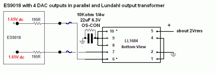

Hi Palmito,
I have the LL1684 hooked up like in this schematic.
Attention: the pin layout is from the bottom view (where you can see the pins), not like in the LL1684 pdf where it is the component view (where you see the label).
