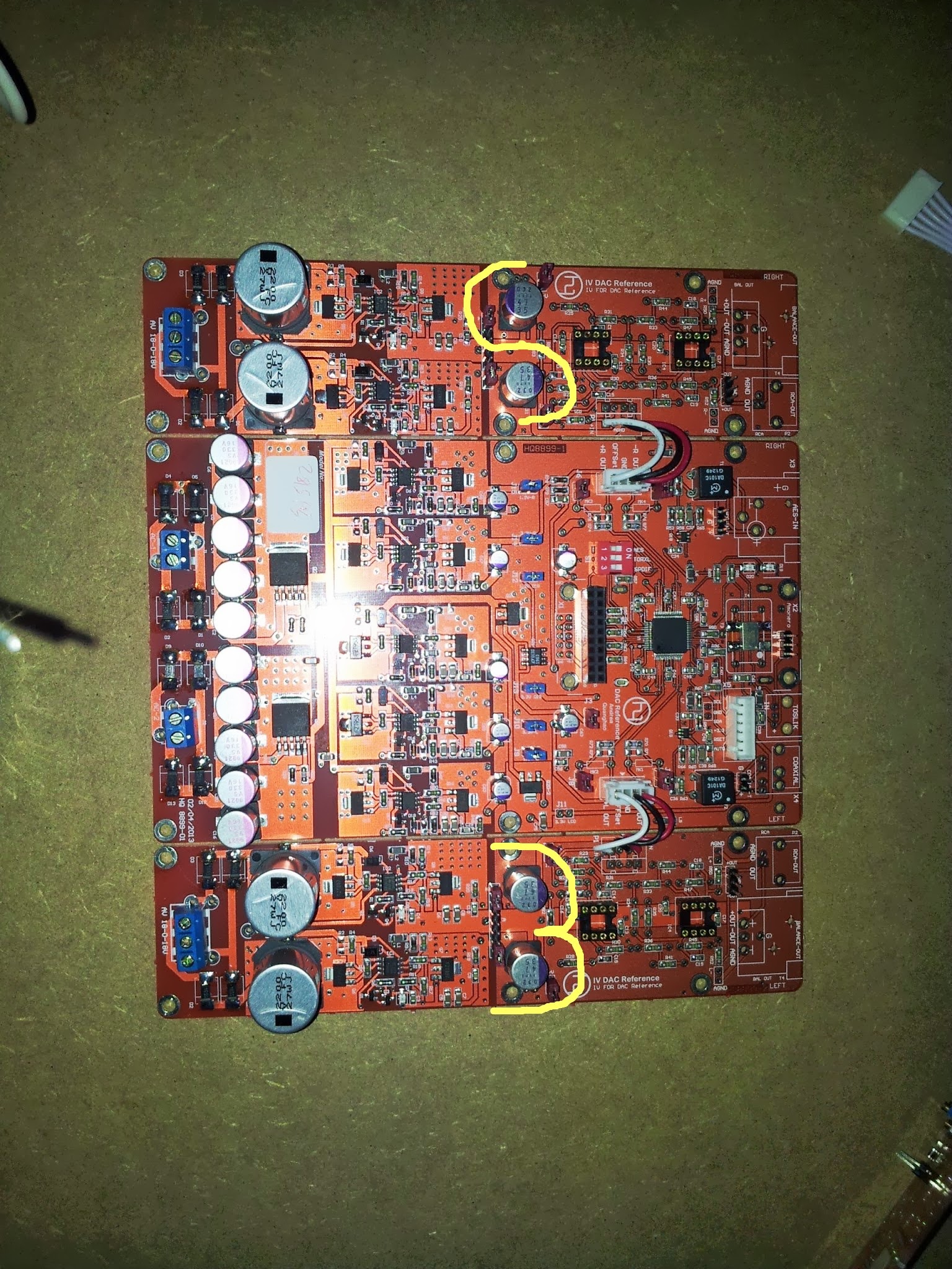

Is the orientation of this capacitors of any concern? Are they electrolytics?
Yes, they are high quality Sanyo Oscons.
I think that the lower output stage has one cap wrong orientated.
It should be like the upper one in your picture.
The opamps have a dual power supply: +15 and -15,
the cap for +15 has the marked(-) terminal connected to ground(0v) and
the cap for -15 has the marked(-) terminal connected to -15v

It was my fault,
sorry you, I send you another one on Monday of next week, please send it to me by mail form.
Thank you!
quanghao
If this is directed at me...
Thank you but this is not necessary. I will fix it. Maybe you can send me some thru-hole replacement caps though or point me to an appropriate replacement part. I have never worked with SMD and I have not yet figured out how to remove these electrolytic SMD caps. So they might not survive the operation. I can't even see the leads.
