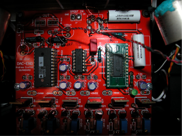

That might have some bearing. It looks like 6, 8, 12 on yours are 5v and mine are way off.. I'll swap in the other 74H now and check
OK I just put the other 74H in and I get the same reading as before. Can you please verify your readings on that chip?

ok. Then if you and someone else can verify this maybe its a source of the problem. The schematic doesn't show those pins going to board hook up. I'll look at the datasheet to see what they do.... I wonder where they are suppose to get that voltage?
I think the chances of both my 74H chips being bad is slim

I just checked the data sheet and 6,8, 12 are the data output so that could be very telling. I'm including the data sheet here.
So my question now is did I blow both of these chips? Or is something wrong on the board? This seems to be the issue if the voltage data out isn't working right.
There is one thing which I can't imagine can cause this issue. When I installed the chip holder I accidentally installed it backwards BUT when I put the chip in its installed in the right orientation. These are just straight pins to the board so I didn't think it would be an issue.

It appears 2,4,6,8,10,12 are all output and mine is only outputting correctly on 4, 10. So if the chip is getting 5v on the input pin 14 which I am getting then is all the rest internal? Or does it rely on getting those voltages from somewhere else?
I just did a continuity check on that chip holder and doesn't matter it was oriented wrong since I put the chip in the right way all the pins go to the proper places.

If I do have to order more of these chips is there any difference between these three versions aside from one seems faster? I've never blown one of these chips ever.

Yes as I said. The chip is in the right way but the notch in the holder is facing the wrong way. I never put the chip in backwards. The issue is the voltage outputs of that chip.

It seems you haven't installed all the 0.1uF de-couple cap, right?
