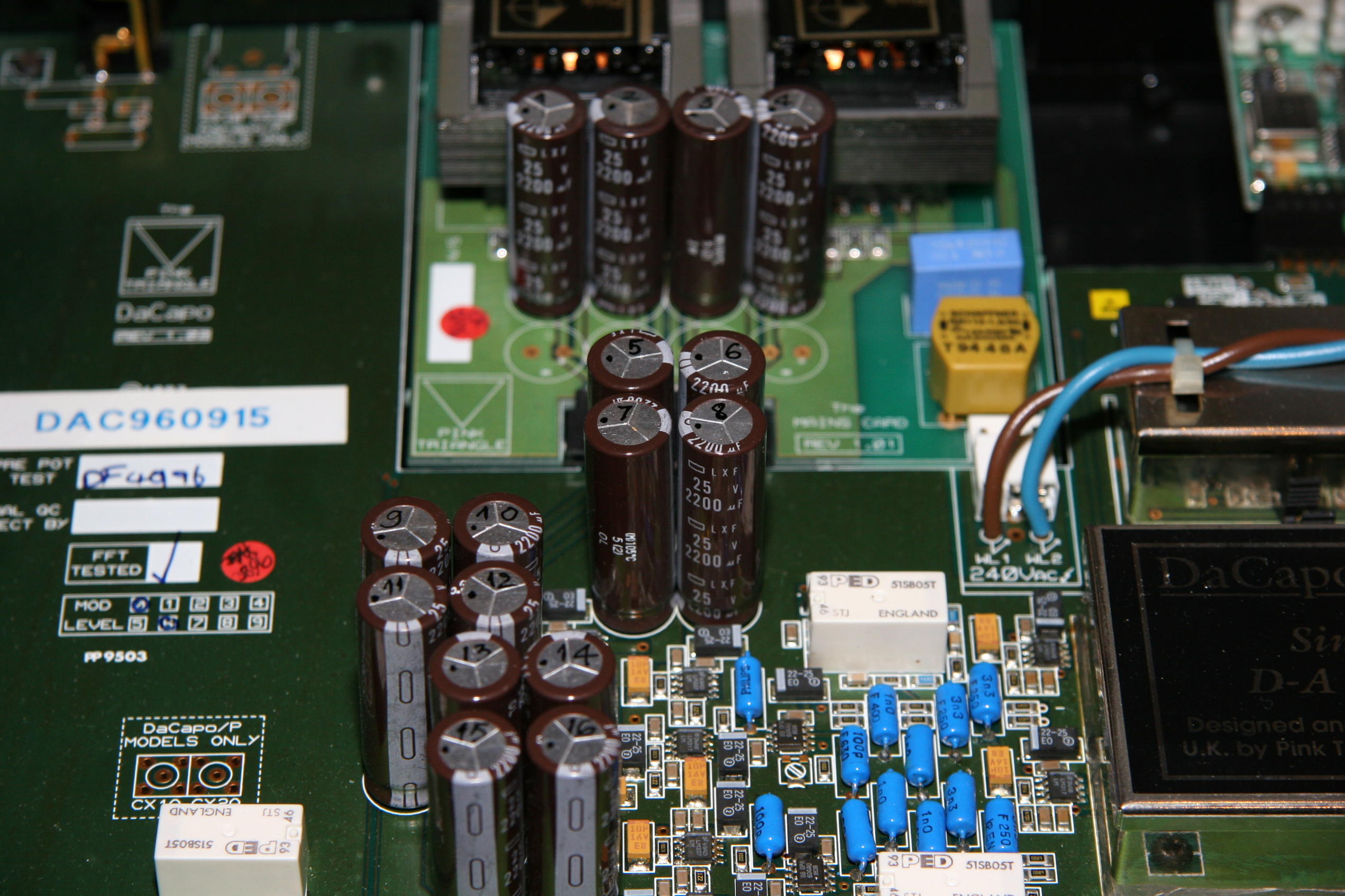

I collected a DaCapo this week to look into doing a capacitor change. The unit is making white noise on power up after a few hours detached from the mains.
I plugged the DaCapo direct into my amplifiers. At 3/4 of a volt for 150 Watts and DC coupled they are very sensitive and tend to reveal noise upstream.
And in this case that's exactly what happened. The DaCapo has a whine and some quiet broadband noise all the time. On first power up there was also the continuous white noise the DACs owner was hearing. These noises stopped completely as soon as I unplugged from the DaCapo the BNC carrying the SPDIF from my computer via the Edirol USB to SPDIF converter.
Could this be a fault with the DaCapo either not removing noise from the electrical lead from the 'pute or maybe having a problem sync'ing with the SPDIF. On re-plugging the BNC the white noise is gone but the whine and low level noise remain.
Also when it's warmed up after a few minutes music playing the DaCapo starts to give a hum to the speakers. BNC removal does not stop it. Only mains lead removal.
I un-plugged and re-plugged about 10 to 15 times both the BNC module board and the PSU module board in an attempt to clean the edge connectors. I think that made little or no difference.
Does any of this sound familiar / mean anything to you John that can be a pointer to the fault(s).

Russel,
All Dacapo PCB's I've seen have leaking Caps - so I suspect yours is as well - So you should change the Caps ASAP,
John
John,
There seem to be a large number of capacitors being fed off a very small SMD diode bridge. Does this circuit rely on the resistance of the transformer to limit the inrush current?. If I use low ESR caps will the bridge disappear in a puff of smoke or is it best to use standard types. BTW the bridge on the right hand side has been replaced by a W04 type rather than the SMD devices, is this for that reason and should I replace the bridge as well?. Oh and how far away are the new toys?. I have had the DaCapo for about 16 years and it still sounds great, nice design.

I'm just doing a capacitor change to a DaCapo and on this one, the two lids do lift off to reveal the components. No potting at all. Also, I lifted off the third can and the contents of that are revealed by lifting out the PCB. Again, no potting at all.
So I'm wondering if yours is the same as this and if so, why it's not repairable?
On this one the capacitors were just starting to leak and dissolve away the gold pads. I've fitted Rubycon ZL 2200 @ 25V. They happen to be exactly the same dimensions and lead spacing as the original capacitors.

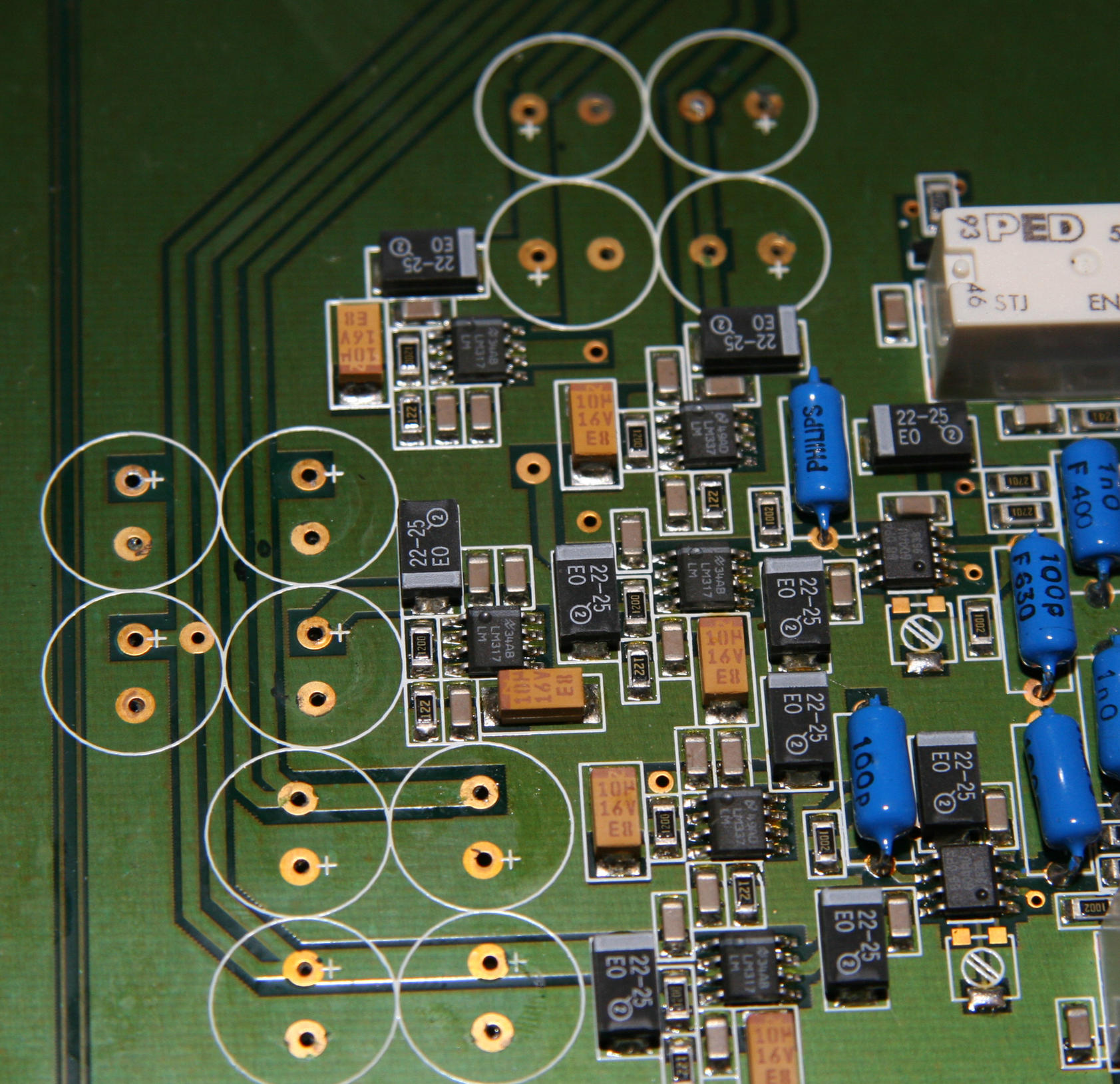

Here the photo of my Dacapo before removing the caps
I did take note on every cap for the purpose of placing them back to compare old Dacapo to the new DAC of John W

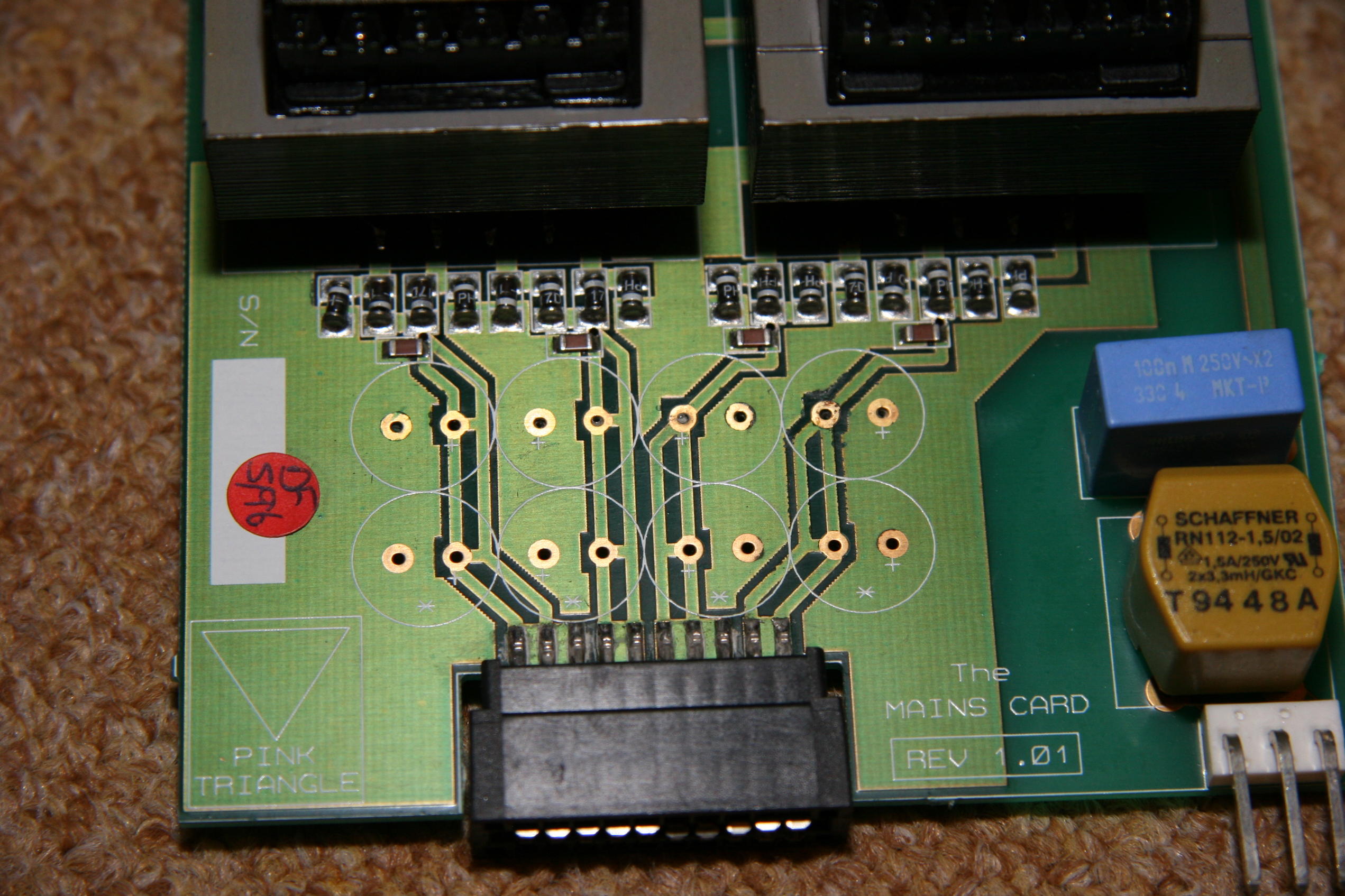

Some photos after the caps was removed
I can see 2 caps are going about to leak however there is no effect at all the the performance.
If you look back my threads, you will find out that I have been waiting for John W 's new DAC since 2007
Now I decided to remove the caps, The cap have been removed today
Hi John W
I could see you are online at this moment , I would be gratefull if you could give your advice about the caps for replacement
Have look at the PCB, it seems to me that the empty position is paralleled with the inserted positions. So Is it possible to solder the caps into the 'empty' positions to make it parallel ( in case I have to use the cap Nichicon 1000uF 25V)
